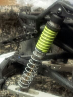

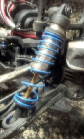

You just need to play with duel rate springs. My rear shocks (top spring) is from a short shock I had (bottom spring) is a stock Wraith spring, front shock is an old T-Maxx duel rate spring. I wanted a soft ride to absorb bumps & flex in rock gardens & @ the same time a stiff spring to keep the rig from bottoming out all the time.
IMO duel rate spring set-up is the way to go.
