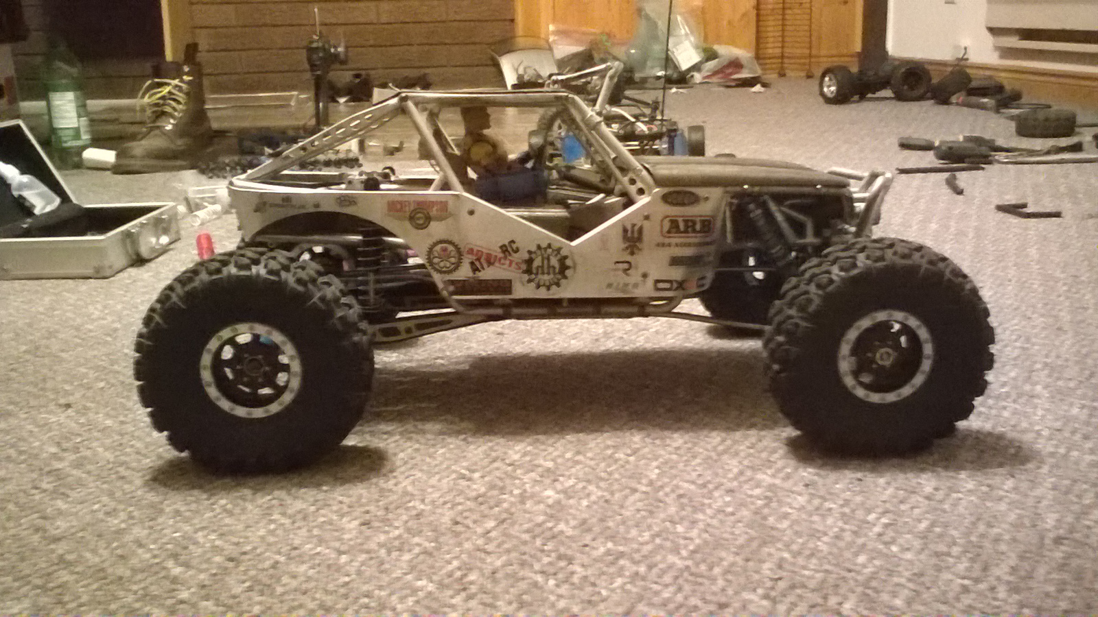

I just finished putting the yeti trailing arms from my kit version yeti on and I really like how it feels now.
Very nice. I love new options and retrofits! What rear uppers are everyone running?

I run TH trailing arms on my wraith, mounted on the last hole on the skid with custom double sheer mounts/sliders. It's worked out great
I'm running VP Twin Hammers arms on mine, also at the last skid mounting screw but instead of mounting it outside, I notched the skid to be able to put them between skid and frame rail. The stock plastic chassis didn't like the stresses of that setup but my new Dinky RC steel chassis doesn't complain a bit"thumbsup"

Thats a good idea. Never thought about notching the skid like that"thumbsup"
I tried the inside... Hit the chassis.

Yep, mine did too. I ended up clipping off the back section of the lower frame rail to make room. I added a vertical riser between upper and lower rail but the stock plastic just wasn't up to the task. The Dinky chassis I picked up has a better design that allows me to run this setup with free range of motion on the arms.
