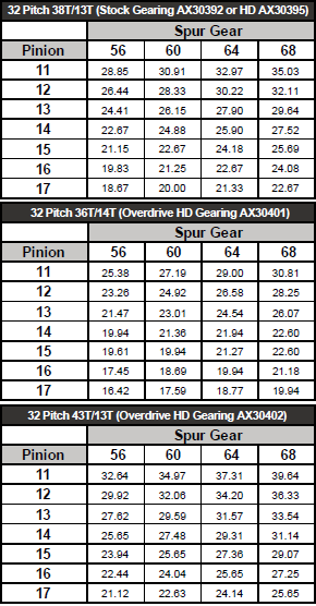

Gear Ratios
Stock Pinion and Spur: 16/64 = 4:1
"Inside" Transmission: 26/28 = 1.08:1
Transfer Case" 15/15/27 = 1.8:1
Overall Gear Ratio with different pinion and spur ratios
Transmission Gearing Comparison of Yeti to Wraith
Yeti Transmission w/o pinion and spur: 1.94:1
Wraith Transmission w/o pinion and spur: 2.6:1
Yeti Transmission with 16/64 gearing: 7.75:1
Wraith Transmission with 20/80 gearing: 10.4:1
Yeti Transmission with 12/64 gearing: 10.3:1

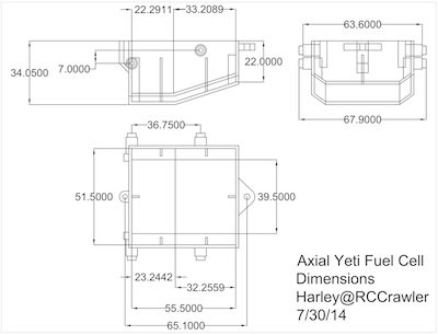

Fuel Cell
A larger version of this image can be found on Page 3 of this thread

Gear Ratios

Fuel Cell
