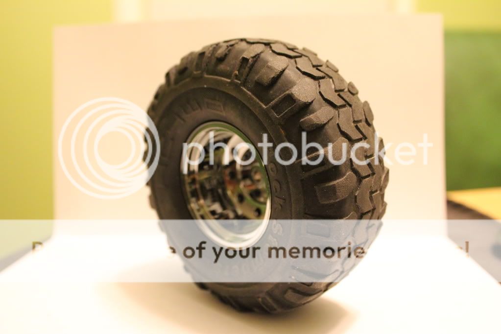

I've been running the RC4WD 1.55 wagon wheel rims for a while now and like them alot but they just don't have enough depth.... so I decided to hack up a set of semi wheels to get the depth I was looking for. Here's the finished product:
Start with a set of rear duals:
Take the one with the hex molded in and cut in two:
Trim off some of the inside lip to give the tire more flat area to seat on:
Gives ya a little more width too which is nice:
Almost identical outer diameter to the RC4WD ones:

Thanks. I ordered them from this site:
GardenTrucking: Products
King Hauler29
T0445258 Rear Rims Chrome Plastic (2)
...oh and don't forget the the three 2mm screws and nuts to attach the two rims together. Post up a picture here when you get them installed "thumbsup"

Their web site is confusing $9.41 for the set that I bought, the $42 price is for a different rim listed above the one I got.

Yeah did a little accelerated wear using a grinder to take some rubber off
