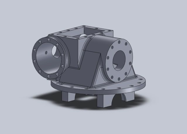

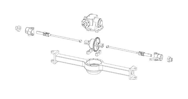

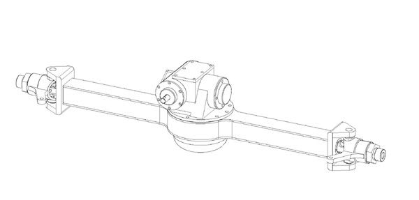

Well I have the 3rd member designed finally. Found the final gears I needed. Still needs some small details done but the majority of the work is finished. Just need to add some retaining clips and add link mounts to the axle housing. Then the search begins to find someone who will machine that 3rd member housing....
Final drive ratio came to 5.11. Everything turned out almost exactly 1/6th scale except that I couldn't get all the mounting studs for the 3rd to the housing and the access panel on top is slightly larger than the 1:1.
This thing will be BEEFY.

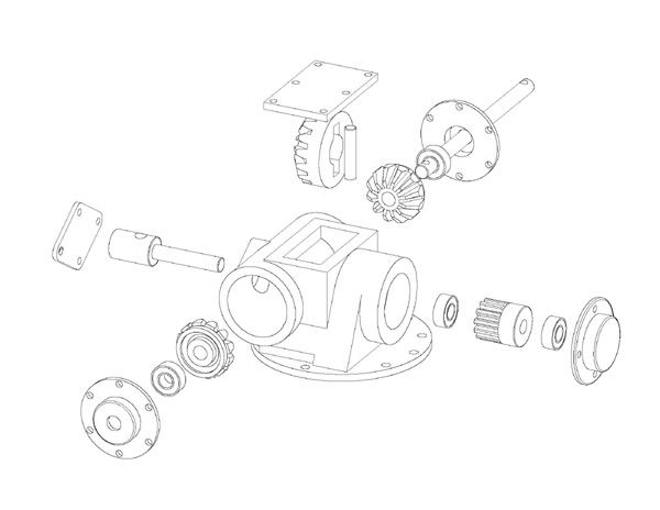

The exploded 3rd
