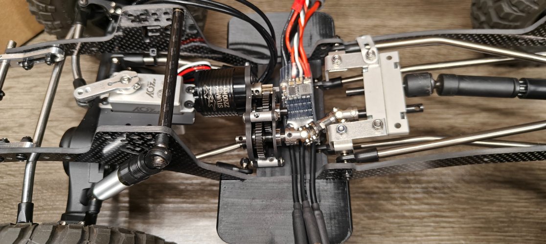

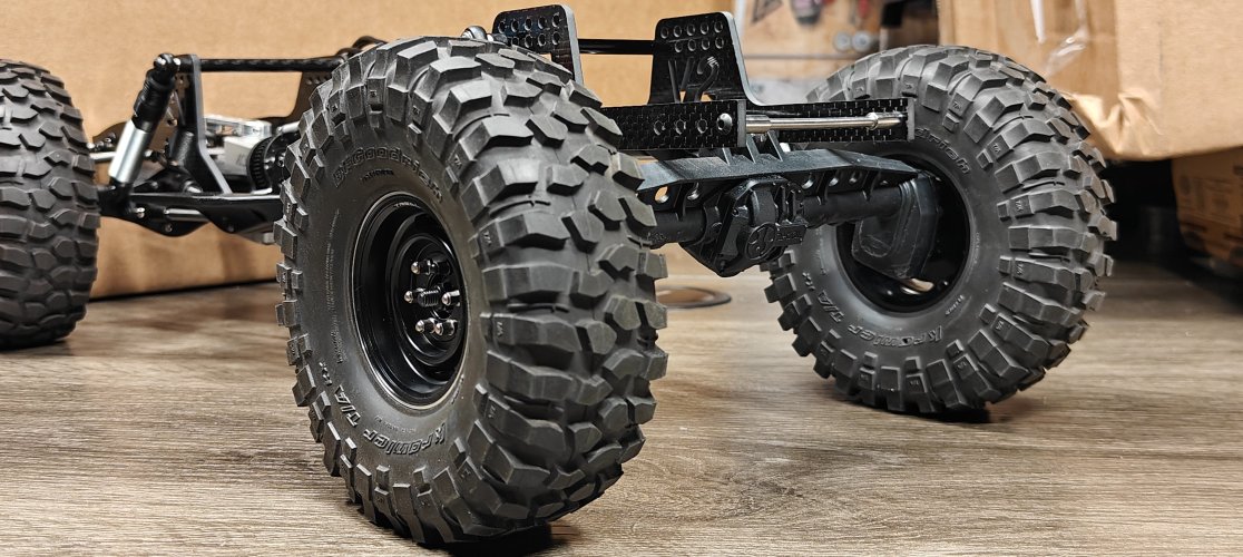

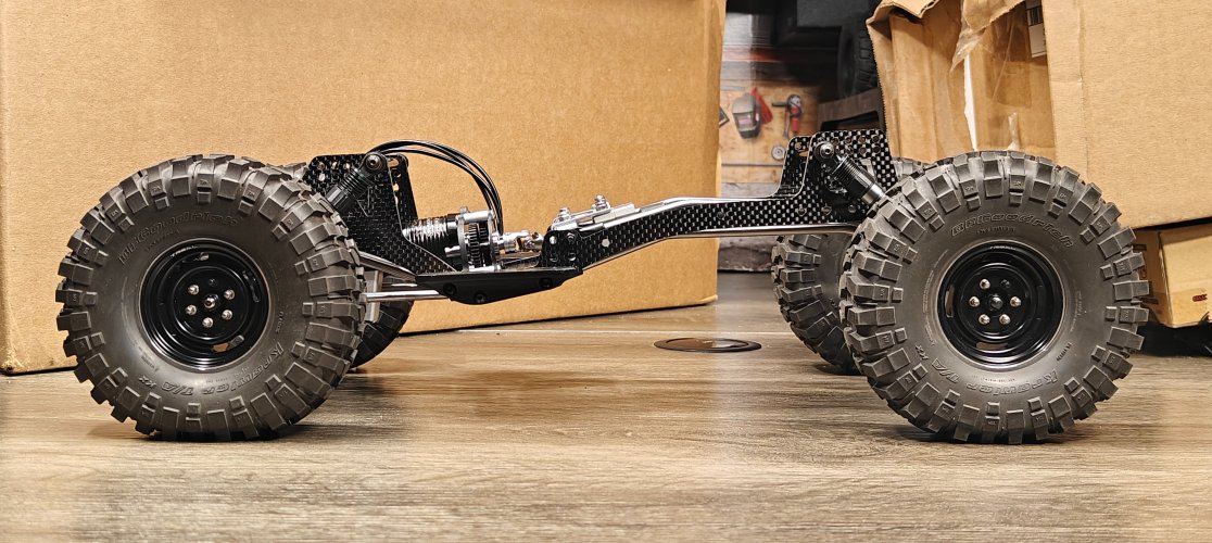

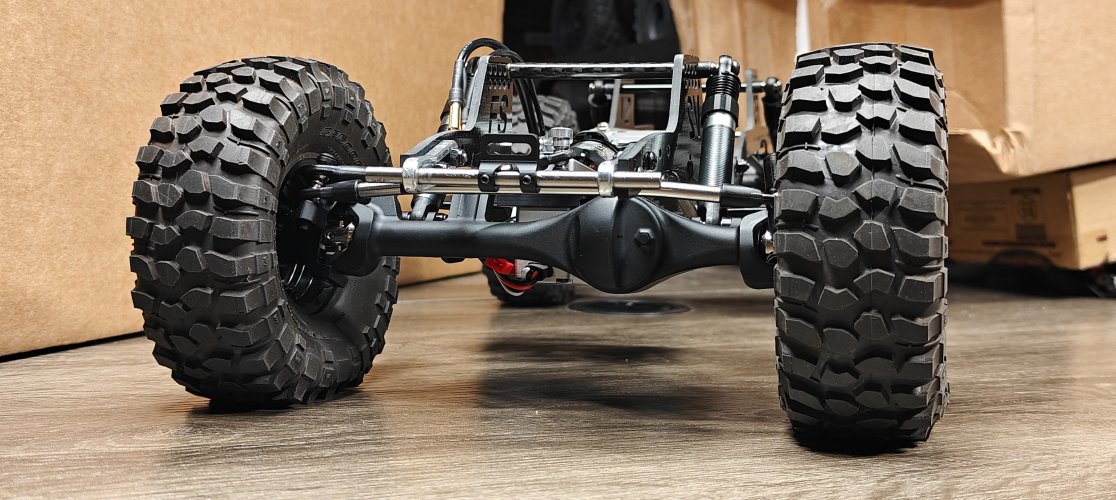

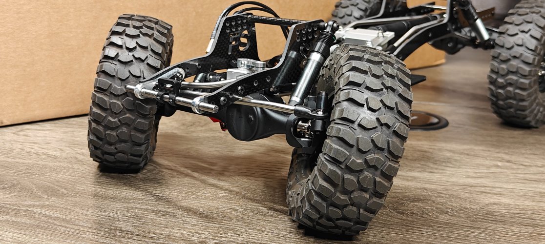

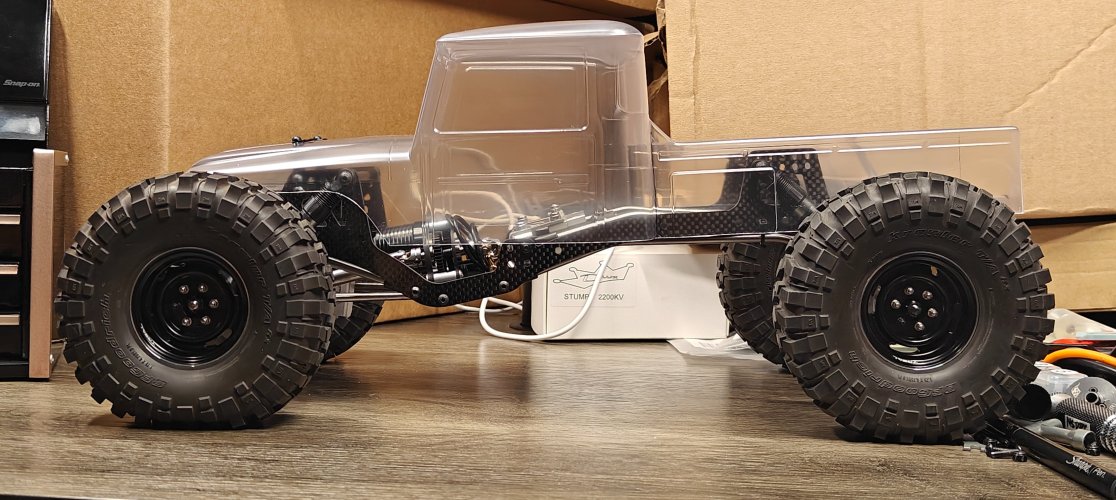

Rear axle pitched back for driveshaft clearance.

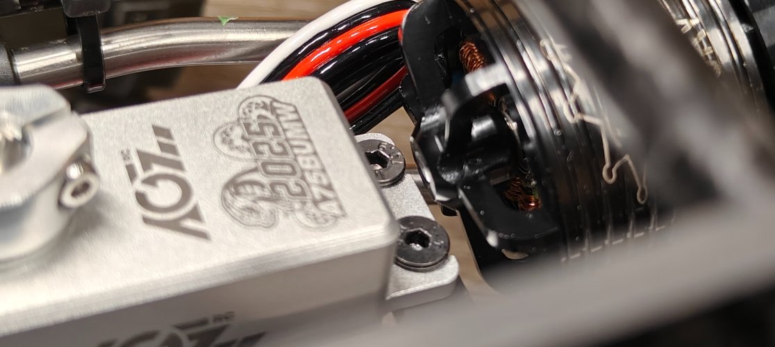

The transmission is mounted forward on the skid, with the motor just clearing the servo under full droop.

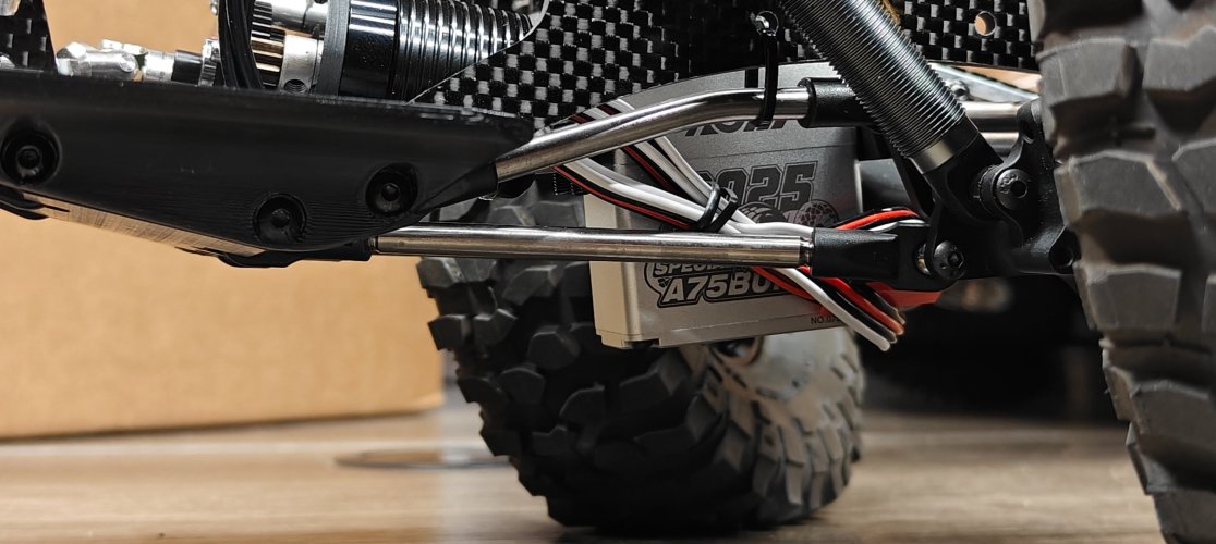

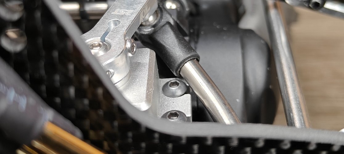

As stated above, this servo/horn isn't staying. But with it in place, I was able to install the further bent drag link and have the clearance for full lock during left turns.
Look how much the servo hangs down haha. Even with a low profile servo, it's still gonna be well exposed but it's ok. Just seeing a F10T style axle with a BTA mount comping is cool to me.

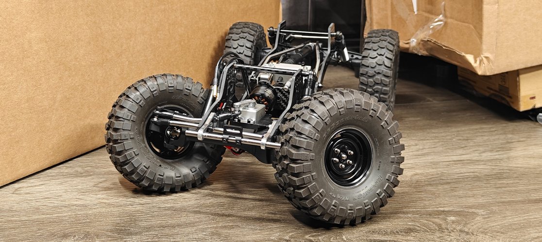

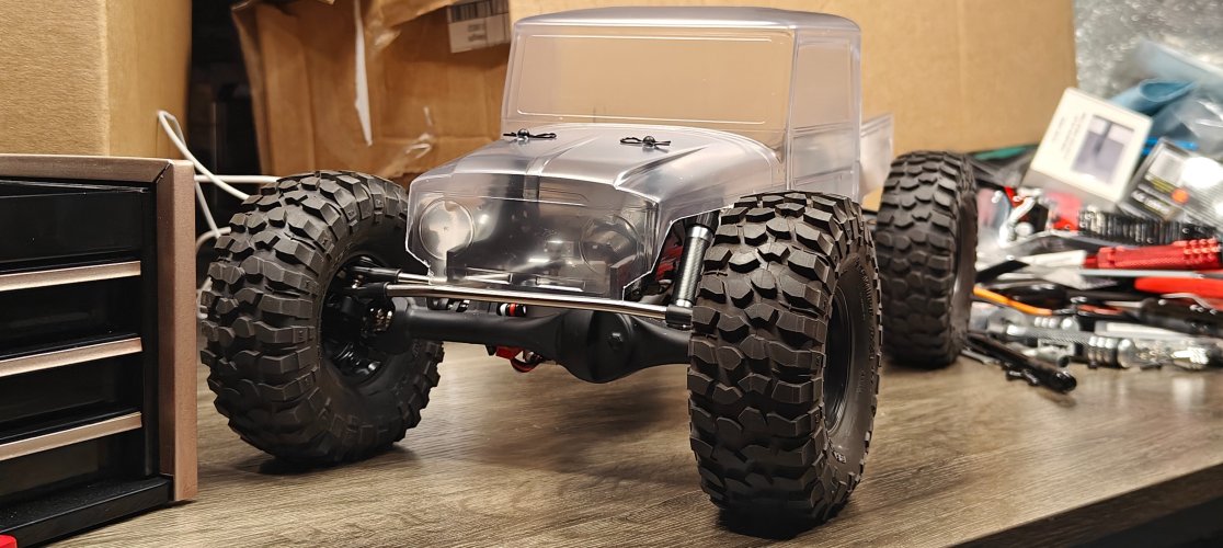

ESC placement fits just under the short transfer case shaft.

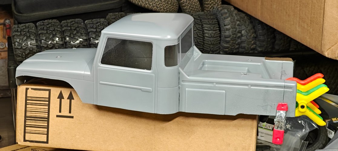

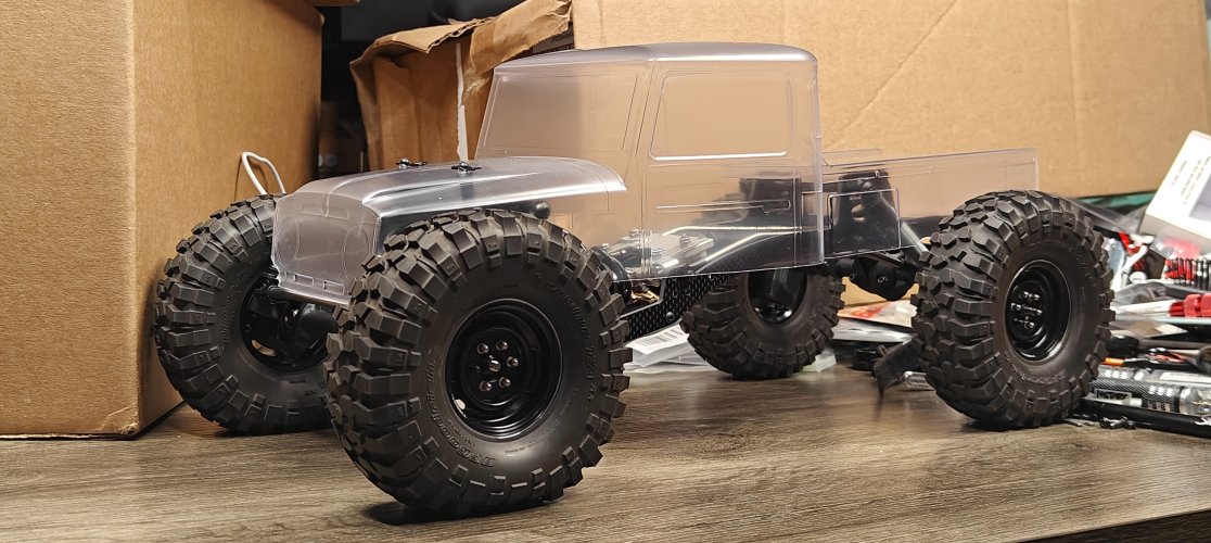

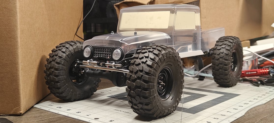

Body resting on the chassis although not correct placement as it's not level.

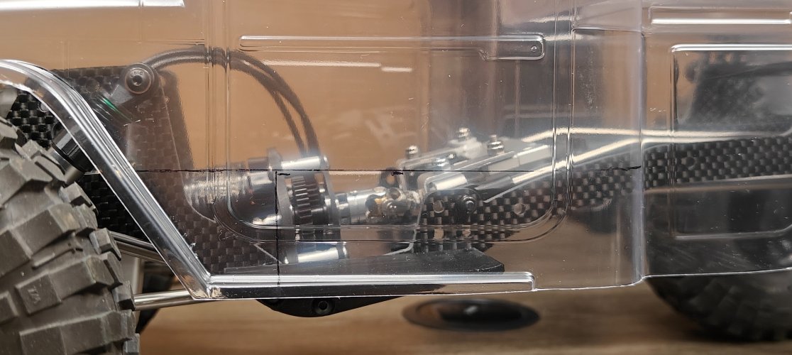

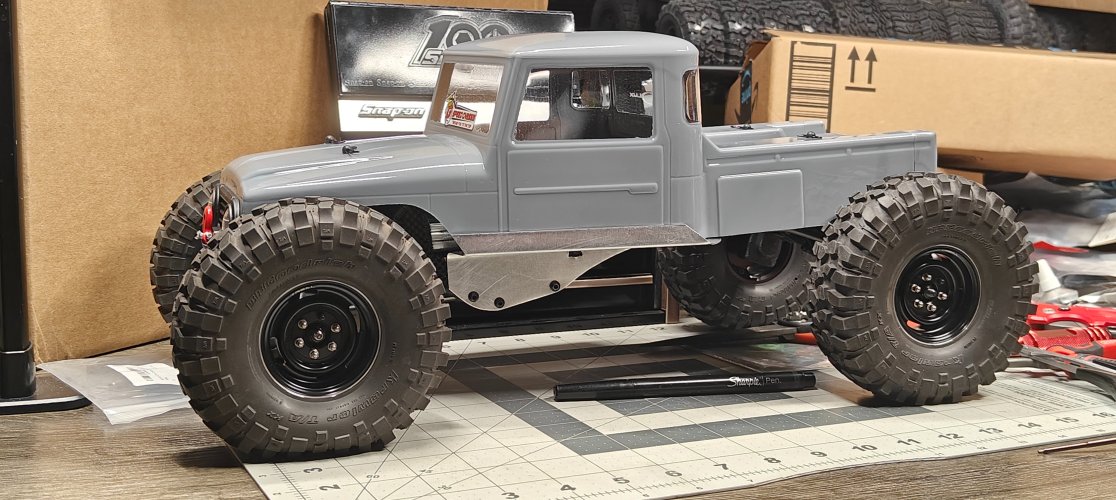

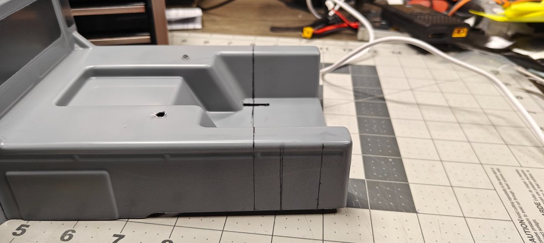

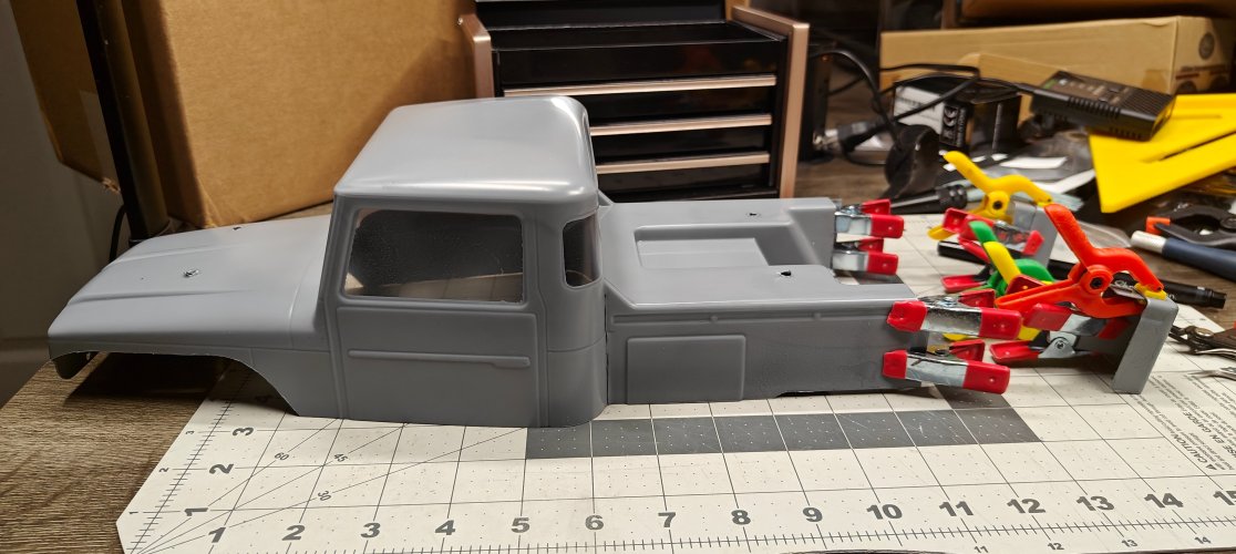

Here you could see the lines where I will cut the body to lower it. The lateral line will be at legal limit (4.5"), and the fender flares will get trimmed off.

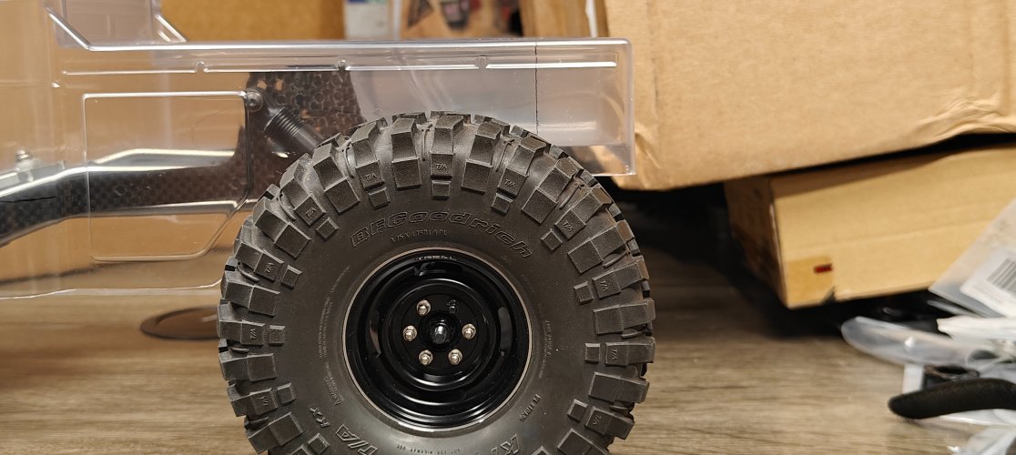

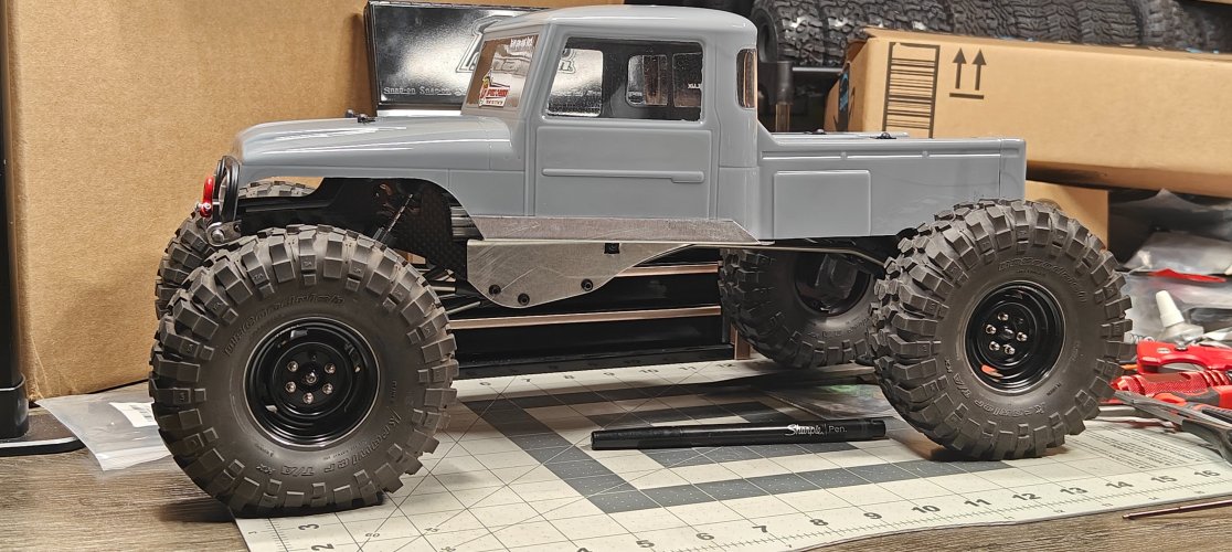

Here is a rough placement of how the body will sit, again still not level with the chassis but body scooted back to legal limit (front of body aligned with front edge of wheel rim). This is why the chassis rails will get the ends cut off.
And that's how much shorter the bed will be once I bob it and lines up with the rear edge of the wheel rim.
Can't wait to cut the body up and further tune the chassis. I'll try to update this build daily for the rest of the week as the comp is Sunday.

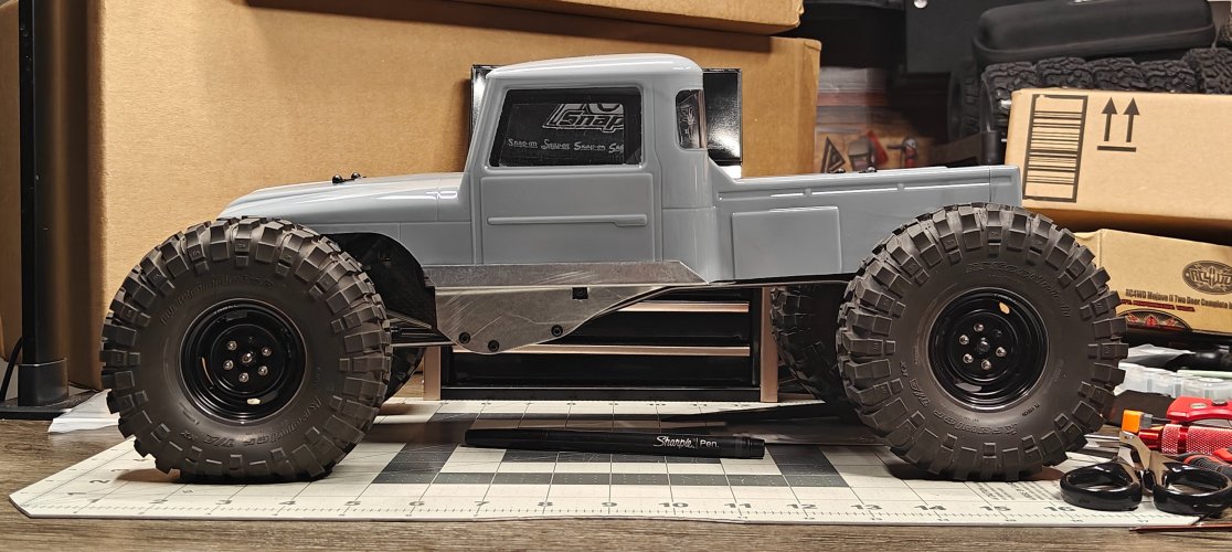

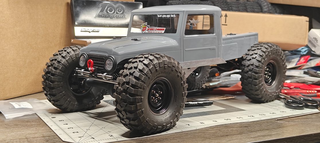

[Update 1]
- Front flares trimmed off (original arch shape for now)
- Sides trimmed and ready for sliders to be shaped, hopefully complete sliders tonight
- Bed bob will be after paint
- Paint prep tonight also
- Rail ends chopped off
- Body is mounted in front only for now but levelled (side cut line level with rails but also meets 4.25" center rectangle/cab height criteria for Class 2)
If I wanted to be super competitive, I could lower the rear of the body and trim more off the bottom bed to maximize legal rear rectangle criteria, but it would also take away the actual shape of the truck and I'd rather have that.

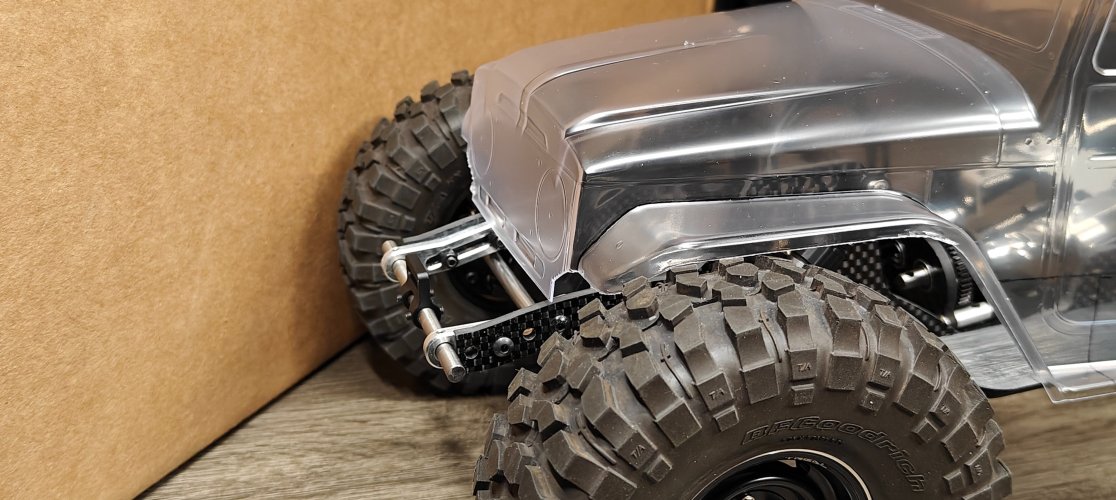

Since I have the body mounted, the front end can mostly stay intact which is what I was hoping for. I want that FJ40 front on still and looks like I can mount the bumper without disrupting the Zuul headlight/grill piece which is awesome. Under full lock though, the corners rub so I'm gonna trim away that unfortunately.
