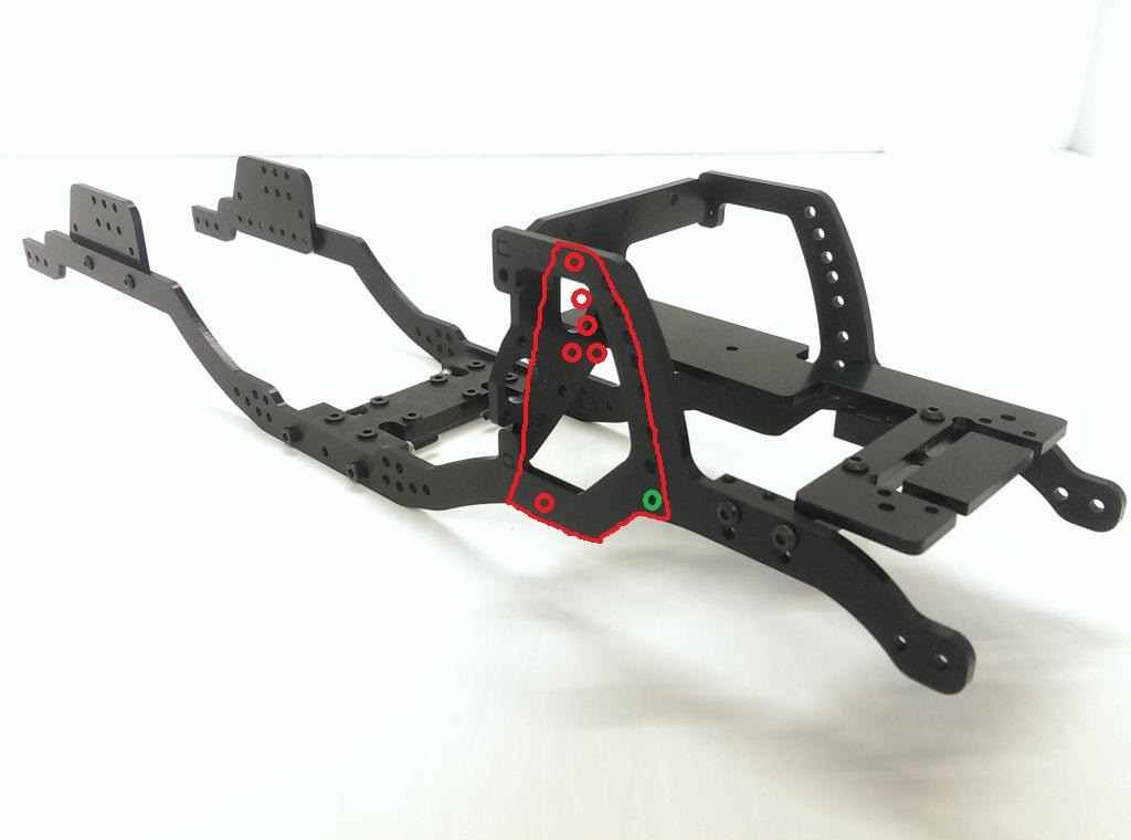

Now I do have a question I don't think I need to ask, but the way many on FB are reading it, I figured why not. People are saying in C1 a shock mounting point must now be on a welded/brazed or mechanically fastened piece. I don't see that in the rules, I do see if it needs shocks hoops they must be separate and of course if you want integrated hoop points.
Is my GCM Class 2 Skeleton chassis now illegal? It uses frame bolts front shocks, and a cantilever Dinky rear system since I made the JK body have a flat floor and not the rear seat (yes I know I removed possibly points, but I prefer my JK scaler to be exactly like my 1:1 JK).
If I read the rule the FB way, I'd need to cut off the front towers/mounts and some how reattach them. On most chassis I can see easy ways, not so when the GCM mount area also is integral to the trans mount.
How I read the rule, I'm good, but I'm not getting integrated Hoop points and I get that would be skipped.
Chassis in question (though I'm sure you guys know):
I would just add a separate shock mount, and it would pass. As long as it mounts to the rail and not to the current mount.

Can I ask why C1 was chosen to have the shock hoop rule? And why it would matter how the shocks are attached?
Just looking for insight on why that particular rule was placed.
Thanks

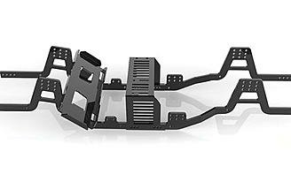

Simply to keep the noddle chassis out of the class. The ones that the rail rises up into a shock mount.

The shock hoops are part of the frame rail rather than an additional piece that is attached separately.
Sent from my SAMSUNG-SM-G891A using Tapatalk
So my rc4wd gelande 1 based vehicle is now illegal in C1?
The chassis in question.
e4zk1DsaqbJBl_hVd__sDOR7Vg3OnxREyx9-Pu5e8nChXyaEAwO3Ti42w19HRUbTV9s5DsFUEAWC-sgLYdXQ6N2eTAYgjNgggfj49Df8h6rq6rxuDUQrvagAJKy-gVK__iy-1rDPl3pNR7-CCVsmpwxtrvKwB5t_pqqP6jBxOFt-5XCeIdT53E5gEcK8___gBAi6CLucl4nxy3XnbU8QybSrdGxmfJXw90icmL8skXE7aHu3Da6sYgiEFvrB4extbmh1iHbYxh4l3_hcfAkGWBR8vhLaHq-3qVKVqYOhmAOm3gyVK7zV9G8g1yaEZU8cjG4pN_lCEm6NXohw6drUecoQkrVp0aysuUgnU8wqRB8SOSb14OgeHQ6hj5M3pdsGUPRXar-A4-07UCdRnujjKxDlqeiSYEISb-JKcwybaxnd8z41XgQN2ZjG97K97t5xb8izfjmttam10EFSNdLn2HYzfoha7ckDzLwwDWKZ2voF8MN8sUcEyr0zf_uxeMxO704CPZhY66mgQsWWIT4y9fAZ9T63eWctmYR2N3XmfuYy8FGovWmut1jQN-vAs7kOeQGsBEPQ5dDbAU0lC0EB5drJaLS0_Zv0AaILJ7g=w900-h625-no
Unfortunately yes, we realized there would be some chassis's that would fall out of spec. But in the same token, we also realized those chassis's could easily be modified back into spec.
It's an attempt to keep C1 pure and without the highly modified aftermarket chassis that are not exactly scale in appearance and function. Metal ladder style chassis with separate shock mounts was the best solution.
Totally get the idea, not complaining, just trying to be compliant for Nationals this year which I do intend to visit. And still want to run my GCM truck since it matches my real 1:1 JK.
If I make a plate similar to what is in red, and mount using 1 existing hole and 2 additional I plan to drill. Then this plate would be the only place to mount a shock (I drew it half covering the existing holes on purpose to show those would not be usable).
Would this make the GCM legal? 2 holes on the frame in red would be new for shock plate mounting. The 4 holes peppered in the plate would be the shock mount holes for options.
