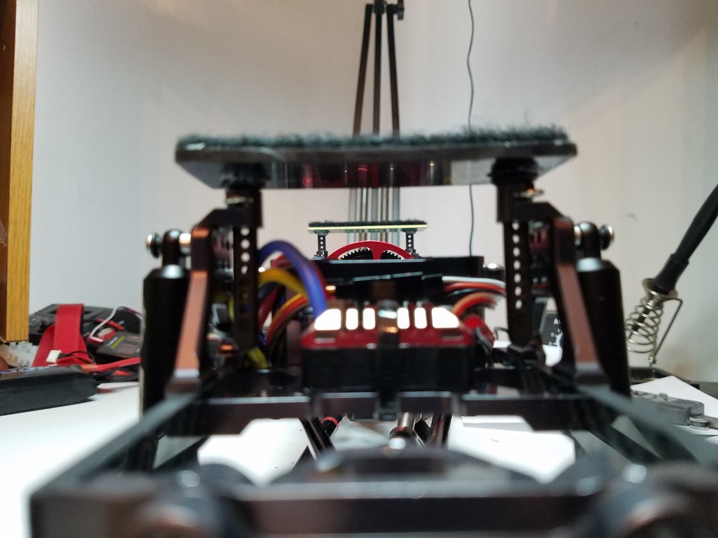

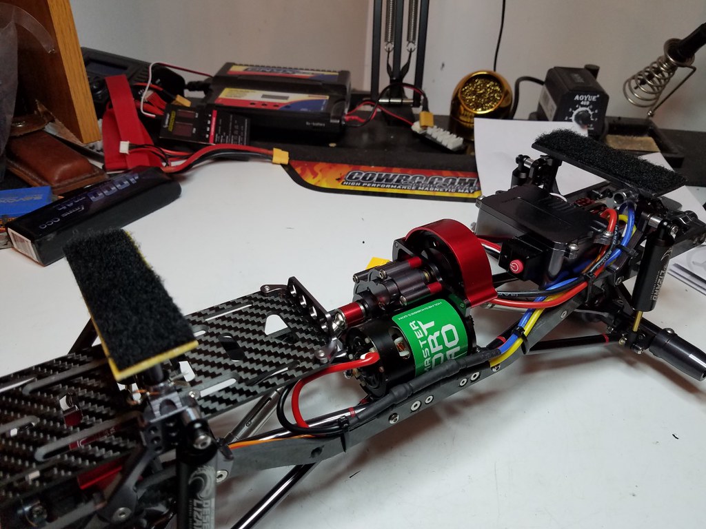

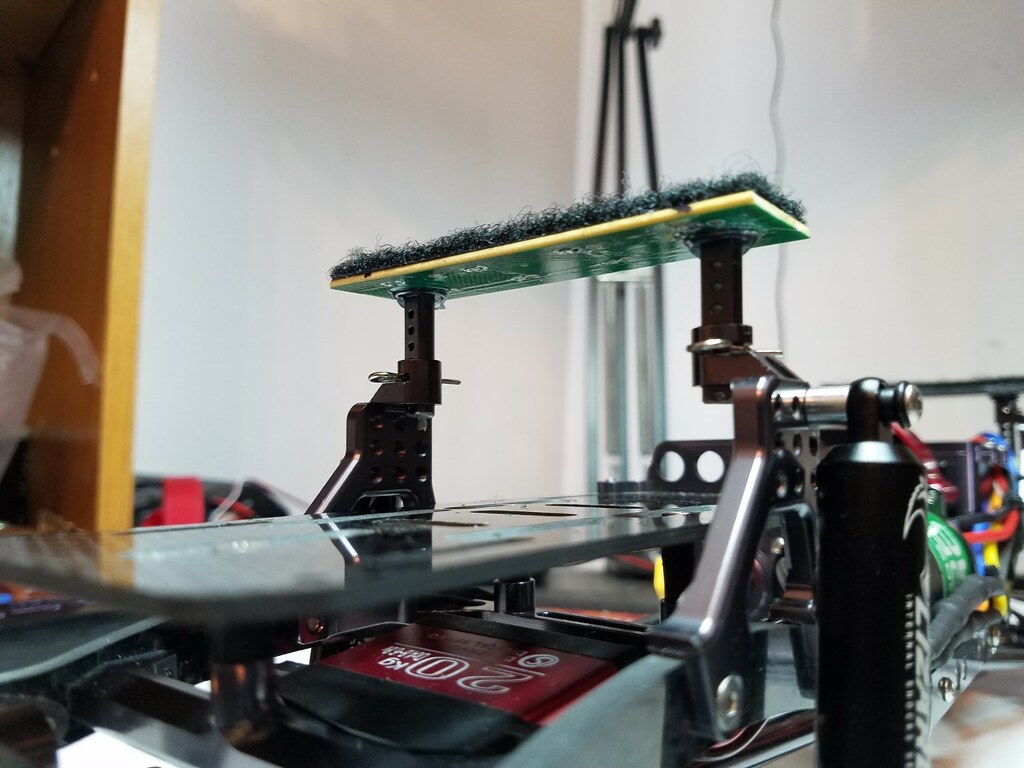

Cut the platforms from a dishwasher console and a printed circuit board (thanks, work). Drilled holes in the platforms for the body pins dropped all the way down, applied E6000 (even on the aluminum front pins), sanded flush and applied velcro.

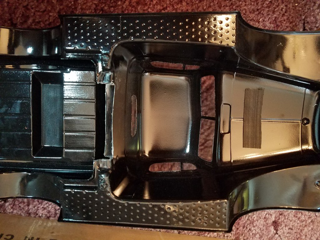

Determining velcro placement sequence for best centering & alignment is always the challenge. This one was easy since the raised well in the bed made a good centering jig for the rear. I made the rear platform the same size as the raised well so it self-aligns. Just had to then align the front with both sides of the velcro adhered to the platform and press down. I do use a thin film of E6000 to make sure the velcro stays stuck to the platforms & body.
