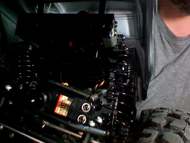

I have the long 3R springs, but have only done couch pillow crawling. I've got my suspension set up with black springs, stiff (chrome) sways front and rear, and I think 45wt oil in the shocks. It's pretty darn good, I think - it doesn't torque roll like it used to, and it sits down a lot further than it did with the gold springs so the C of G is a bit lower. There's lots of down travel now, so the wheel can drop into a hole rather than pulling the body down, and the softer springs and stiff sways still let it fully articulate.

With the gold/gold, the shocks sat almost all the way extended in my setup (could probably have adjusted those, or the turnbuckles, to get more down travel) but because it sat that much higher, it was pretty tippy. To get the articulation, I was using the same sways as with the gold/black springs (soft/medium F/R), but now with the black/black springs and hard/hard sways, I like it pretty good. A bit better C of G, not quite as tippy, still really good articulation, and the suspension sits closer to the middle of its range.
