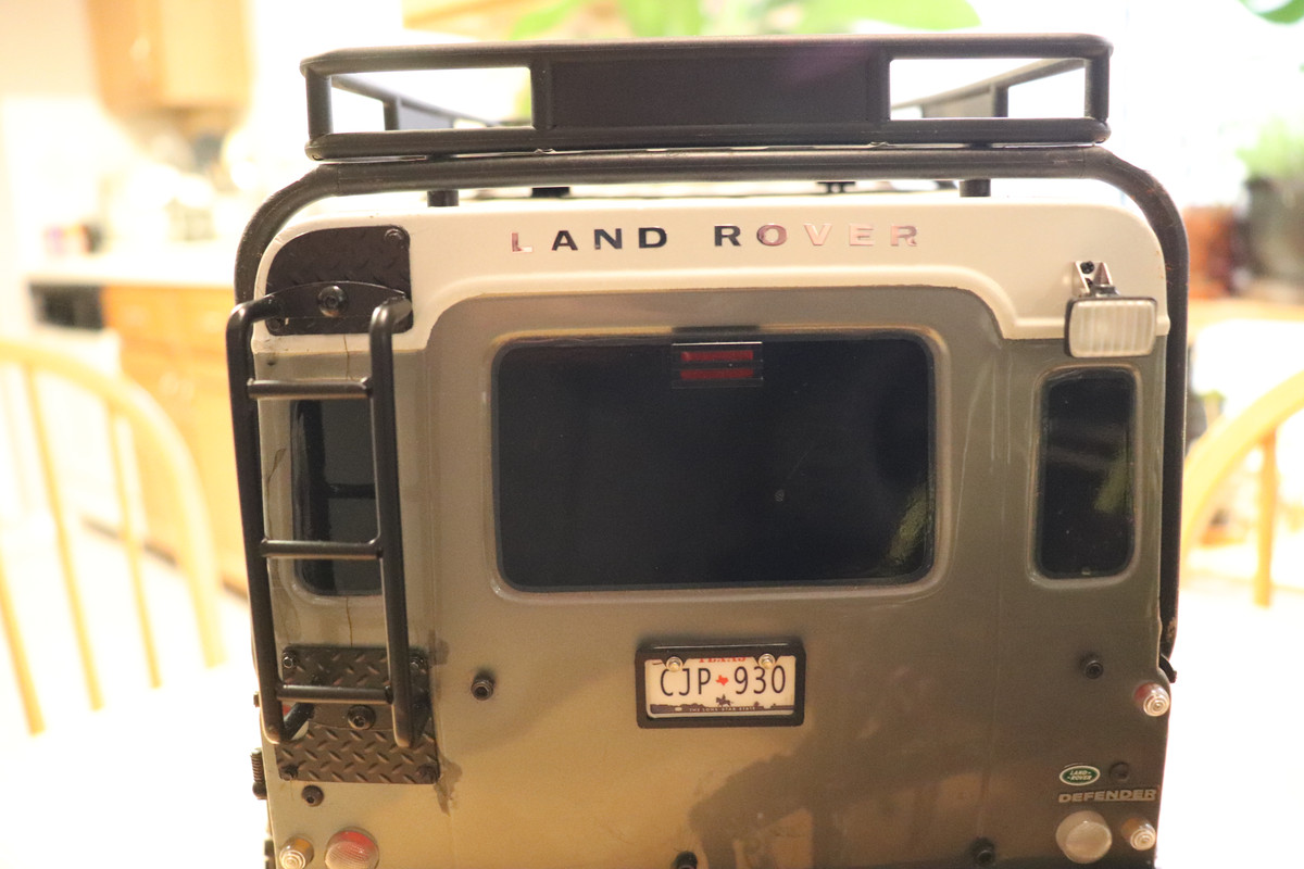

> The rear of the rig was a wreck after I had tried installing a ladder a few years ago that wound up splitting the rear pass side straight up. So I had some thin scale-size diamond plate and decided to make two reinforcing mounting plates/ panels to mount the ladder to. Used small scale screws and dbl-sided tape to attach those with nuts on the inside... tiny nuts/ much tedious lol. The two largest screws that attach the ladder are secured with [lock]nuts through a strip of styrene backed with E6000. The whole thing is now solid as can be although during the process of installing the diamond plate and securing with nuts on the inside, I unfortunately tightened a little too much and caused some additional spider cracks. Not really an issue as that entire drive-side rear is now stiff as all get out but sucks nonetheless. Fortunately the hairline spider cracks aren't too visible and hopefully there won't be any additional cracking from here on out.
*** I'll note here that the reason for the ladder was to try to fill out the rear of the vehicle because it just always looked so bare with lack of accessories. I also like adding things to accentuate the whole 3D appearance of the rig and exterior aesthetic features. And the other reason for the ladder was because of the cargo rack. I always thought it looked dumb to have a cargo rack with no way to access it lol.

Almost forgot to mention the rear ladder. Nice and I like the use of the scale diamond plate. It ties it all together nicely!
Love all the little details you've done. And that ladder wrecking your lexan a bit, then using the scale diamond plate, that's a nice touch and reinforces it kinda.

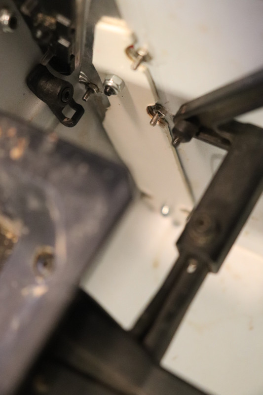

Here's what it looks like now behind the scenes on that rear drive corner. Styrene, nuts/ bolts, and e6000 all sandwiched together. Not pretty but it feels solid as anything. Rest of the body should actually break around and away from this area now lol.

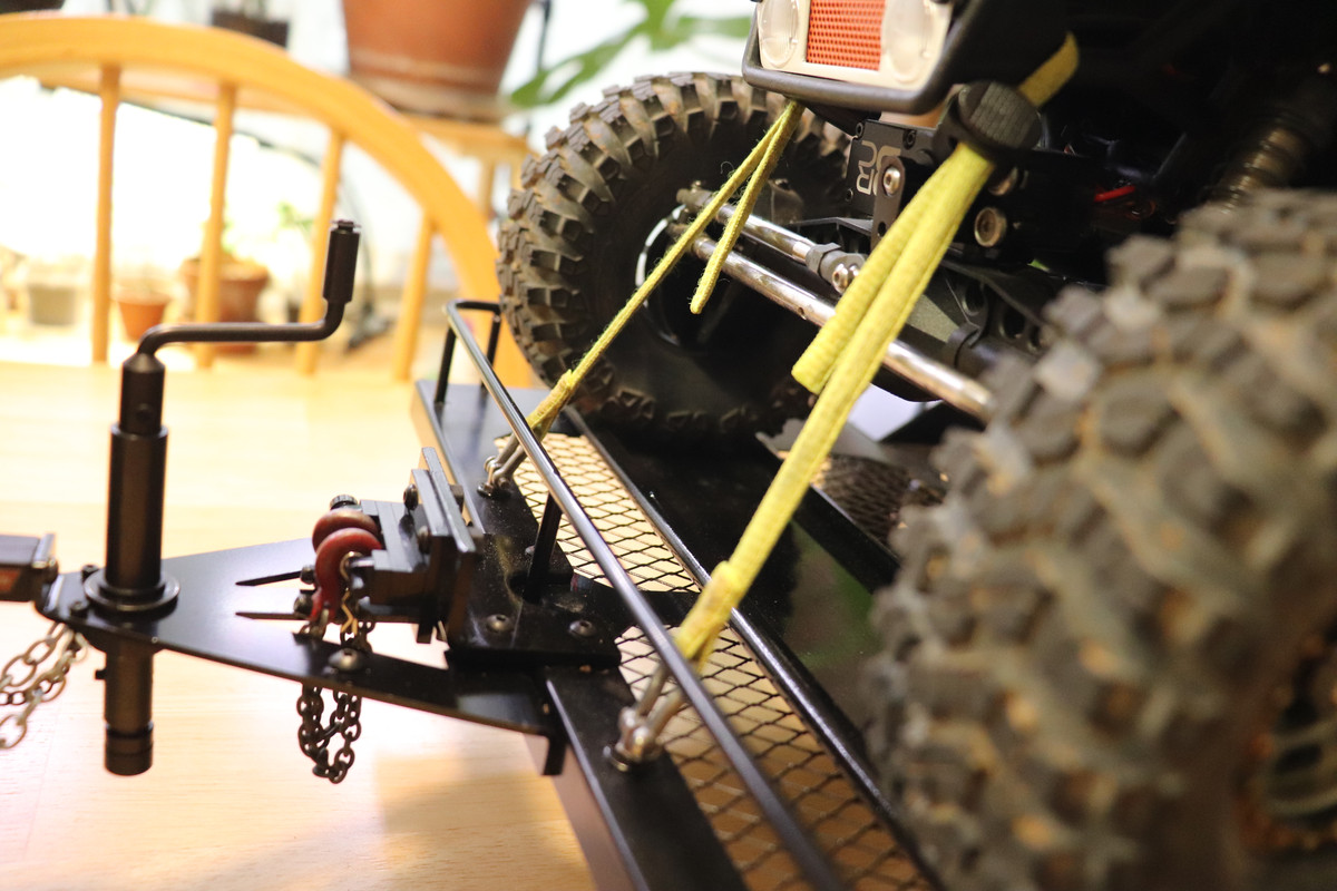

Last part of the functionality portion was probably the most crucial... 'holding the transported vehicles in place'. Talk about a lot of head-scratching lol. What I needed was function over aesthetics here yet I didn't want to completely ignore appearance.
So this is what I came up with. I started with installing D-ring/ shackle mounts on the trailer frame... two in front and two in the rear. I believe these are Hot Racing iirc. Anyway... I marked and drilled out where the d-ring mounts would go and got them installed. Then I moved on to the best solution I could come up with using straps with the d-rings... all while maintaining as much scale appearance as possible. I had no idea where to acquire straps but then one day while I was in Academy, I saw these bright yellow polypropylene shoe-laces and that was when it all started to "click" and come together.
These were strong as could be, could be cut to any length, ends could be heated up/ melted to create an unraveling end, they were just about the right width, and had that safety strap/ tow strap appearance with the color. SOLD!
So I took measurements front and back with both rigs that would be transported and came up with the lengths that I would need ( plus a few inches extra in case I measured something wrong lol). The Capra sits higher than the Marlin and both vehicles needed less length for the front tie-downs than their rears. So I would need essentially two different length sets of four... eight total.
Then this is where I employed my wife to help out. After deciding how much tag-end would be sufficient for both sets, I had her sew the other ends creating an 'eye' to snugly wrap around each d-ring. She did an absolutely stellar job... even using yellow thread for the stitching. And voila! They were done!.. kinda.
I still had to cut the overall length of each strap... long enough to be able to grab and pull with my fingers but short enough that they didn't look absurd... excessive length dangling off the trailer. But that was easy... just measure, mark, cut, then heat each end with a lighter and smash it down flat to seal the ends. I also ran the lighter along each one to catch any little frays. Then out to the garage where I applied dirt, grease, etc to give them a weathered appearance.
Finally it was time to secure them. And this is where the real-life aesthetic takes a nosedive but I really had no choice. I knew that I wouldn't be able to keep everything 100% scale or real-life in appearance and I'm totally good with that because these just work SO well. In order to keep the rigs seated with no movement as this trailer bounces down the trail, I ran the straps and cinched them up with cord-locks.. those things used to cinch-up shoelaces, draw-strings, etc. Fortunately they're black so that helps to hide them somewhat and they're sort of tucked up to or under the vehicles and not glaringly visible so they don't look tooo bad. And I went through several different cord-locks to find the best option... small but still usable to cinch/ release quickly and utilizing a strong spring. Some were too weak, too small, too large, etc. But with these particular cord-locks and straps I can pick up both the Capra and the TF2 like palming a basketball and shake vigorously while they stay securely planted to the floor of the trailer. They simply don't move or loosen at all. I also like that these straps have the perfect amount of elasticity to aid in getting them cinched up. I ultimately switched to a different set of D-rings that all match and utilize the same hex-head size. Originally I was using four different shackles with two different sized hex-heads. Now they're all the same and utilize the same hardware although the only time that I'll need to even remove the D-rings is to switch out straps. The TF2 uses the shorter straps/ Capra uses the longer set. And technically I can just use the Capra straps for both rigs.. just that they're a little longer so there will be a little more strap 'flapping around in the breeze' if using them on the TF2. ( You can see in the first pic what they looked like new in pkg and what they look like now after weathering.)
Here they are cut to length... four sets: Capra rear/ Capra front/ Marlin rear/ Marlin front. Also shown: new D-rings and cord-locks.
Not sure it's worth noting here after so much text lol but I've now discovered that I do NOT care for the more realistic-looking d-ring pins that you have to turn by hand. My fat sausage fingers just can't handle that task. I'd much rather use the less realistic-looking hex-head pins and spin a hex-driver to insert/ remove pins. Plus I feel like the hex-head pins can be tightened more securely.
I think that about covers the functionality part of this trailer. Now onto Part 2 that covers the rest of the aesthetics.

This is a pic of the rear Capra tire... able to utilize the full cradling effect of the upturned edges of the aluminum plate on the back-side of the rear tire and partially on the front-side of the rear tire. Hard to explain and not very clear in pics but maybe someone will understand all of this I dunno lol.
And this is what both rigs look like sitting on the trailer, ready to be strapped down.
Done!
Capra strapped down:
TF2 strapped down:
Ready to get outside and hit the trails now that cooler temperatures are here! Just need to set up and program the new ESC's in the D110 and the Capra. New motors in the D110 and TF2 as well.
