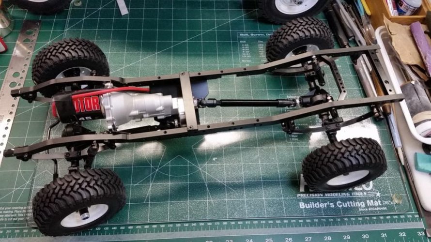

Small update...
After ordering two new sets of R&P gears and waiting, what seemed like an eternity, I got things back together. I have to admit, this is the smoothest, quietest gear set I have ever had.
Surprise bonus...the new gears are 3.00 gear ratio where the old ones were 2.66. Since the front has the original gears and the rear has the new ones, I'll have an extra bit of over drive in the front. I'm a little concerned with the front overdrive already present in the GCM transfer case and this added overdrive. Do you guys think this will be too much? If necessary, I can always throw the other set into the front, and just work it with the GCM overdrive...
Here's a pic of the completed drive train, just cuz.
