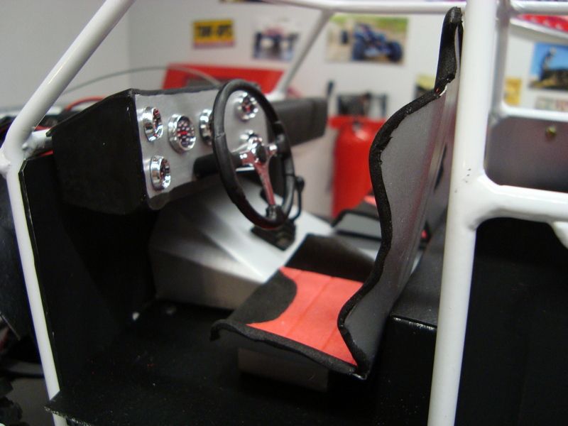

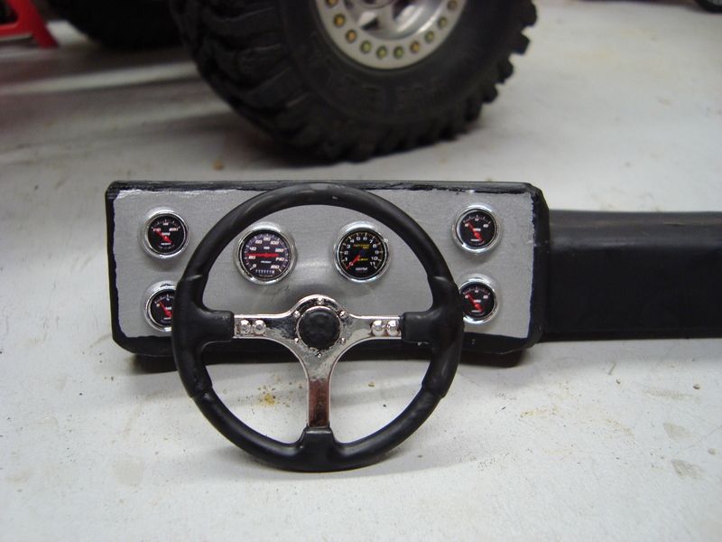

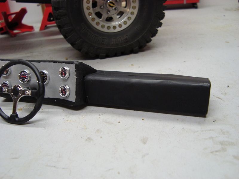

I asked a guy a few months back about making a 3d printed dash but no luck on getting it done anytime soon so for now I made one. I will be adding more detail to it

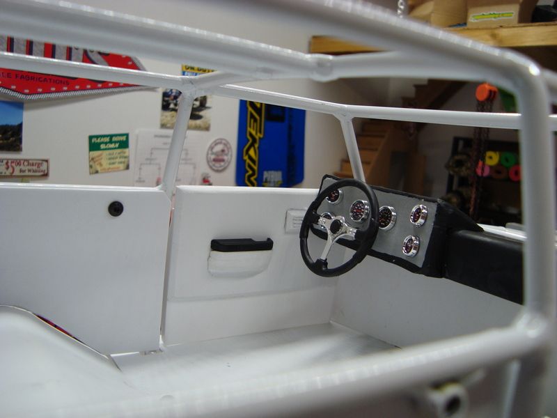

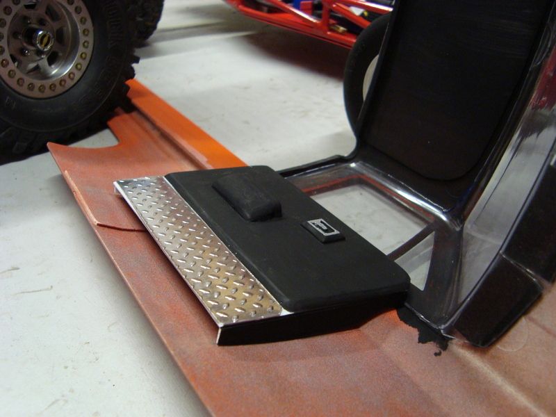

did a little work on the door panels I still have to cutout to make the door handle look better and add a panel for power window switches

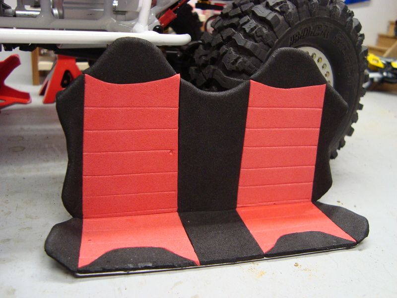

made 2 front seats ive haven't really figured out the colors I want for the interior so for now it black and red :roll:

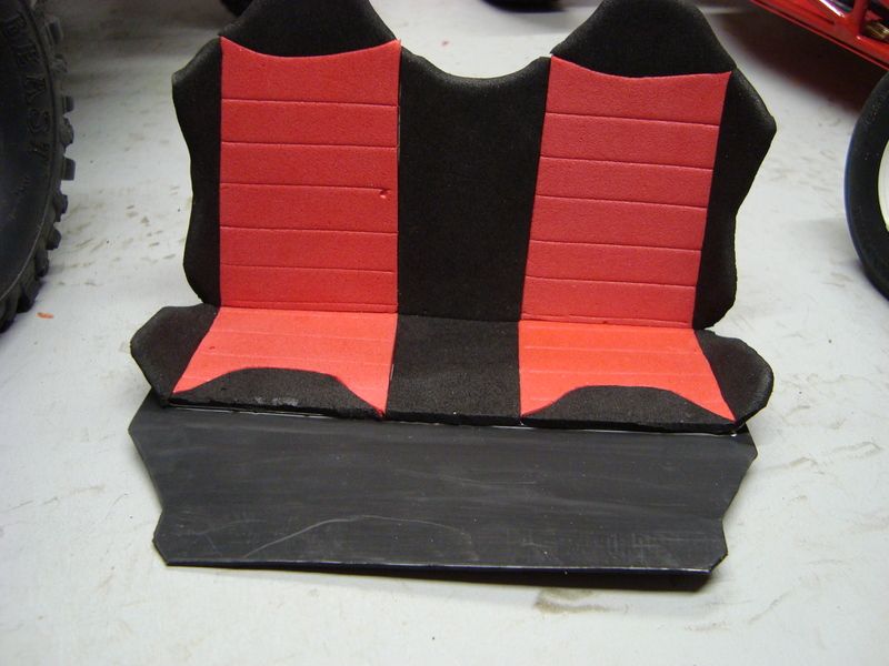

and it needs a back seat

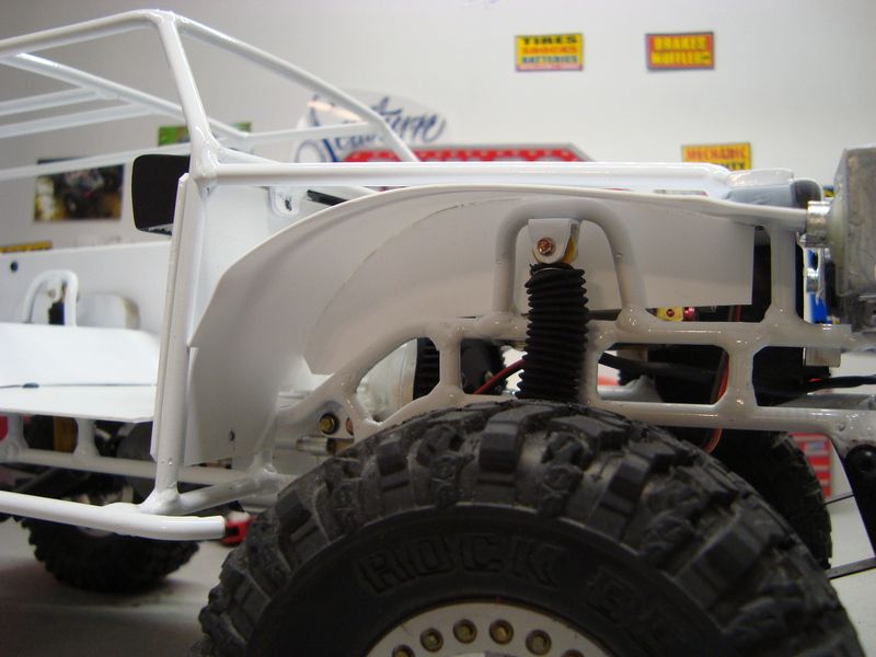

and to make even less room to put the electronics I made these big inner fenders "thumbsup"

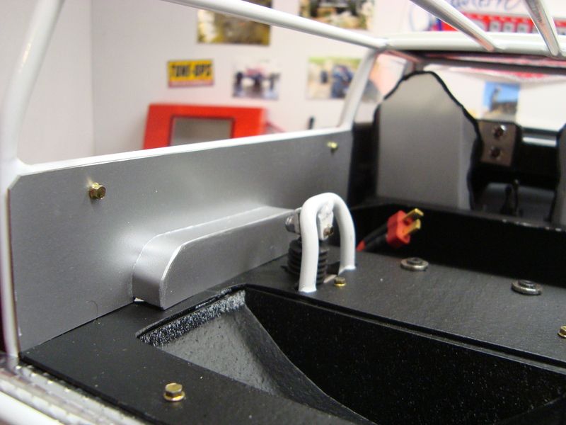

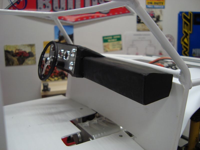

dash, seats and trans tunnel are done and mounted. floorpan and firewall have been sprayed with duplicolor bedliner. trans tunnel and inner bed sides sprayed with aluminum to give the custom fab look
some lockedup scale bolts to keep things in there place

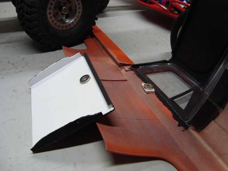

door panels are in with a little diamond kick plate

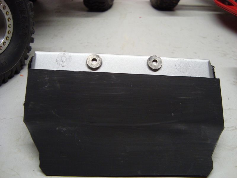

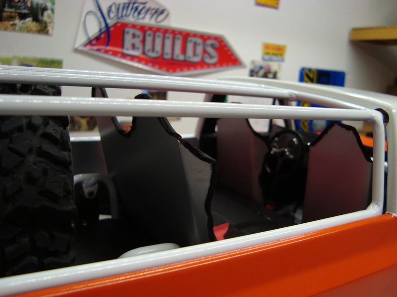

used some super magnets I picked up from lowes to keep them tight to the body but can still remove them later if I decide to make the doors open in the future.

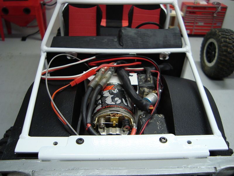

not a lot of room but enough for a smaller 3s 2200 pack to fit and covered with the rear seat and magnets to keep the seat in place

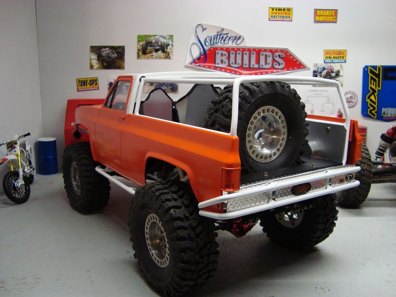

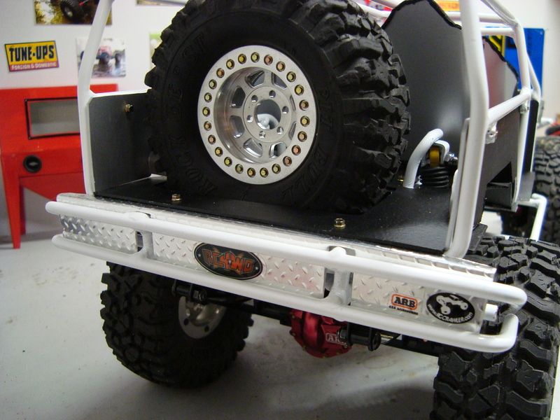

spare in place and some more diamond plate so I can show a little support with some scale stickers
not much room but it all is in there rx is on the firewall just cant see it

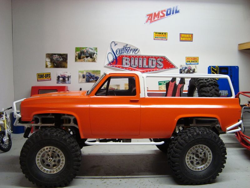

and here is a few exterior pics
