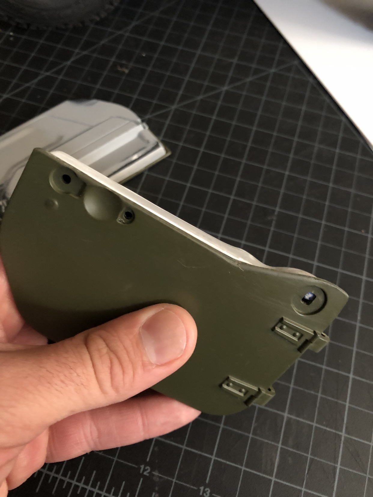

Half doors are a nightmare as this is supposed to be a modern jerp acting like an older one...
Fail No. 6? My styrene refused to bond to the panel material.
The styrene kept separating until I loaded the backside w/more reinforcement and all 3 plastic glue types. MEK, e6000, CA.
So finally:
I’m not ENTIRELY happy with them as they’re more like halfass doors with pockets for door handles/levers. putting these aside for now....

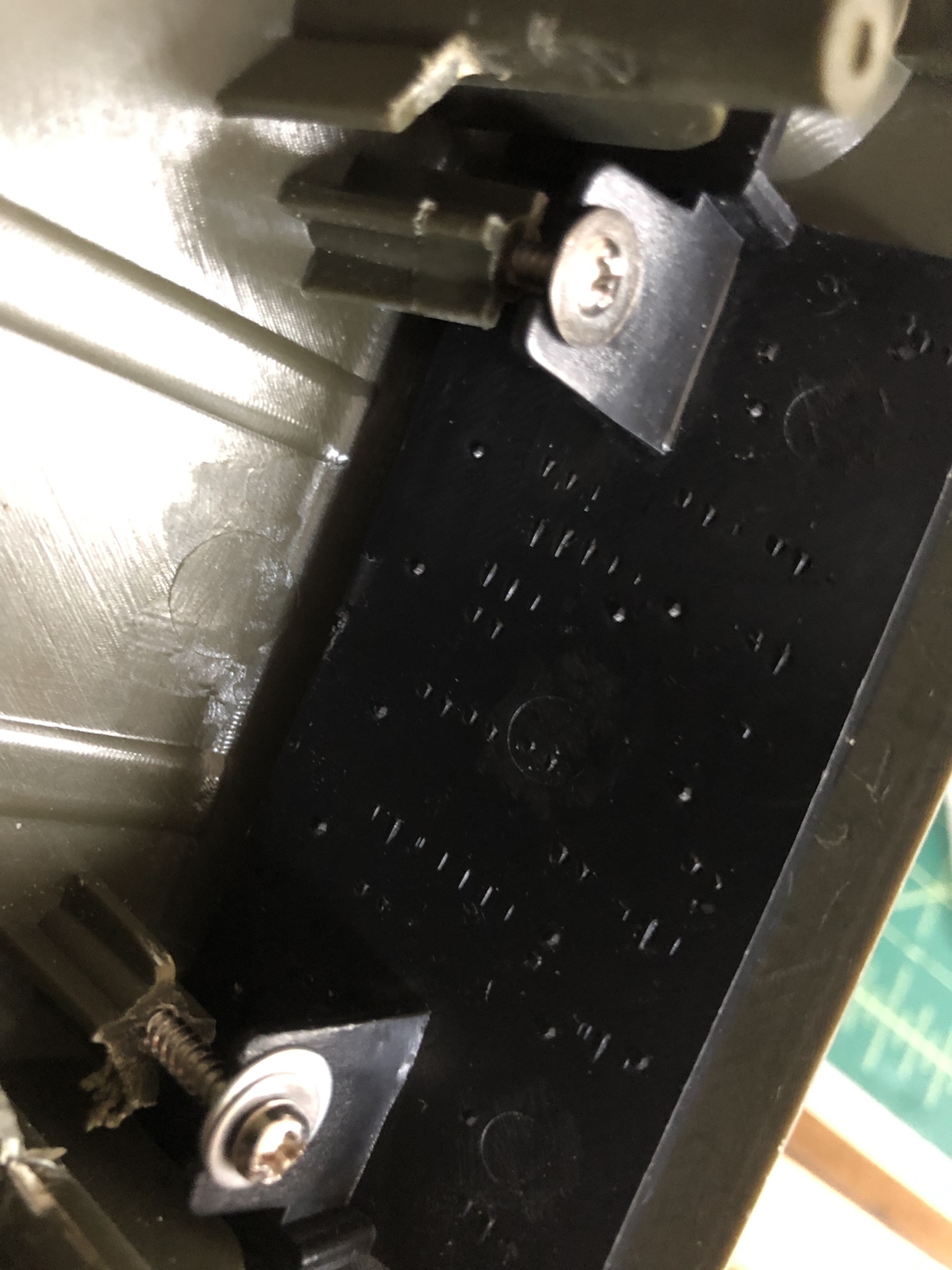

So I had these tabs left over from my Sawback and finally decided I would have to use these to “permanently” mount the body. I just don’t have the skills to make magnet mounts, so the battery will have to “live” inside the car.
I can still take it apart to service, or even change the battery in the field (although not easily) which is my #1 priority for this build. That’s why I left the two tabs with existing holes on front grill/bumper area.
Drilled holes to mount Sawback tabs
Then simply mounted them so that I could insert a M2.5 button head through existing holes on the body and capture on backside of tabs.
Below you could see this left a gap between the tabs and body
So this is where my accidental genius kicks in! I installed the m2.5 bolt through those rubber servo dampers (we all find everywhere in the house) and between the tabs and body. This actually gives some shock resistance as well as adjustability to allow for better tolerances between body pieces (I.e. doors and windshield piece).
I also can adjust the bolt connecting the dashboard to bulkhead to further tighten/loosen the body as required. Will this all work? Probably not... but if it does, pretty cool lol.
IT HOLDS! Finally...
