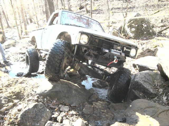

Here is my old 1:1 that I will be basing the build on:

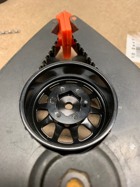

I wanted the deep dish wagon wheel to mimic what I had on my 1:1 rig but they were 5 lug, not 6 so I figured I would give "converting" them to 6 lug a try....
So I started with a 6 lug hub and drilled out all holes but one. This let me use the one un-drilled hole to screw it onto the wheel with one lug.
Then from the back I used the drilled out holes in the hub to guide the drill bit to drill the holes in the wheel. Have to be extra careful the hub stays center when doing this (not easy to do with only one bolt holding it).
Here is the first wheel/tire/brake rotor mounted. The hub looks a smidge off center but it is closer than it looks in the picture and I think it will be fine for a crawler.

So would I recommend this? Probably not for the amount of work it takes and it is difficult to make it "look good" if your going for show quality. But for me it will resemble my 1:1 very well and I am not so worried about the scratches and such on the wheels. I will most likely get a second set of nicer bead lock wheels and 4.19 BFG Mud Terrains or Krawlers at some point anyway. This first go around is just in an attempt for scaleness at the expense of some performance.....
