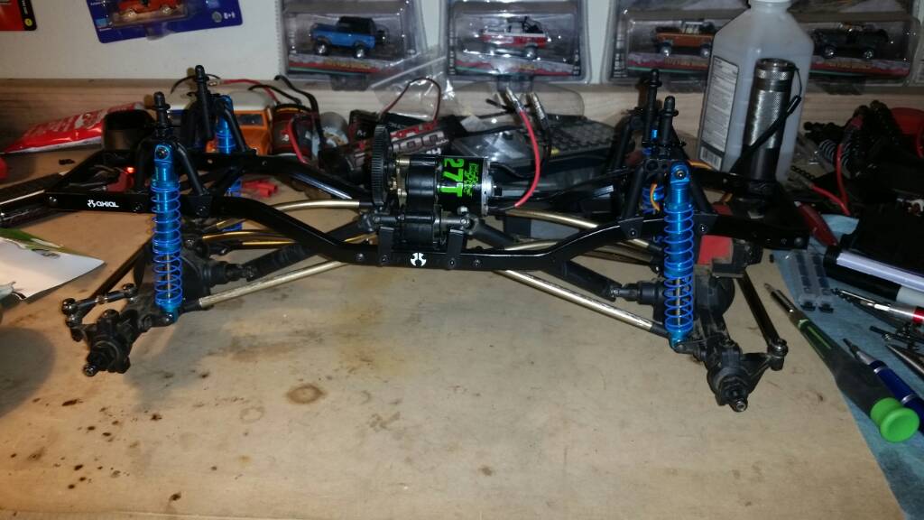

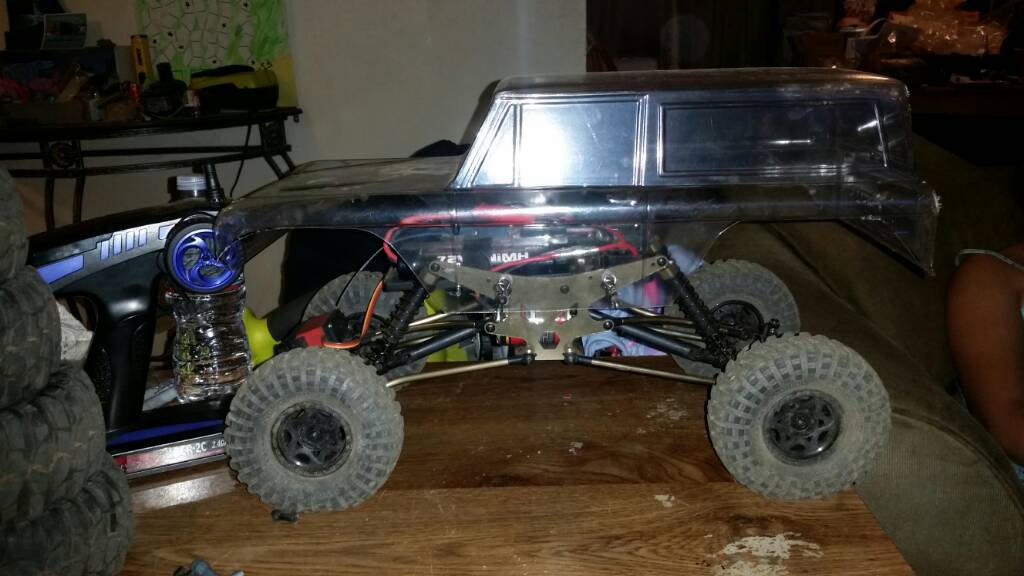

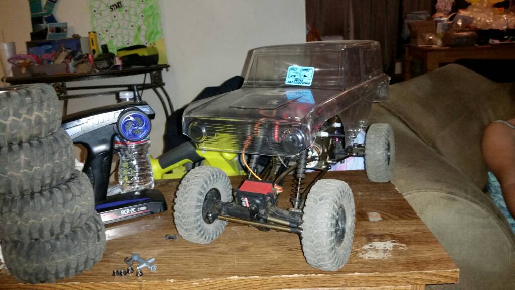

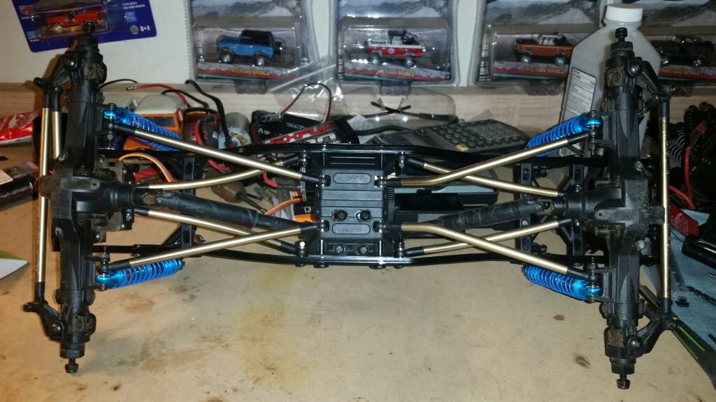

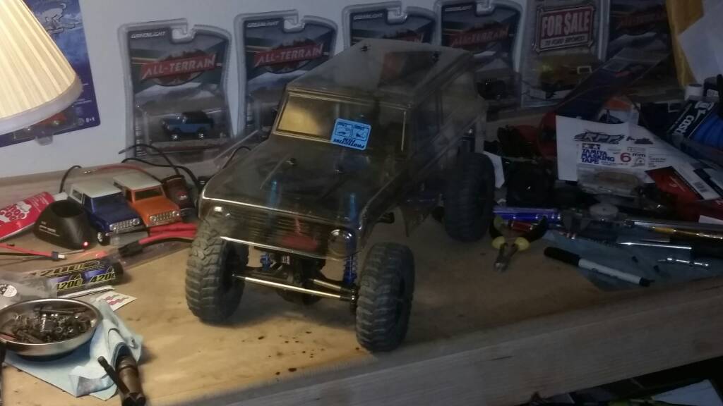

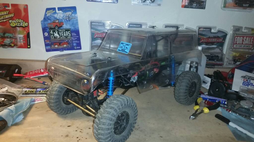

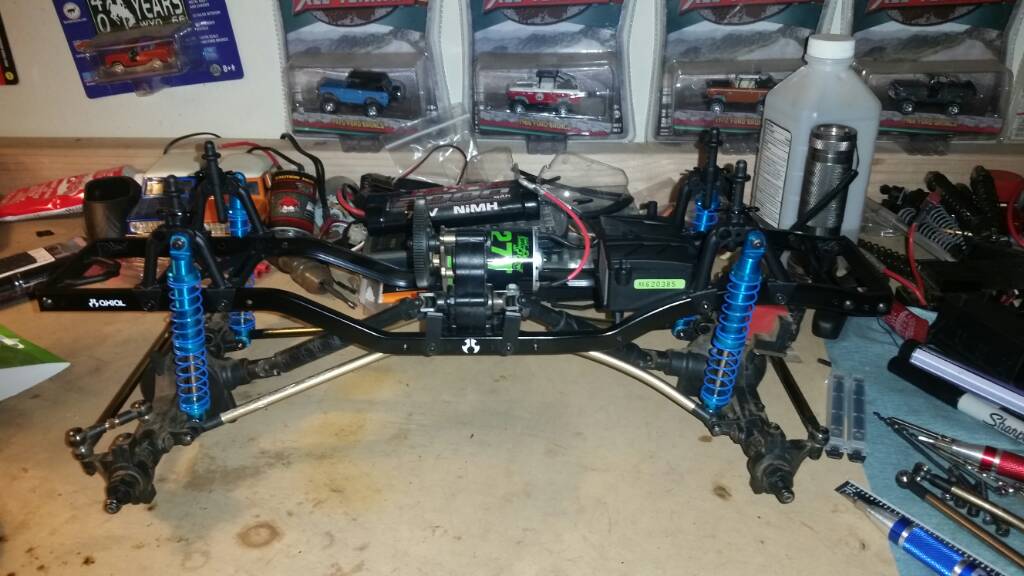

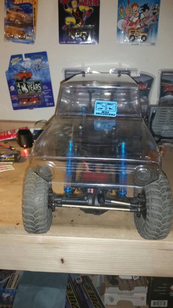

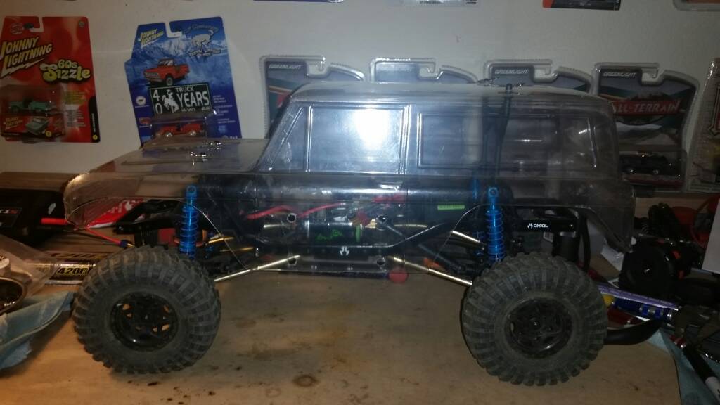

I went ahead with the scx10 chassis and put all the redcat drive train and electronics in it. With exception of the motor, I went with an axial 27t, just couldn't put that slow thing back in. I had to slot the scx10 skid quite a bit to fit the transmission. But it bolted up tight so I think it will be fine. I used the redcat aluminum links and the wb came out to be 12.5". For the upper links I just turned the rodends so the curved link was inline with the frame. Also added some washers to adjust the pinion angle. For the lower links I just had to swap the pivot balls on one end if each link because they had really thick flanges that were to wide. I swapped them with axial plastic pivot balls. I then added 100mm aluminum shocks from ebay. I am putting a Proline Bronco body on it, just need to paint and it will be done. Over all it was a really simple build, and I think my daughter will enjoy it more as She wanted one like my Deadbolt
I would swap those rear lower links around. Use the bend in them to function as high clearance links. This is how I did mine.
