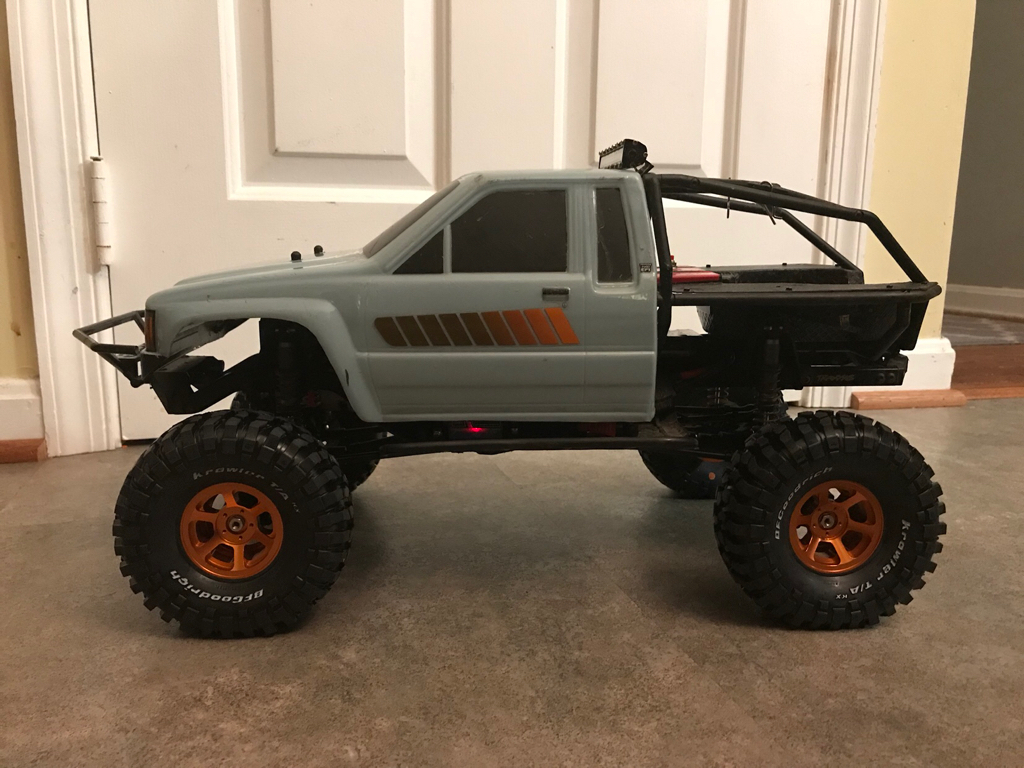

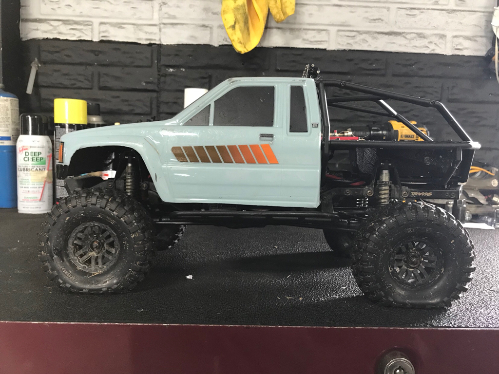

So our first outing we went out to some local hiking trails and had a blast. Of course the first things I noticed was while the defender looked great, it was super too heavy and would tumble easily. So being a Toyota fan I wanted the hilux. So here’s a before and after.
Couldn’t get the window film to lay how I wanted so I did matte black vinyl on the outside instead.

Next on the list was a rear cage setup instead of the bed and a light kit. I like some of the 1:1 truggys and thought I’d try and replicate one. So i ordered the axial bed cage. I’d like to do a full exoskeleton setup, but I’m learning stuff as I go so I thought I’d wait till I get a little more comfortable with it. I picked up a light kit with light bar from our lhs. Looked cool and that’s the only reason I did it honestly.

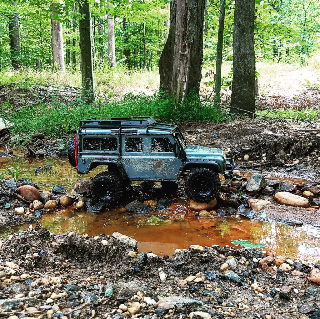

So as you can see in the previous picture i enjoy water and the stock foams took a beating. While the stock tires perform great with them being as flat I found it doesn’t work nearly as good as deflating my 1:1 tires. So I ordered some integy 1.9 beadlocks and the proline bfg krawlers. got out the white paint pen and hooked up the lettering.
Found out the beadlocks hit the portal so I ordered some gpm 12mm adapters. Gave it some nice stance which added to a wider wheel base and more stability.

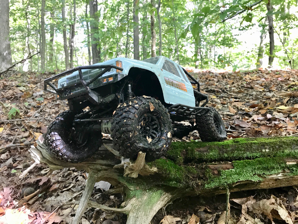

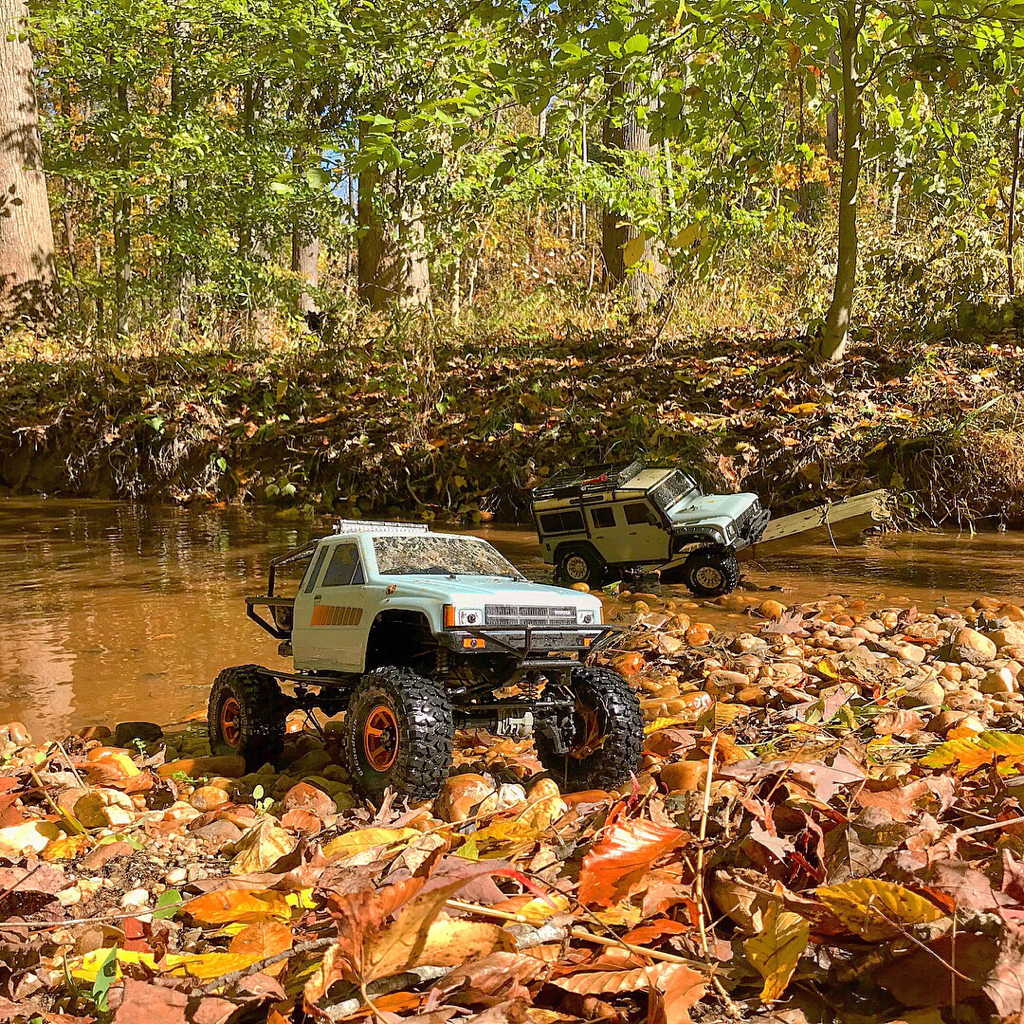

I got a bumper and sliders that you’ll see in some pics, can’t remember who made them. Found them cheap on eBay. Used them for a bit, but ended up pulling them off as they weren’t as functional as I though they’d be. Here’s just some pics out and about.
