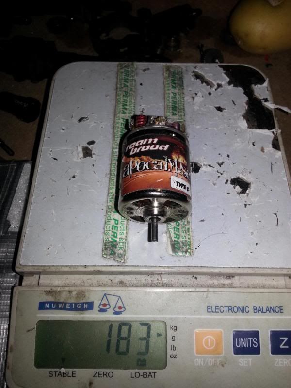

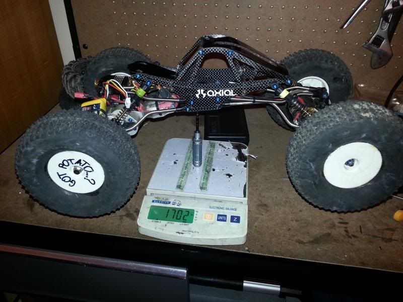

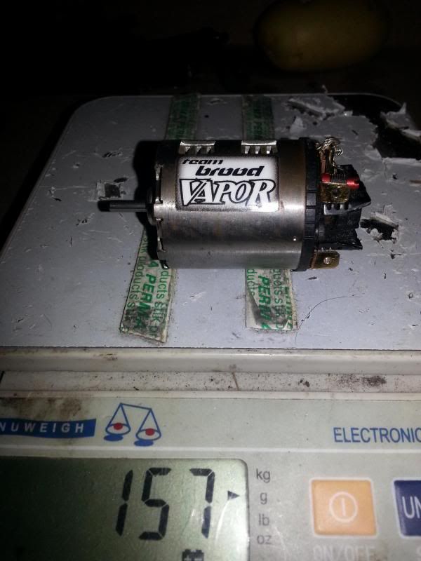

Current RTR weight is around 1660g, with 45g on each front knuckle. I plan to swap my VP front topper to the plastic setup to drop some weight and possibly a motor upgrade in the near future.
