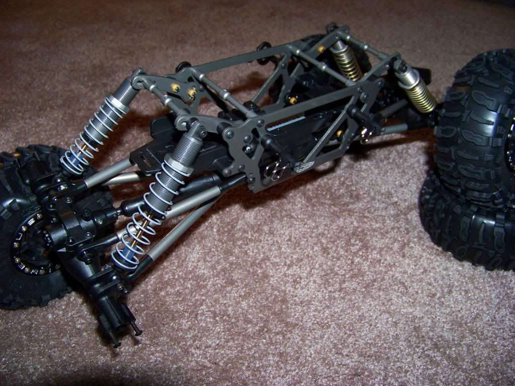

Well, after a few comps with my modified night crawler, and doing very well, I've decided, I'm addicted to crawling. That being said, it was time to take the next step. So after lots of thought, and selling a couple things that just weren't for me, I made my decision, it's comp crawler time!
My local shop finally got in most of my big order. I was going to wait till it was complete to post anything, but I figured what the hell, I look at everyone else's rigs, might as well share mine.
LCC Race Roller # 4608, ordered most every upgrade that Losi has to offer, (except the carbon arms, already had bad luck with them once...). Got it taken apart when I got home, checked the gears, drilled for grease ports and topped off with grease. Threw on the springs and travel limiters on the shocks. I'm currently waiting on some other shipments already in the mail, including:
-Pro-Line VW body (I won a free item from pro-line at my last comp),
-R/C Bros lcg servo mount, flush mount servo clamps, and lcg dig mount,
-Losi 20* hub carriers
All I need to get done is some trimming and painting of the bodies, and figure out just what I'm going to use for a power plant on this thing. I know I'll be running 2s or 3s, brushless, sensored, and prob. around a 17.5. Just need to figure out what esc/motor combo I'm gonna go with.
Some pics thus far:
Just waiting for some shiny parts.
Put my grease ports behind the axle, no chance of hitting rocks, getting pulled out, or packed with anything.
Ti pins, alum. pin holder, the ever popular o-ring mod.
Almost the same shock setup as off my LNC, gold springs out back, grey up front, 1/2" travel limiters.
New paint, (I usually do single colors, so this was a big step for me, lol).
Thanks for looking, I'll get more pics up as she comes together.
-bryan
