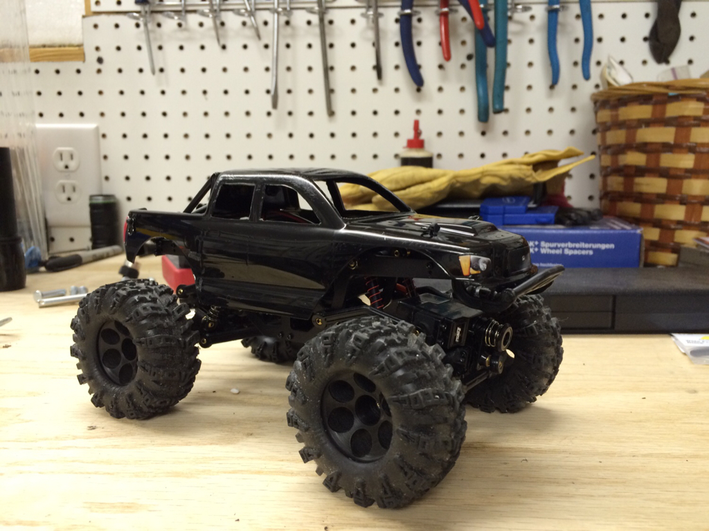

The sweet tires finally came in the mail...
They are Miniqlo miclaw tires. As the picture shows below they are HUGE! Now the con of these tires.... MOUNTING THEM!!!!! Just trying to mount them on RC4WD Rage Beadlocks made me question my sanity.
Well finally got these mounted up, hopefully never have to take them off the rims. They look pretty slick, the trekker is like a mini monster truck now :mrgreen:
Now flexing these bad boys defiantly fills the wheel wells up. Almost got full travel still, got about 1/8" of travel left when the tire contacts the body. I won't start cutting the body just yet. Once I get the wheel spacers I'll decide what to do.
