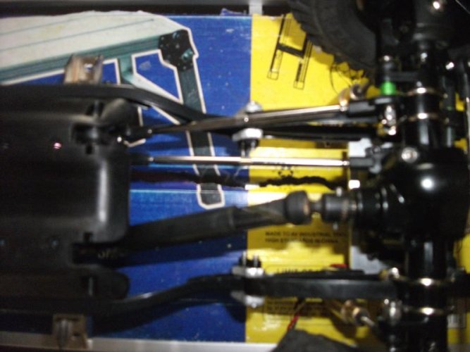

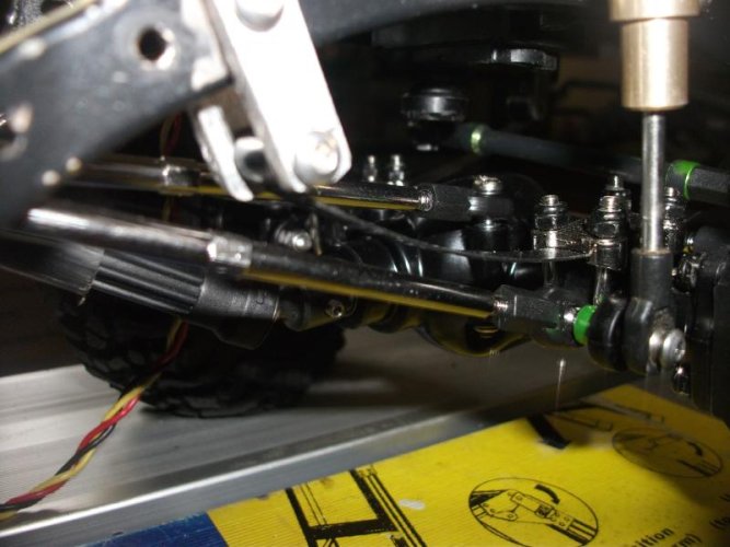

This is the setup i made for the front, They are attached to the skid by double link ends screwed together and on the axle housing ones mounted high and ones low. It works good on the bench but its not a driver yet.

I like this setup. I'm curious why the links aren't spread apart so one is on the right side and one on the left?
When i use to build 1 to1's back in the day i would always make a bracket that they both attach to and run them up to a shackle mounted to a cross member right behind the trans and had no problem with flex or binding at all. I'm not sure if its the right way , but its has always worked for me.

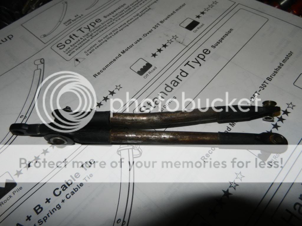

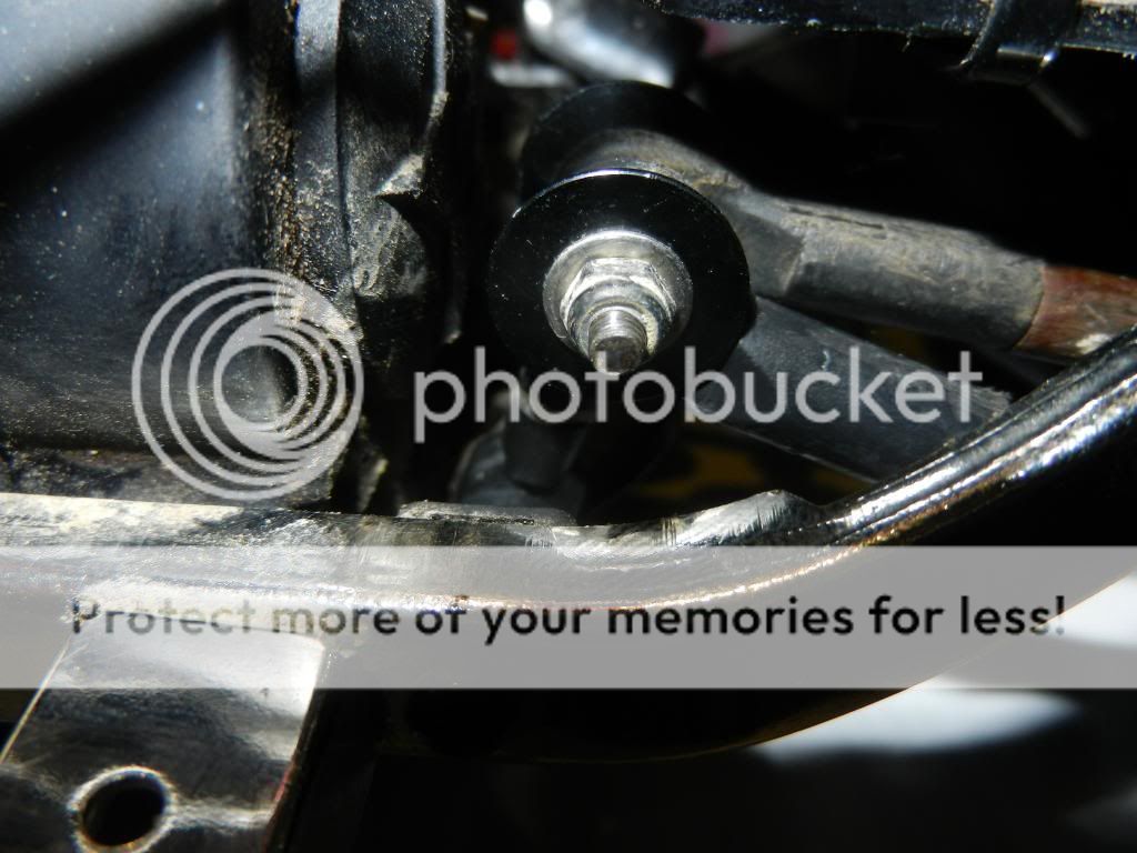

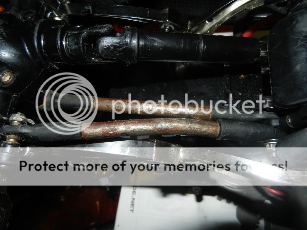

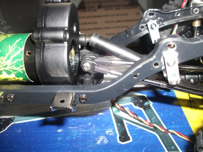

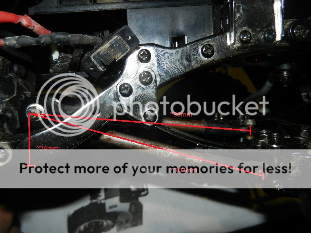

These are some that I've made for a super short wheelbase yj... They turned out awesome and are the only scale ones I've ever seen... Hope you enjoy...
Glad I saw this thread before I started building mine.
Hows the flex with the ladder bars? They look awesome by the way "thumbsup"
I just made I single pivot point on the frame and they do not affect the flex at all.... And there is absolutely no axle wrap anymore
These were made with soldered brass tube, brass threaded rod and Traxxas ball ends and hollow balls.
I made shackles that go where normally the rollers sit on the skidplate.
On the axles they're mounted on the tube that normally the servo mount would be attached to. On the top it's just the hollow ball, on the bottom I made a small bracket to not have the ball stick out to far below the axle.
Getting the measurements right wasn't that hard, I started with the upper link between the axle and the chassis, the length doesn't have to be very accurate since the shackle will adjust for it.
The lower link length also doesn't matter since it has a connector on only one end and the other end has to connect somewhere to the upper link.
Finally I added a small triangle between the 2 parts for bracing.
I'm really happy with these, I knocked both out in just a few hours, they look reasonably scale and work fine.
