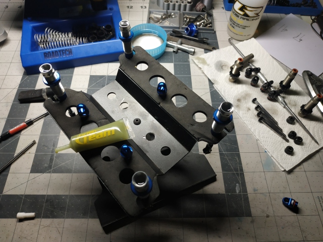

Is was cleaning and refilling my Truggy shocks so I thought Is was time to build the Unimog shocks too
Pro-Line Pro-Spec Scaler Shocks (90mm-95mm)
I choose that shocks just because I like the design and colors, to be honest, I had a bad experience with the Pro-Line PowerStroke Scaler Shocks (90mm-95mm) that I had installed in my other rig they leak a lot, I have to rebuild that shock every 2 runs,
The Pro-Spec Scaler Shocks have a different seal for the shock shaft I hope that this performs better
First impression: the Pro-Spec Scaler Shocks feels a little bit stiffer but the shaft still have a smooth run, easy to build, no problem with threads

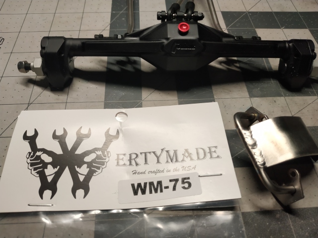

I received this small but expensive part: $35 USD for this little skid plate, WTF wertymade!
I don't know if it will act against performance but at least, it will provide some protection against scratches on the rear axle
Wertymade Vanquish Currie F9 Rear Skid Plate
The skid bolts on to the F9 Portal rear axle but the part that I receive just don't fit, it has some solder residues and requires some Dremel work to make it fit. I didn't expect that for such an expensive part but I don't want to deal with returns so I will keep that
I wrote to vpsupport@vanquishproducts.com explaining the situation, to see if they can help me. I had found that most of the time companies do not support to international customers, let's see what they will comment about it, I don't know if they can Help me because I ordered these parts at amain hobbies and RPP hobbies

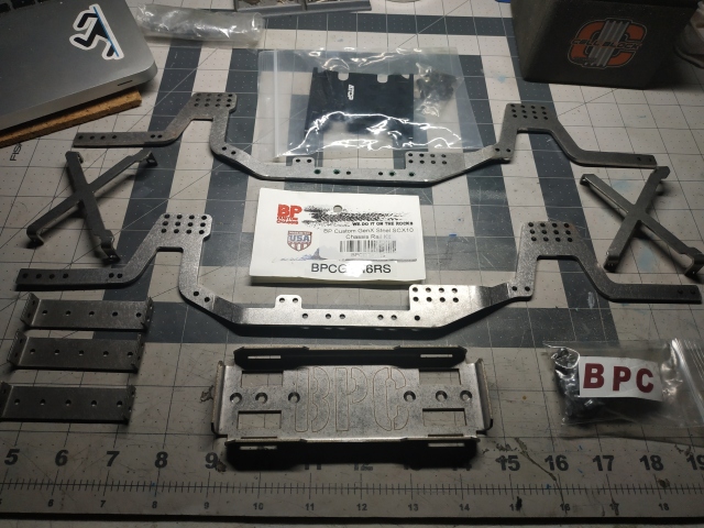

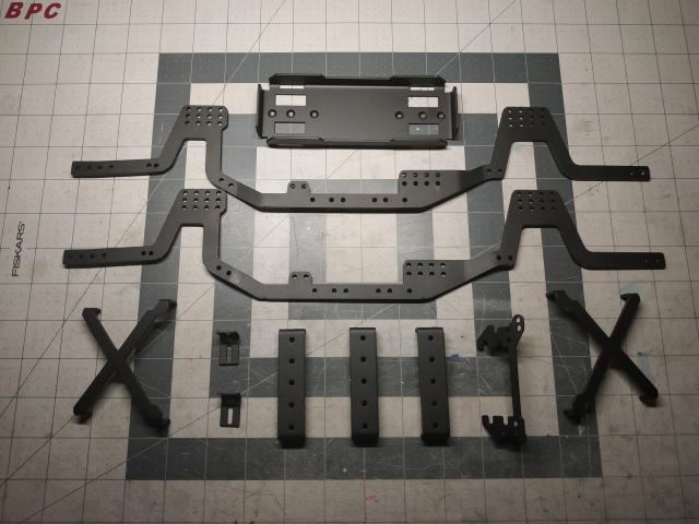

Initially, I like the raw material appearance on my chassis but the real Unimog that I am trying to replicate have a black chassis, so I found a painting workshop in my city that could help me with the powder coating
4 usd later this is the result
great looking chassis, ready for scratches
Some electronics still on the way but now that I have the chassis ready I can continue with the building

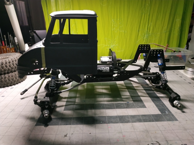

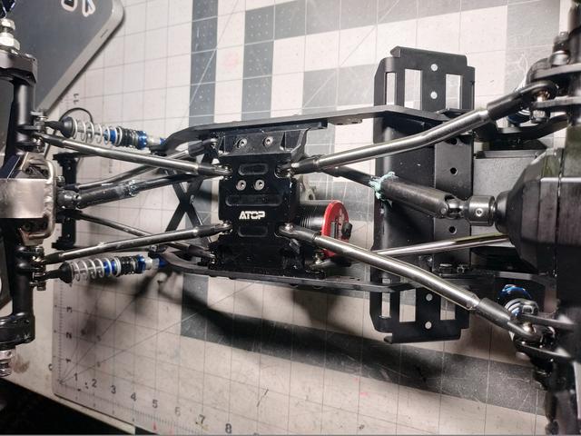

After assembly I notice that the geometry looks kind of weird, links seem a little bit long for the chassis
If I compare the shock position on this build with the usual SCX10II geometry is easy to notice that the shock are not perpendicular to chassis and wheelbase looks a little fit offset. that offset is more evident in the back than in the font
The difference in geometry is also noticeable if I compare this chassis next to my other rig
I don't know how it will affect the performance but now I am not sure if I should continue the building with the actual 313mm (12.3 in) wheelbase or order new links for a shorter wheelbase
According to PBC staff, this chassis should work from 11.5 inches to 12.5 inches wheelbase but in my opinion, the actual 12.3 wheelbase looks long,
Using the length of the actual links I have to mount the cab at the very front of the chassis to make it fit.
What do you think?

Loving your build so far. I don’t think the long wheelbase would be a problem. A lot of people prefer a ~12” wheelbase. It makes you more stable but you will have less maneuverability. You will also drag your center skid more since the axles are further apart. Since you have a shorter wheelbase truck already it’d probably be interesting to have one a good bit longer. It’ll give you something different to drive.
As for the hubs I’ve never tried such a thing so I can’t offer feedback. Drilling aluminum shouldn’t be too terribly hard. Just take your time and make extra sure you have everything lined up perfectly.

to be honest I'm not totally comfortable about how the current link-shock-axle geometry looks, in my opinion, there are 3 mistakes
1) wheelbase should be a little bit shorter 12.0 would be ideal;
2) the front shocks look too inclined, similar builds have the front shock in a vertical position. maybe I need shorter links because using the current length I have to mount the body cab at the very front of the chassis
3) axles alignment is different front and back, the front one looks more inclines
I don't know if these details are important or not I just want to mount the body a little bit back

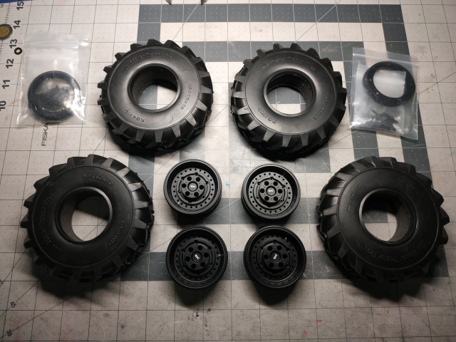

But I receive another parcel, also from amain hobbies, (I love when my friend the postman knocks the door) Some tires for my unimog
I realize that KLR/M tires are not the ideal for this project so I will pair that with SMW beadlocks and left it as spare for my rigs
I found some tires really similar to the ones used on the real Unimog that I am using as an inspiration RC4WD Mud Bashers
so let's mount it on Team DC Armory Version Beadlocks
I will use the Voodoo True 3 Stage Foams
38 little screws per wheel, so 152 screws later ...
I love the klr-m on my mog do excellent
I finally received the foams for my KLR/M's
I also ordered the Superstition Machine Works 1.9 wheels, I'm not sure if I want to use it on my Unimog o maybe keep these tires as spare for my Truggy
Easy to install beadlock wheels

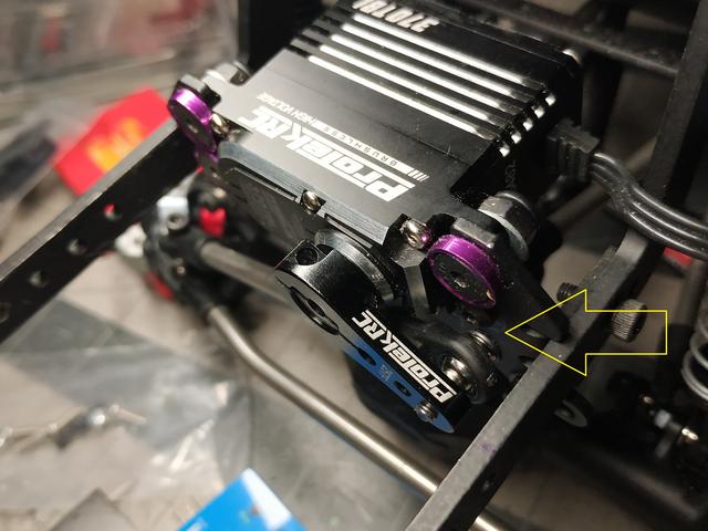

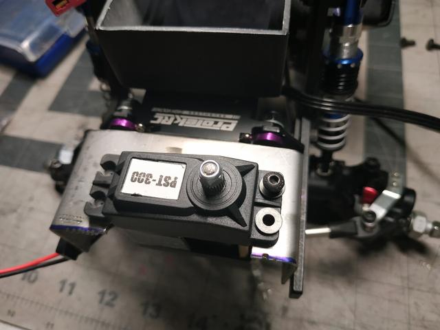

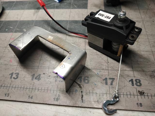

In the other hand and regarding the winch for this project, Initially, I ordered the HeyOK Servo Winch (3-Position) at rpphobby.com that was the last June 17th but the package still in transit, so I am afraid it is lost, I hope they support me otherwise I will have lost 100 dollars for that order
Tired of waiting I decide to spend again to buy another winch, so after some research, I found the Powershift Rc Technologies PST-300 servo winch, I notice that teamknkhardware.com offers very competitive international shipping rates so I ordered the winch there, surprisingly only 14 days later I received that winch,
Here is my driver showing the new parts

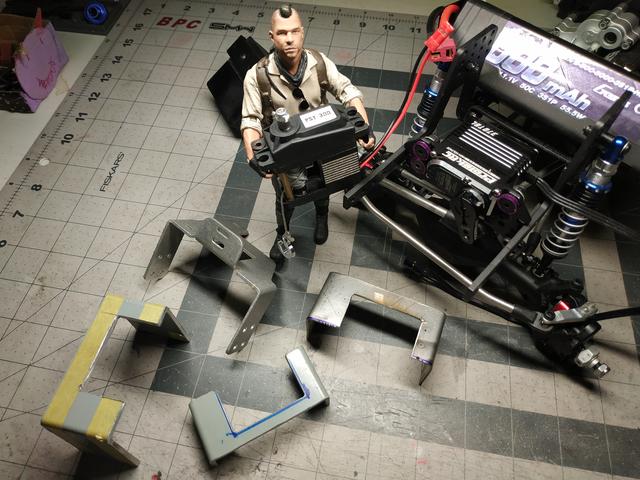

Initially I ordered the BPC servo winch mount but I realize that it was impossible to find a servo mount that works specifically for this project so I decide to make one. Scratch building time!
I went to home depot and got an Electrical outlet box, I cut it out to make a couple of prototypes that do not work
Then I found a steel plate in the garbage so I bend it cut it to make the servo-winch mount, I take a lot of measures to make it fit, space for clearance is very tight

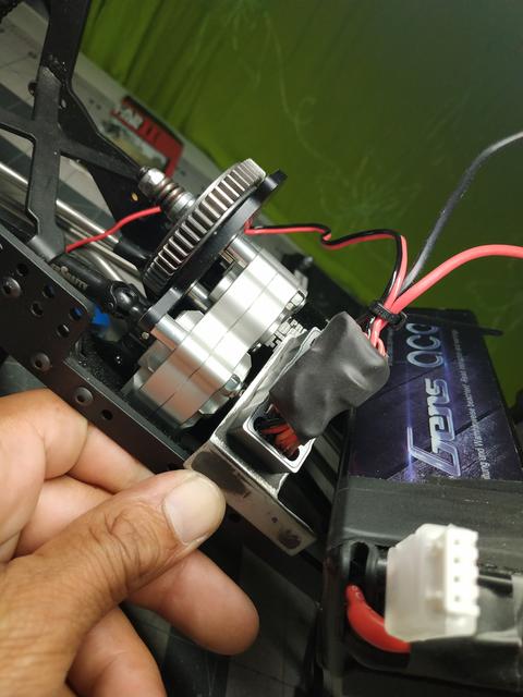

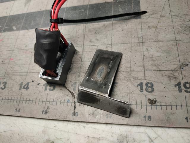

I also build a little plate to mount the BEC. next step is to make the holes for M3 screws I don´t have a bench drill just a cheap black and decker drill so I have to do my best to make precise holes. I Hope not to mess it up
Finally, I make a styrene receiver box for my electronics, I have to fit in the receiver, the lights controller and the winch controller, and some servo wires I also have to use the balloon method for waterproofing so I am afraid that this box will be a little bit small, maybe I have to build another
Now that I have all the electronics the next step will be the wiring. I also have to paint and install the custom made parts.

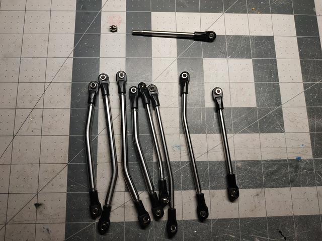

After 97 days I finally received the steel links for this project. I really hate the service of "Correos de mexico"
Those are by far the most expensive parts ordered for this project, custom links $142.45 +33.60 shipping + $25 USD taxes = $201.05 usd
I almost feel stupid for paying so much
This is what I received:
During rod ends installation I notice a missing rod end. super expensive parts and I receive it incompleted:x, fortunately, I have some spares in my toolbox
High clearance links installed, using these links, the wheelbase for my project is now settled, so I can continue with the building
