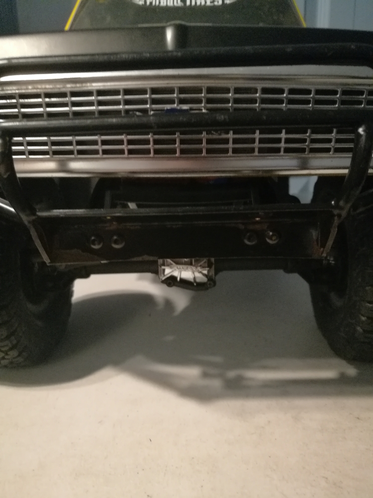

Up next I think it is time to raise up And tuck in the front bumper. Since I just need enough room for a small lightbar on the bumper. Body is low as as it gets.

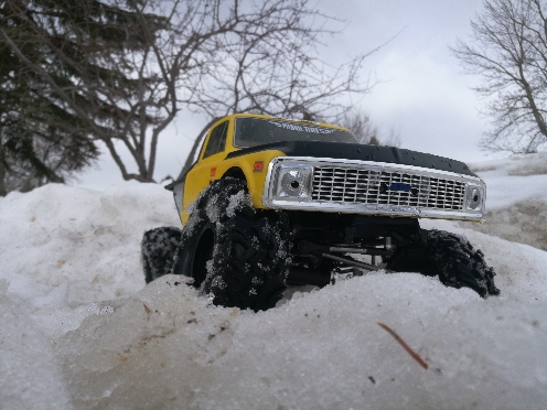

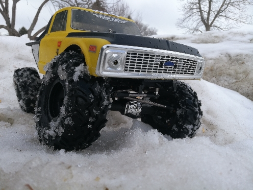

Ill be testing it on the melting windrows of snow tomorrow. What pinion gear our you using and what battery voltage? Motor has at least 100km on it from my trx4 so its well broken in as well. liked its performance in the trx but since it went brushless the K10 will reuse the brushed motor. And it woke up the truck alot!
