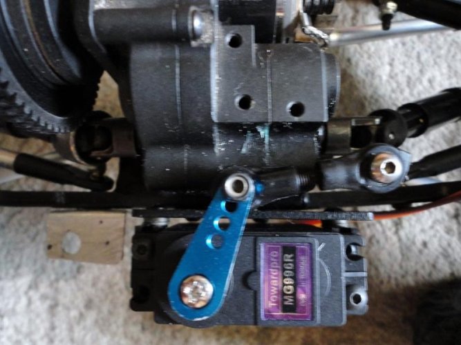

I'm running a Hitec 65mg mini servo underneath and so far it's held up to hundreds of shifts. I think it was $24.99
Here's my alternate setup which leaves room for the battery crossways on the chassis just in front of the trans. After some "hit or miss" shifting issues, I put a thin slice of fuel tubing under the ballends to eliminate side to side movement. I used an Axial axle mount servo plate bolted to the frame.
