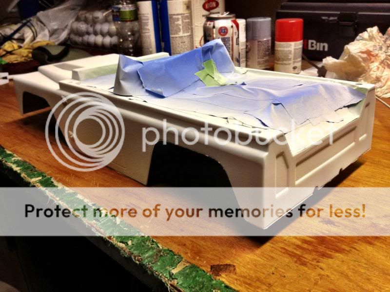

Whats up dudes? Time for an update.
I sprayed the inside with grey. After the fact,
I think black may have been a better idea, oh well.
Also did the piggybacks on the shocks in white,
and the light covers on the front bumper as well.
I then laid down the white...
And then the red...
There are prolly better ways to achieve these results, but not too bad for my first time. Heres the mocked up pics.

Please feel free to constructively criticize. Im sure there is plenty i can improve on.
