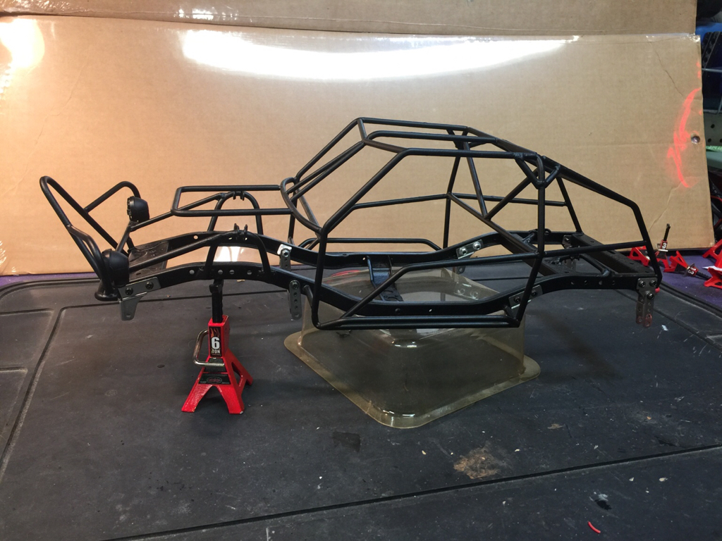

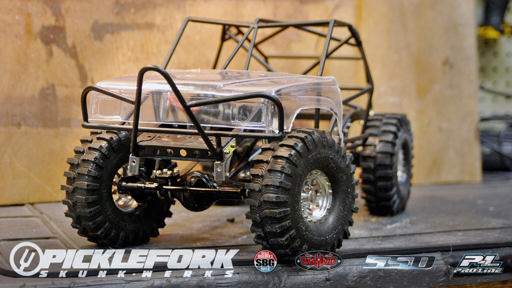

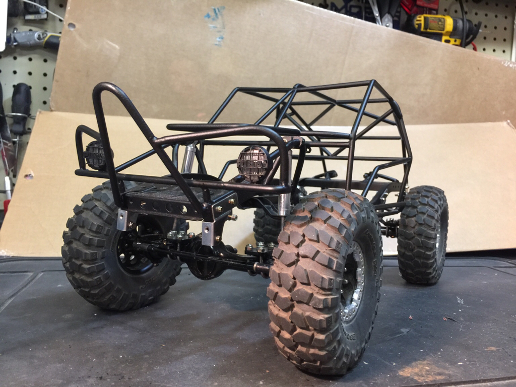

It showed up at the PickleFork like this.

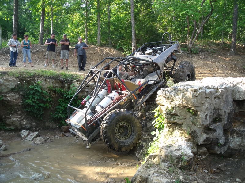

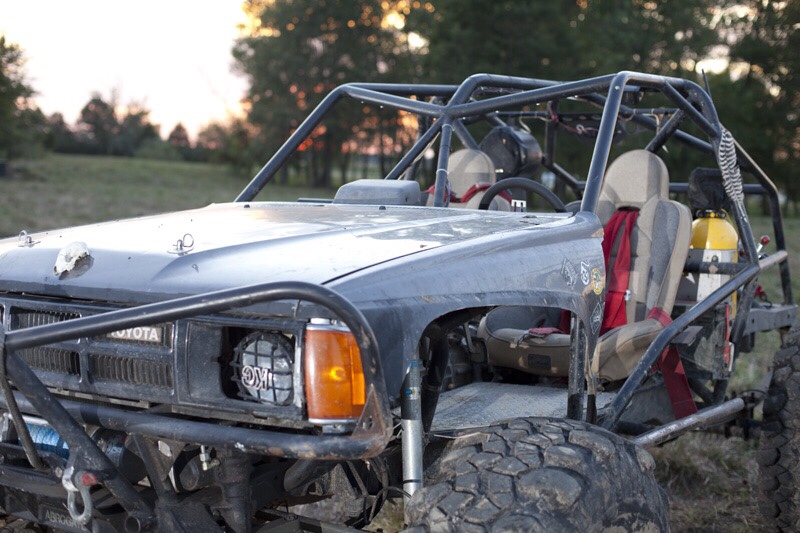

It's a leaf sprung chassis built by Mattzilla replicating this 1:1 Toyota based rig.
Yep that's the one. The original builder (not the guy I bought it from) referred to it as a "birth of a cruiser" which is the title of the thread on pirate 4x4 which is actually the death of this rig.
This rig's pirate 4x4 thread is titled "My Pile of Junk Progress" ( https://r.tapatalk.com/shareLink?ur...&share_tid=392507&share_fid=4267&share_type=t )
So that is what I intend to build: a really sick pile of junk.

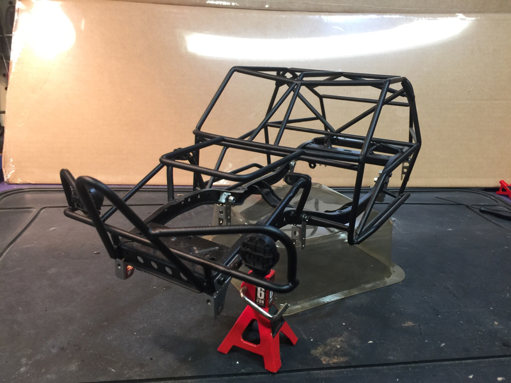

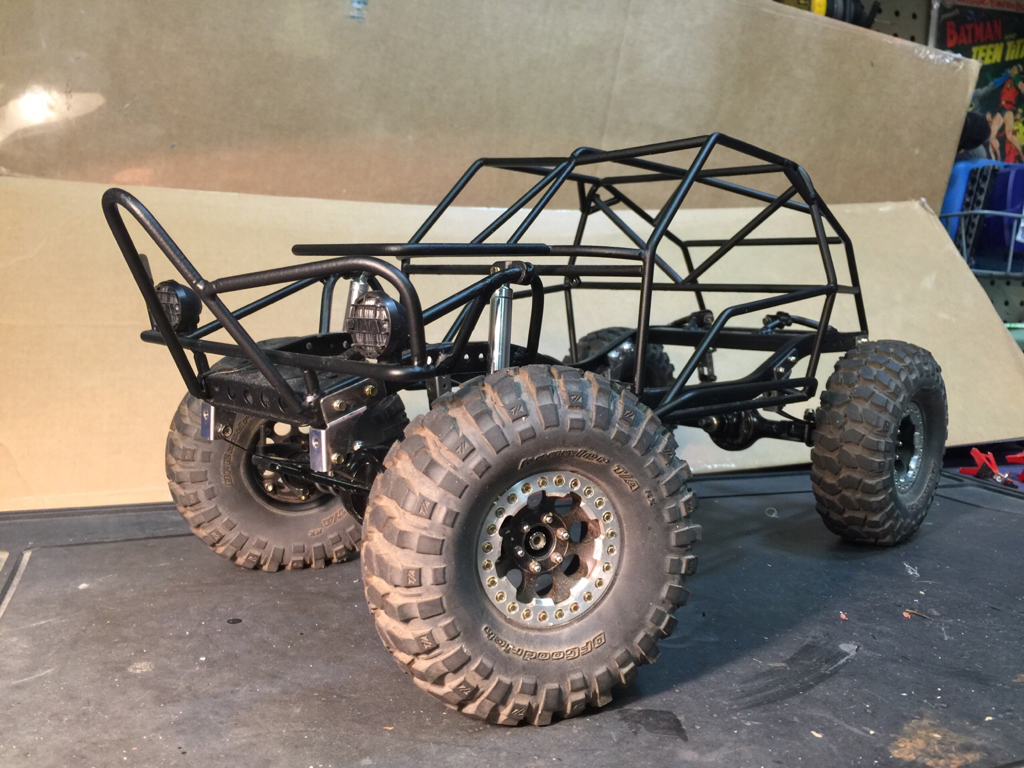

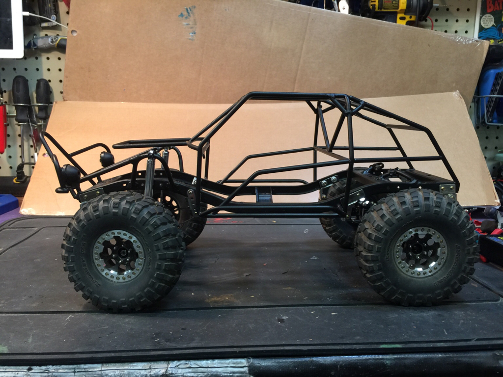

The chassis is very well constructed, as we'd expect from MZ. Having read the original build thread I have ideas for how to deal with most of the hurdles.
First tires: RC4WD 1.7 sipped boggers
Yes I know, wrong type of tire. But I didn't want to go to a 1.9 rim, and I am going to take a few creative liberties with this build, as if it didn't get chopped up and still exists. Besides, y'all know me, I'll most likely have more than one set for this truck.
That's a little low
Better, closer, warmer.

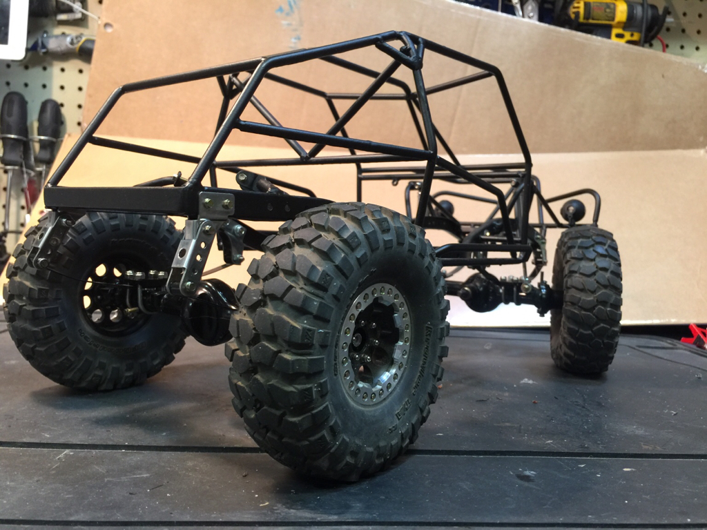

Ok, at this point I learned something, bruisers (which this is based on) have a wider rear than a TF2, and the standard yota rear axle isn't ideal.
After a panicked message to 1BJB he pointed me to toward RC4WD for a bruiseruptor rear axle which is on the way.

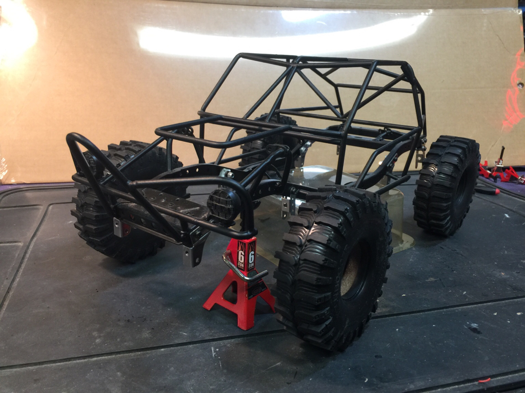

Now back to mock up...

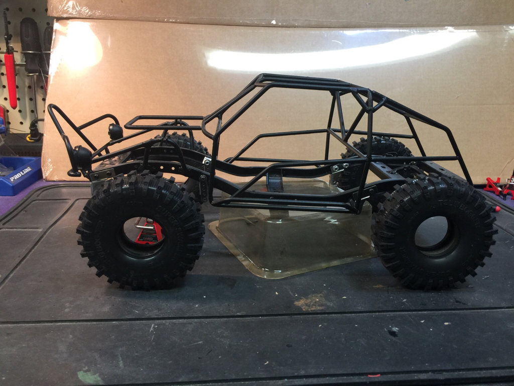

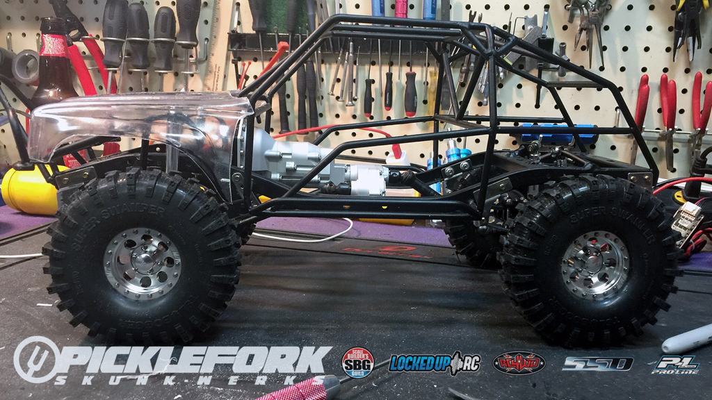

Borrowing a set of 1.9s from the truggy and popping the yota axles under it and we're looking pretty good.
This chassis is difficult to photograph and have it look as good as it does in person. When it's in front of you, it's stunning. Somehow it's just tough to capture it.
Anyway here's a few other angles.

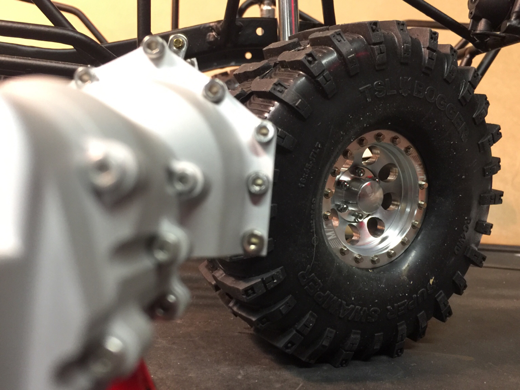

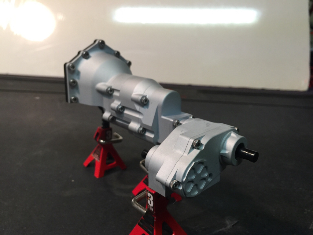

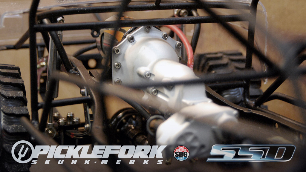

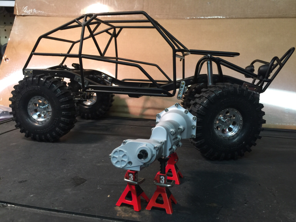

Yes sir, the SSD trans. Now if it hadn't been for the Black Friday deal at RPP I would've gone with tbt GCM version. I'm sure I'll end up there but this will get me going.
Oh yeah the wheels...
Had to go with the RC4WD 1.7 Mickey Thompson. Love these wheels. I'll most likely have these powder coated/painted flat black to look like the 1:1.
I love how they look raw though.

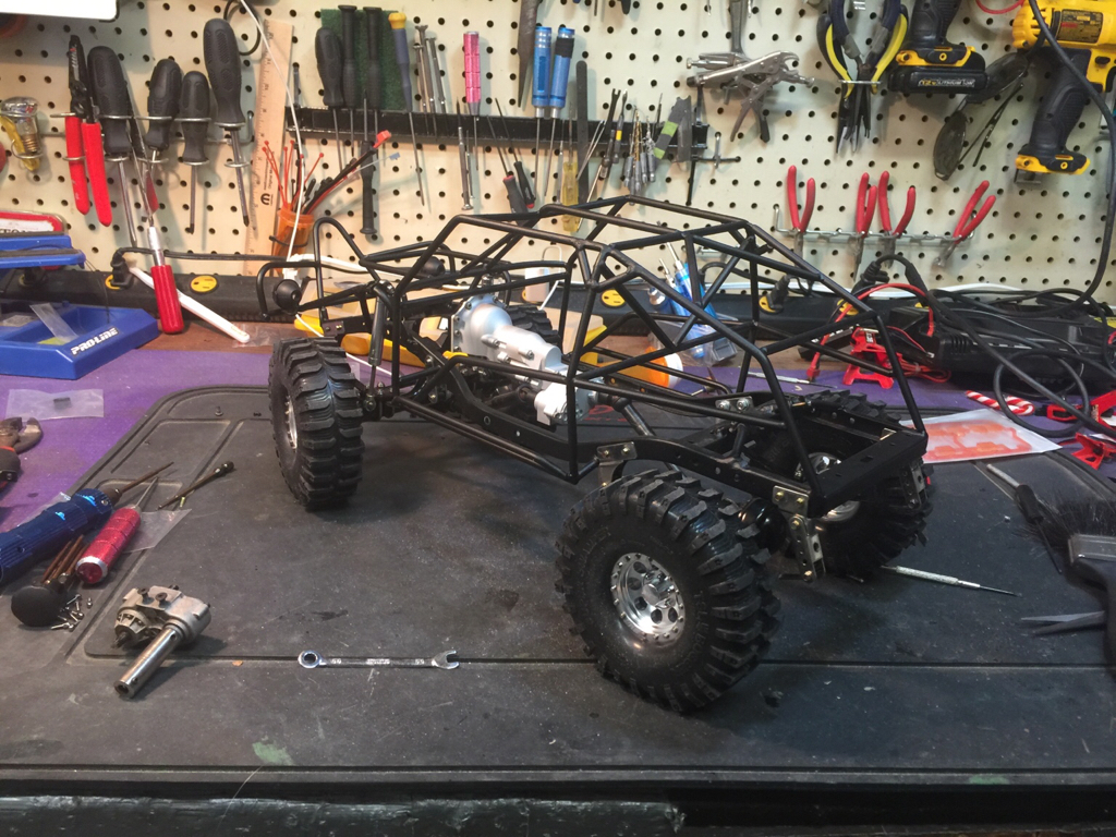

Of course you've gotta throw the trans in there and see how it looks!
Oh yeah that's a good step in the right direction!
Ok that's where I am so far. My plan is to make it run, stop and turn; then I'll worry about the rest of it.

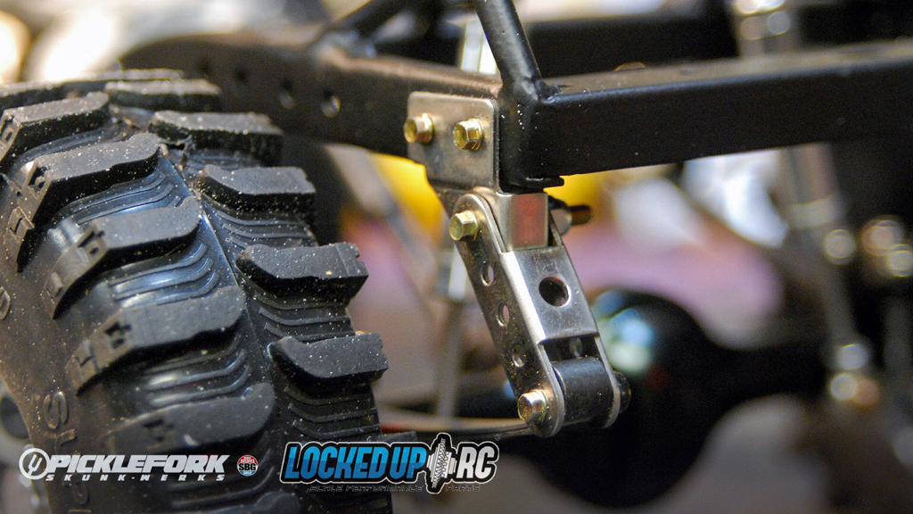

What kit did rob the shackle and mounts from....
I'm in need of some..
Subbed
Sent from my SM-G900V using Tapatalk
And then...
Sorry for the delay, update below.
Very nice so far.I like that your using scale nuts and bolts....
Going to look awesome once done.
They are bruiser hangers and swing mounts. I also have switched over to Chino's Mil wrapped leaf springs.

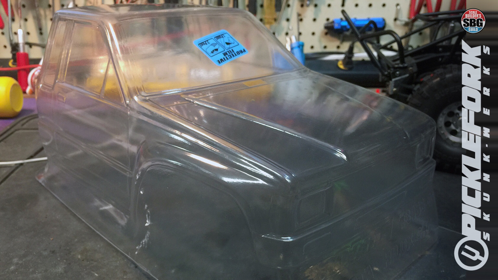

So after studying the pics of the 1:1, and then seeing Toykid's new grille for the Proline SR5 cab I knew which route I wanted to try for the flimsy sheetmetal... So I ordered a SR5 cab.
You can see how flimsy the fenders are on the 1:1
So what do we do with new parts? Chop them up!!
I'm going to have to section the hood to have it all fit properly, but I'll wait until I have the grille to do that. FYI the 1:1 has a sectioned hood as well.

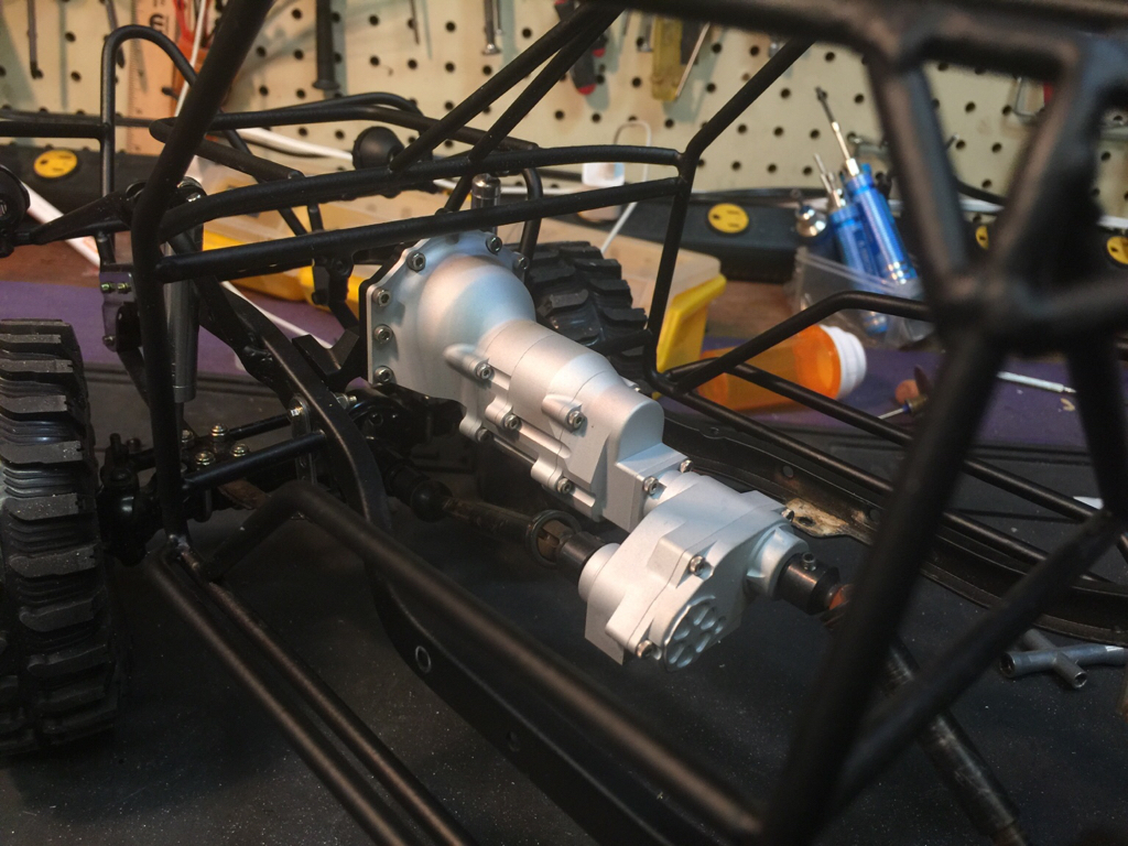

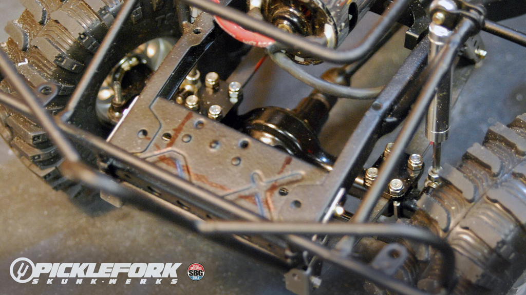

I also installed the motor into the trans.

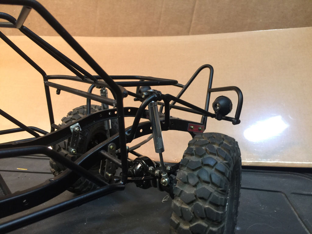

I then played with some steering servo mounting locations... anybody have a reason why I shouldn't cut this part and mount it here?
I know that some have mounted the servo under that cross brace but I'm not sure I want it showing so much out the front.
Any input on bruiser steering, mods or even better remote steering servo locations, etc is welcome.

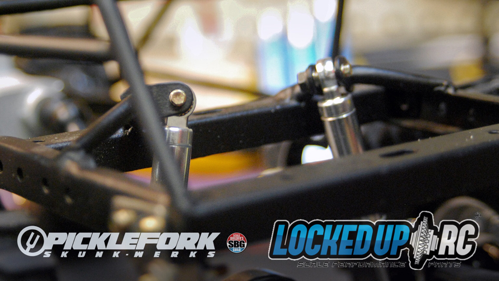

I added some scale hardware from LockedUp and snapped some pics for fun.

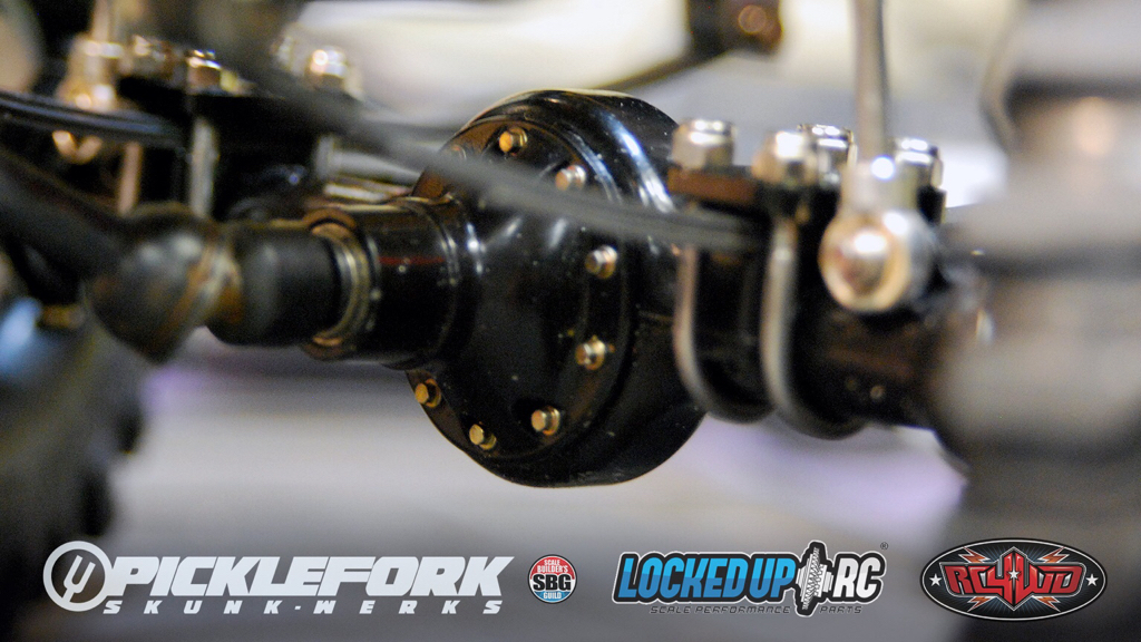

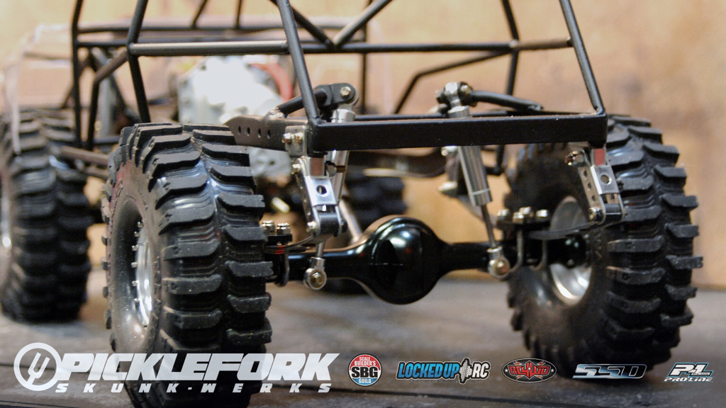

I almost forgot... I got the bruiseruptor axle installed and added some hardware while I was at it. Soooooooo sexy.

I also need to make mounts which will actually hold the trans. Right now it's only bolted in on one side up front, and nothing by the Tcase.

I’m glad another respected member bought this thing with the possibility of making it come alive. It deserves it. I’m the original owner that gave Mattzilla the challenge. He went wayyyy above and beyond to make this chassis look as close as possible. Only thing I added in were the shock mounts and some of the scale accessories. I also had built narrowed Wraith axles with metal tubes and leaf spring perched but I don’t know where those went off to.
As far as the title, this project started maybe late 2015-2016? And at the time on Pirate, it was named “Birth of a Cruiser”. Haven’t followed up on the thread to see that he renamed it. If you need any questions answered, let me know!
** On the steering, the two holes that were drilled into the front plate were to accept servo mounts. Any standard servi can tuck up out of the way underneath that front plate.
