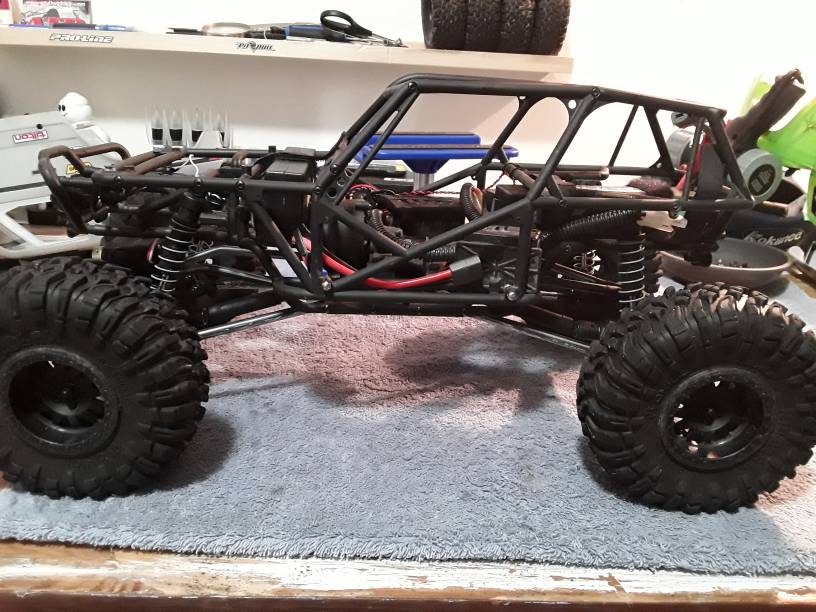

I did mine this past week. Took the stock battery tray out of the back, trimmed a bit and put it in front of the firewall. Removed the received from the box (and removed the box), then waterproofed the rx. I took the mount panel off the back of the stock Spawn ESC and superglued it where the box was, on the angled section. Then double taped the ESC to the panel, and the rx above that. Worked out well for me.
full
I did clean up the wiring a bit after this pic.
Battery forward makes a big difference for me when climbing.
