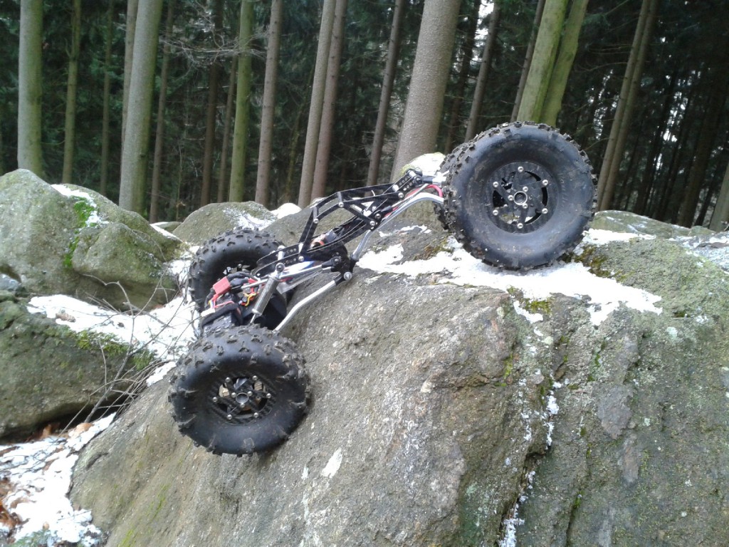

I got new dampers.Never had a problem with my bigbores,they work excellent,but now they will get into my shafty.And new upperlinks.The carbonlinks broke one day,perhaps at a crash on the rocks.Now i build 3mm Titan-links with nearly the same weight (4g to 6g).So i think the Bully is ready for season 2015

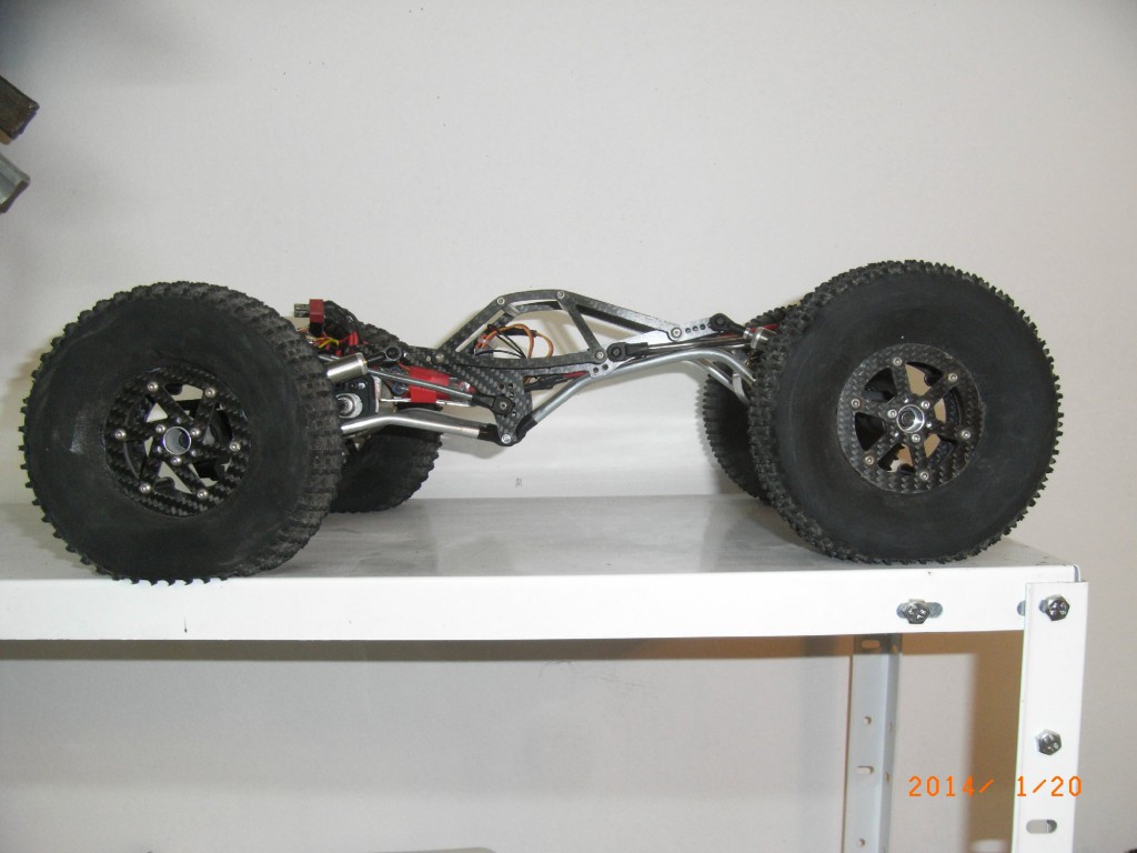

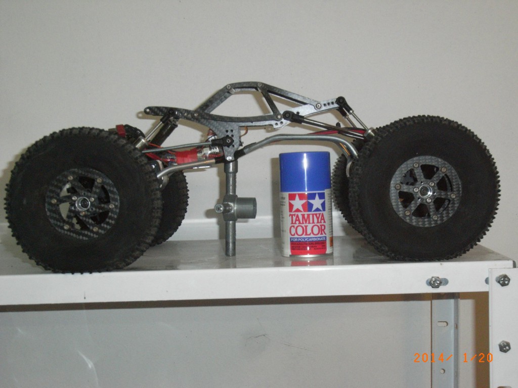

Nice looking rig. I like the pile of weight up front too. Looking at the pictures it looks like the skid has been removed and the rear lowers taken up front to the same attachment point as the front lowers like the stingray. I noticed that it seems to be a trend for the Supercrawl guys to run really long lower rear links. I wonder what the advantages and disadvantages are over a more conventional setup?
@josh6575
You´re right,it looks like there´s no skid,but it´s still there:
At the remedy chassis you can position the skid like you want to,and so i did it to get the most ground clearance.I think it´s easier when you drive about big edges (i believe you call it breakovers?)
A year ago i modified a chassis to the "Egressor-Style",without skid to get a maximum on clearance and droop setup to go low:
This thing works good,but then i noticed that the clearance is nearly the same (especially when it´s rebounded) when the skid is short and goes back up.And so i can use shorter links which makes the crawler more stable
Perhaps the best way for much ground clearance is like pat13 did it with his Ventru chassis: ultra-short front lowers just behind the motor and then much clearance until the rear axle "thumbsup"

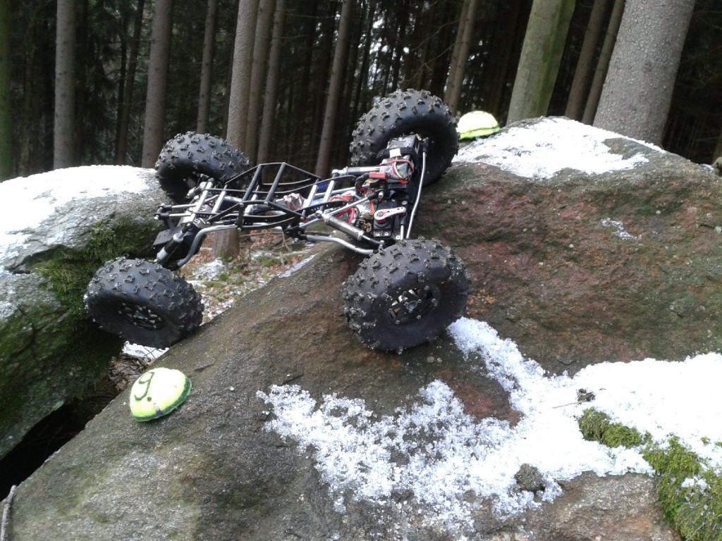

I did some modifications on my bully.I never really liked the battery-position,it´s pretty high and not so good for the COG.And additionally the steering link is in front of the axle.So i did some test runs with the battery on the rear axle,no problem with bully2s "thumbsup"
It works really good for me and i decided to change it
I tried some hard gates but didn´t notice a difference.I think it´s because of those much KW in front of my crawler,the balance is still far in front.And in some situations it´s not bad to have some extraweight on the rear axle ;-)
But the bigger advantage is that i´ve now the maximum clearance in front of my axle:
