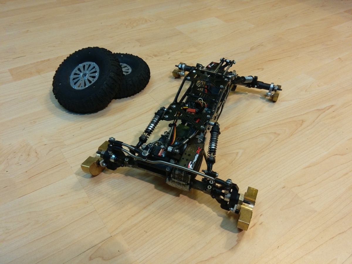

So time to mount my rear from Robbob.At first i assembled all the bearings and drive shaft.Everything fits perfect,great job Bob "thumbsup" The smallest bearings (5x9x3) are not needed because the small gears are also kept off!
Then i put it to my chassis,lower links are matching,the same with the shocks only the upper links have to become a little bit longer (perhaps with longer rodends but i will built straight new ones)
So here are pics BEFORE i changed the axle:
Weight 2400g (5,29lb)
Balancepoint and antisquat:
and here are pics AFTER i switched to the new rear axle
Balance and AS are still the same:
and the big difference is the weight :shock:
1744g (3,85lb) without Lipo is a big difference!! But with a light rear axle it´s possible to save a lot of weight for the the same balance.So i reduced my knuckleweights and also changed to the light skinny rovers with soft foams.
A first test on the rocks feels new to me,very nimble and agile,i love it from the first lipo "thumbsup" To drive over ledges it´s exactly what i´ve expected,it´s definitely easier because of the smaller gearbox!
