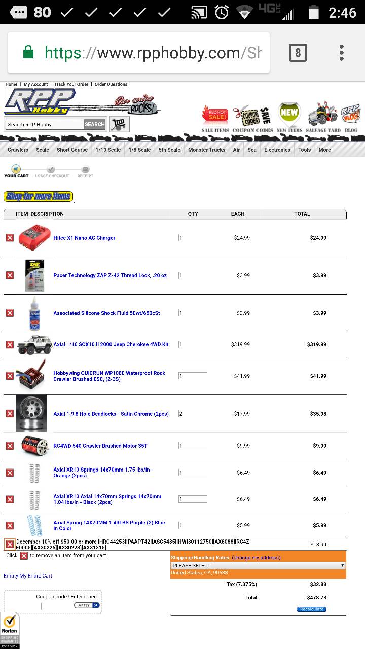

Here's what I'd get and where I'd get it:
$2 UBEC 6v 3a - eBay
$12 6621 or mg958 20kg servo - Banggood
$7 Turnigy 3s lipo 2200mah (anything bigger and the high COG will make the rig tipsy) - Hobbyking
$45 gt3c TX & RX with lipo battery - eBay
$60 Traxxas 4962 (qty 8 of 100mm eye-to-eye leak-free shocks; best shocks and best deal on them; other options are 2660=83mm, 2661=93mm, 2662=100mm) - eBay
... and the rest from RCCrawler-sponsor RPPhobby:
Updates: if you get the shocks then you can remove the extra shock oil from RPP since they'll come with silicone oil. ;) Also, if you'd prefer the newer Wrangler body, it comes painted red in RTR form at RPP:
http://www.rpphobby.com/product_p/ax90060.htm
https://uploads.tapatalk-cdn.com/20171211/aaab27342624006180edaf57a5c67e70.jpg[IMG]
[url=http://www.rpphobby.com/product_p/ax90060.htm]Axial SCX10 II 2017 Jeep Wrangler Unlimited JK CRC 4WD RTR[/url][/QUOTE]
Dude - quite the comprehensive list. Thank you for taking the time to do this! I am looking thru all of the stuff in here, and it looks like you've nailed everything!
Thanks. I forgot to mention that some Double Deuce foams*would help the BFG tires perform better, but eventually you'll probably end up with Proline Hyrax tires like so many others. I make my own dual layer foams out of carpet padding and cushion foam for my Ripsaws 'cuz ima cheapskate. =P
Update: grab yourself some plastic beadlocks for $15 on eBay or $35 for Axial on RPP. Ungluing tires stinks. ;)
