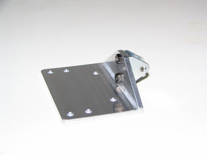

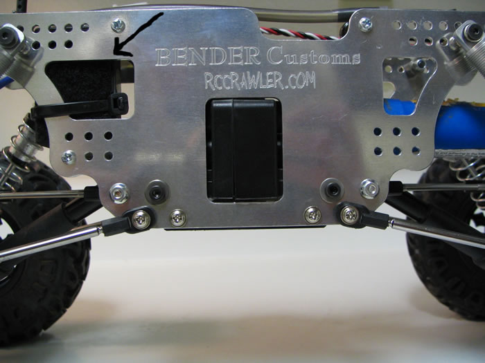

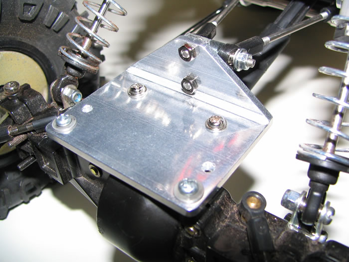

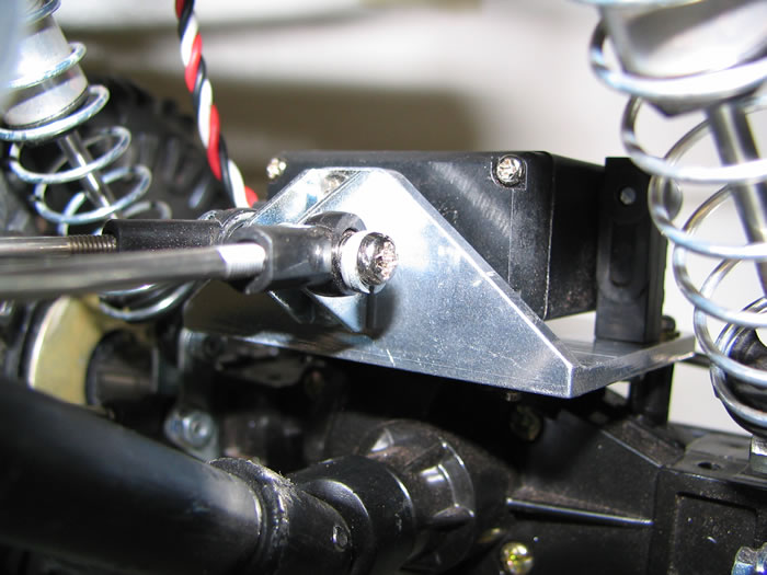

New and improved link mounts and tranny skid!!
I just want to give everyone a heads up, I've made a few changes from my original prototype, to the production version.
1. I made the Delrin tranny skid a little longer then my original. I also radiused the front and back edge of the skid, instead of a chamfer. I forgot to mention in the first post, the Delrin tranny skid is designed to hang below the chassis side plates. This will help eliminate getting hung up on the aluminum chassis, and getting high centered.
2. I changed the link mounts too. They are tumbled and burnished now, so they match the chassis. I also machined some of the access material off the back to give them a cleaner look.
ALL chassis' include these changes, even the ones that have shipped. I just got around to taking/posting the pics. ;-)
Thanks

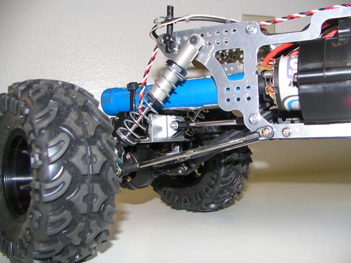

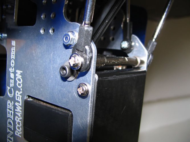

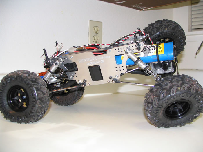

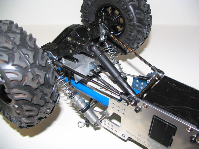

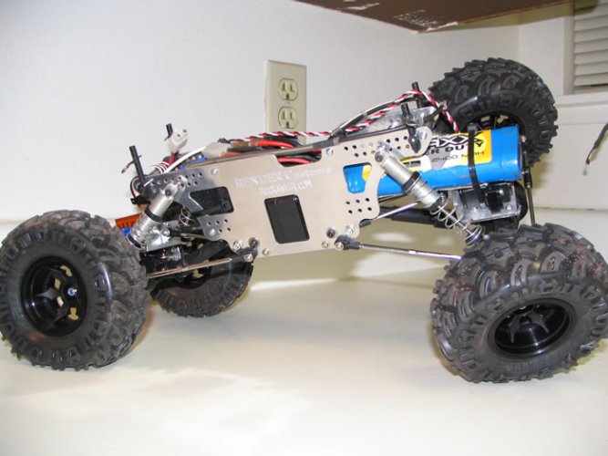

Hey Bender, how do your electronics fit in there? I couldn't figure out how you mount your battery? A pic with your electronics setup in it would be nice. Thanx
Jake
Bender, the changes look great. I love the look of the links now. Can't wait to see it in the mail. Thanks for an awesome product.
Jake
Here are a few pics Jake, I mounted the ESC on the rear link mount plate. The reciever is just zip tied to the chassis, the battery is zip tied to the steering servo.
