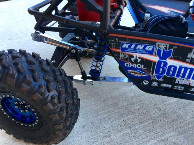

I have the DLux sway on my crawler build with the smallest diameter bar. It is very soft and allows much more flex than the VP setup on my go fast build. I'm really happy with the way the DLux bar performs on my crawler. I actually moved the links to the middle hole to dial in more stiffness because it was too soft initially.

I have the DLux universal sway bar. I really like it. I have it on the softest setting, so you don't even notice it when crawling. It does a great job of eliminating the torque twist also. On full throttle in second gear you can tell the front driver side wants to raise, so I might play around with moving the end links one hole in.
If the end links are cut to the correct length, there is no interference at all at full bump from the sway bar ends, and the only minor issue is the contact at full bump on the rear axle housing. This really isn't a big deal to me because the stock upper link bolt hits at the same time anyways.
