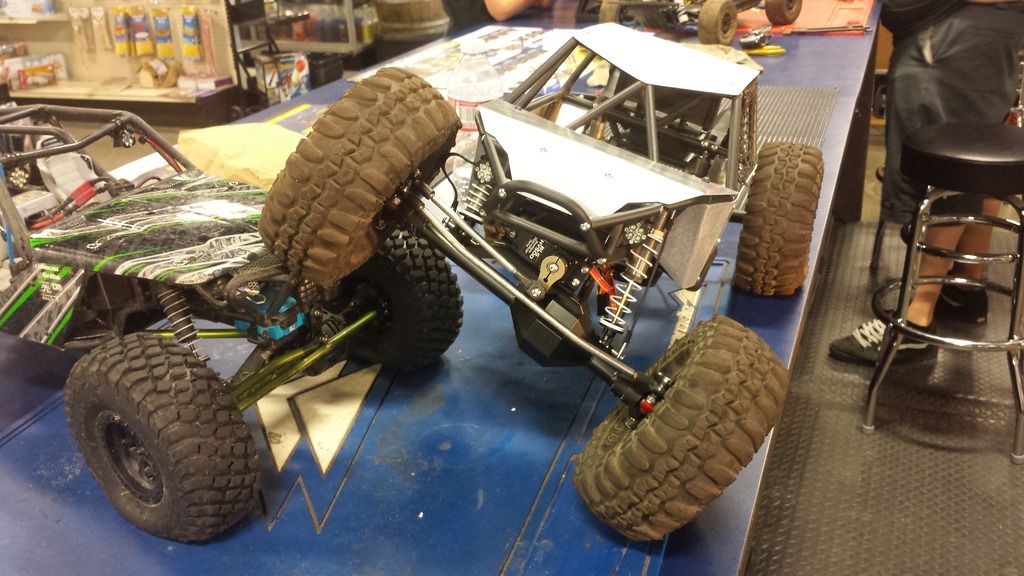

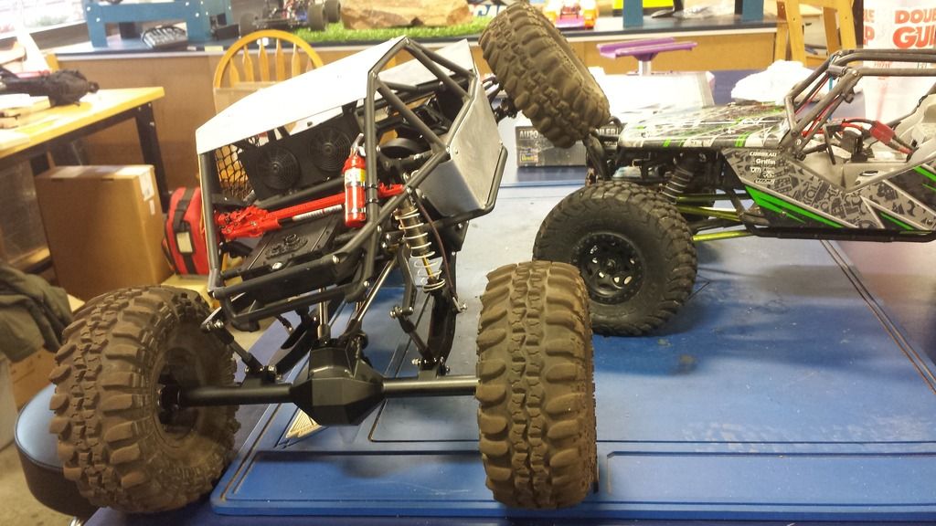

How much flex are you looking for? Here is mine with VP sway bar. Im happy with the amount it has but I haven't tested it yet. A ton of flex isn't always a good thing.
Downtown,
The sway bar is good for crawling because it helps keep the front tires planted. Otherwise the back end has a tendency to squat too much in some cases and you lose traction in the front or create a situation where the rig will want to flip over backwards. Thus the different stiffness/types of bars are good for different things. The Axial bar is great for what you described. Modifying it by notching it or going with a softer bar like Dlux or maybe VP from the sound of things may be better for crawling.
You will notice that some 1:1 crawling jeeps have the Currie Antirock sway bar that the VP version is based on mounted at the back ends.

Excellent picture for reference with the VP set-up. Thanks
So, the trick is finding the set-up that works with your build and desired driving style. With the various ideas and options, this is why I thought this thread might have some value. Knowing what I do now, I would have gone for the Dlux or VP for my build instead of modifying an Axial.

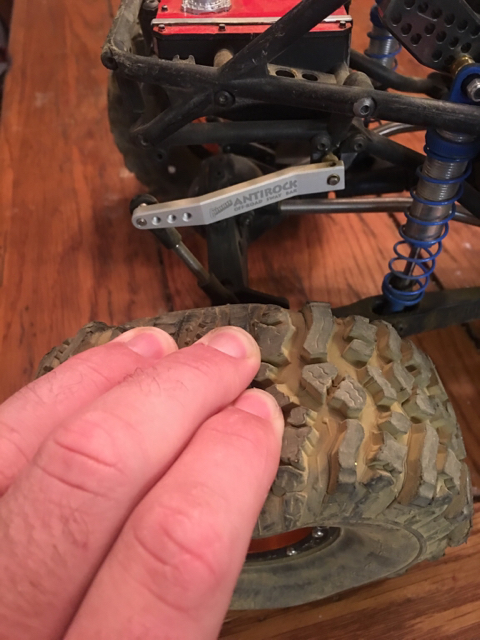

I am about to go to twin hammer length arms on mine and I already have the anti-rock. It looks like you still have your sway bar mounted in front of the rear axle. I was thinking I would move it to the rear so I could mount the links to the longest part of the sway bar "arm" so it could put more torque into turning the torsion spring. Possibly a little more flex.
Care to post a pic of your sway bar setup with the the arms on?
Its mounted in the front, but I am also using the furthest mount on the sway bar arm. The link comes back at a little angle from the axle but its nothing to significant. The arms I have on right now are stock plastic hammer arms and only have one mounting spot so I didn't have much choice in the location, but it seems to work fine. I'll snap a pic when I get home tonight.
