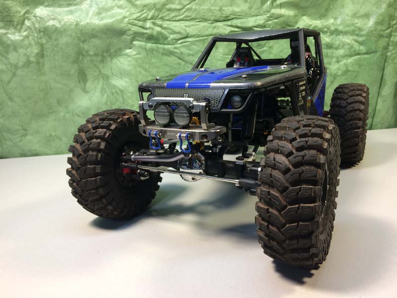

I love this thing, well done. One of my wraiths is tummy tucked with full interior, it does require some creative trimming, but nothing too crazy that’s noticeable wih a driver/passenger.
Thanks, the AX2 trans has the servo on top. it's tight as it is! "thumbsup"

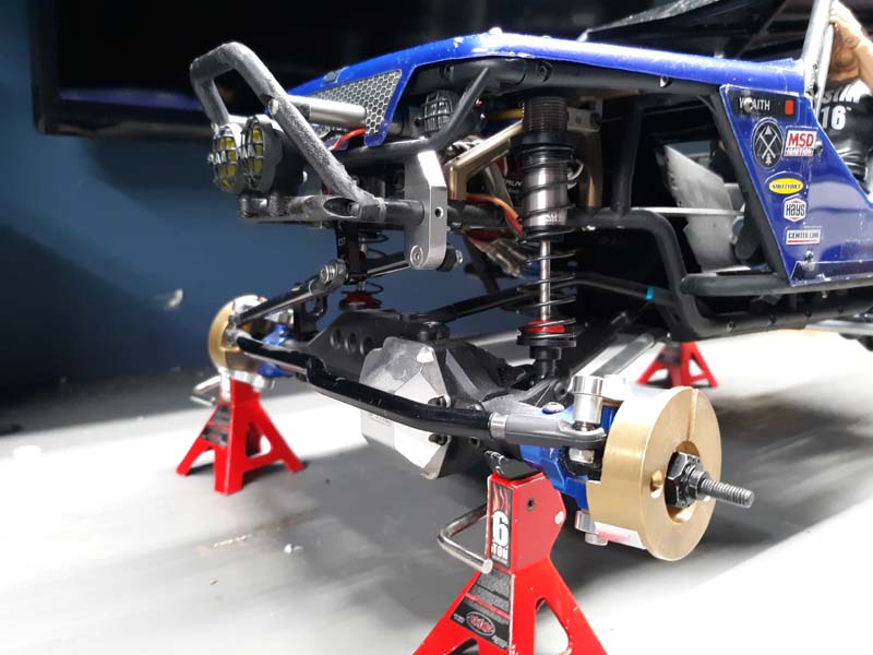

Assuming you are referring to this iteration from the first post?
These are Gmade R1 axles. Stock trans with an outrunner motor. Low speed crawler, and no, never broke a thing. Very rarely do.

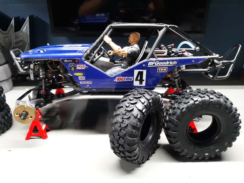

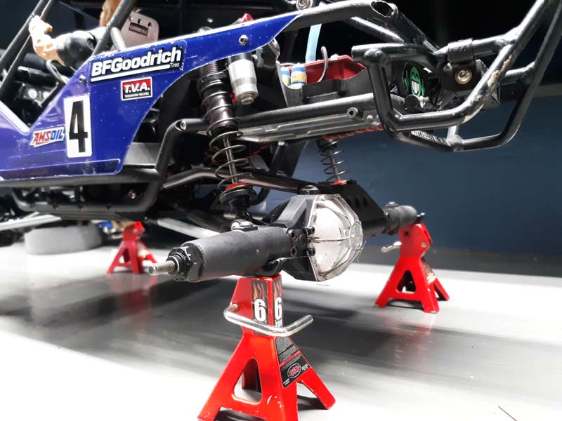

Been tinkering with this thing on and off... Sitting back on AR60's now. Pretty well built axles, OD/UD, Beef tubes, all the goodies. Some big Gmade shocks provide the squish.
AX2 transmission has been replaced with a stock trans w/dig installed. I don't use it much, but after messing with the Capra, I thought it was a nice feature to have. WB is shorted by about 1.5"

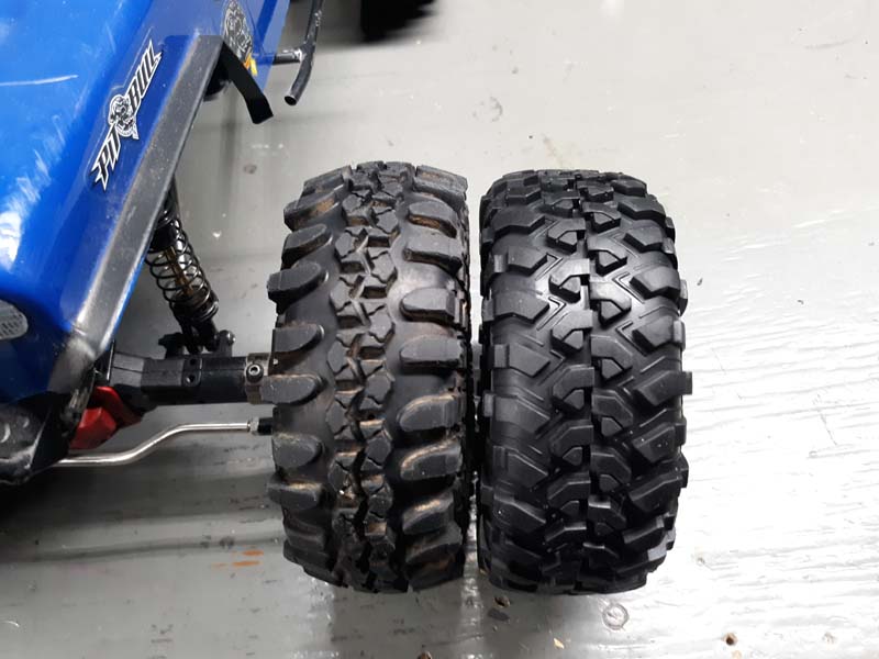

Needed some tires, so I was doing some searching and came across Traxxas 2.2 Canyons for a pretty good deal. Haven't seen these on many rigs, and since my 1.9's were frankly excellent tires, I thought I'd give them a shot. I'll run them first, and then probably trim the center lugs a bit since it made a world of difference on the 1.9's.

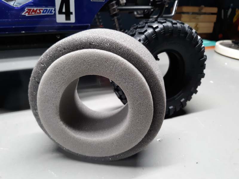

Interestingly, they come with a dual stage foam. Pretty nice ones too. That was a nice suprise... I pulled them out to install some softer CI foams and boom. They'll get used somewhere for sure.
Canyons are a bit smaller than I expected - slightly smaller than on OG Proline TSL. I think they'll be ok though, I think 6" tires look too tall on the Wraith, 5.5 is right in the sweet spot.
