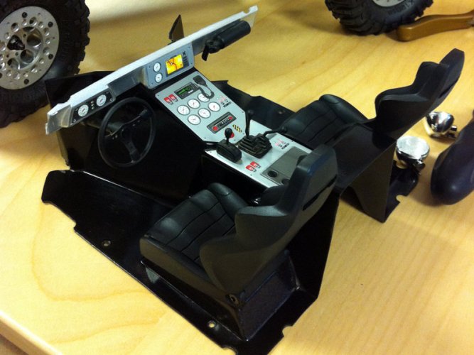

Interior is prepped. Keeping it simple for now, I will add more detail down the road.

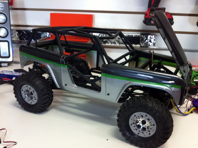

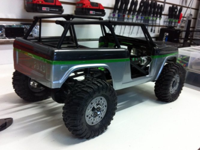

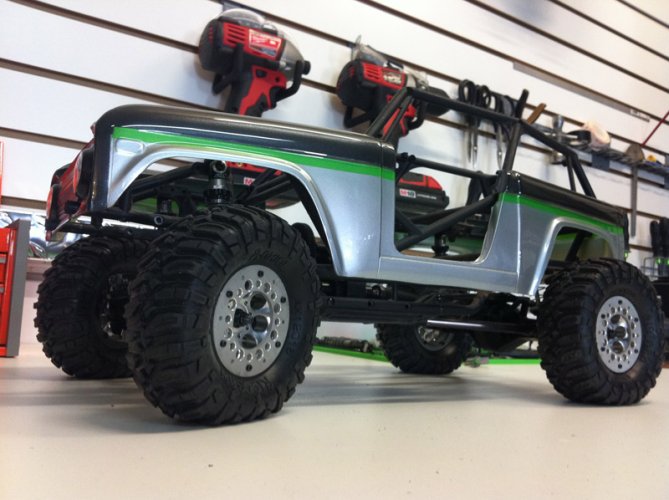

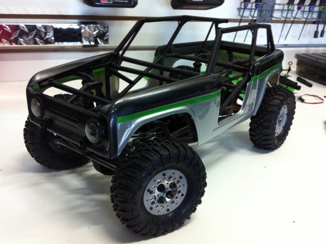

Body is mounted, I'm in love. Has such a unique/scale look "thumbsup"
I need to sort out a front bumper now.

I like the fact you didn't gloss the seats, I think gloss makes them look unrealistic! Good job!
Thanks! Seats are the stock black version used in the Wraith kit, I didn't touch them, but I agree, the black looks the best.

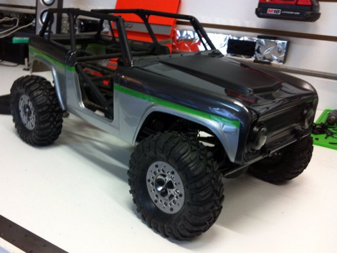

Looks great Brandon. Can wait to see the body go on it.
Its on!
That looks brill, beats the hell out of my scruffy looking bashed up attempt at a SCXWraith combo.
killer....nice change to a wraith..."thumbsup"
nice paint too...
Thanks guys!
Nice paint "thumbsup"
How you will fit a hood on it's place? maybe, hinges?
Yup, its hinged. Still need to adjust it a bit and attached the top of the fenders to the cage so they dont move around. It also snags on the grill a bit so I need to trim a bit more there.

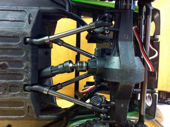

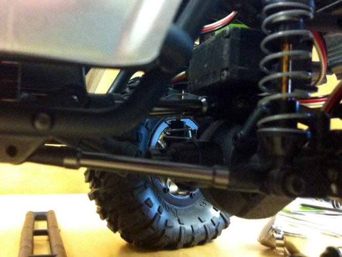

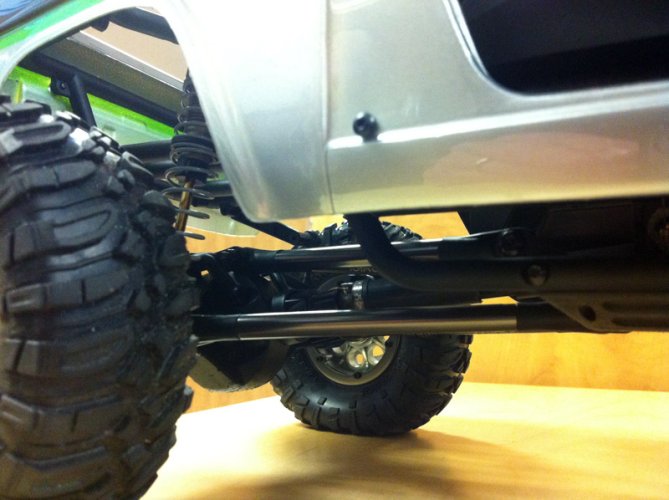

what links are those, honcho? dingo? Incredible build..
Neither. I went through some trial and error to get the wheelbase to match the openings on the body.
Keep in mind the SCX10/AX10 axles have the AX80043 4-Link Axle truss installed.
Front Lower links: AXA1427 50mm posts with AX80005 bent ends on one side, and the short bent AX80057 ends on the other.
Front Upper Links: AXA1427 50mm posts with AX80057 short bent ends on both ends.
Rear upper and lower links: AX30714 7x73 Links with the long bent rod ends from AX80057 on each end.
2X TowerHobbies.com | AXIAXA1427 AXA1427 Axial Post 7x50mm Grey (2)
2X TowerHobbies.com | AXIAX80057 AX80057 Axial Linkage Set XR10
1X TowerHobbies.com | AXIAX80005 AX80005 Axial Linkage Set
2X TowerHobbies.com | AXIAX80043 AX80043 Axial Links Parts Tree RTR SCX10
2X TowerHobbies.com | AXIAX30714 AX30714 Axial Threaded Aluminum Pipe 7x73mm Grey (2)

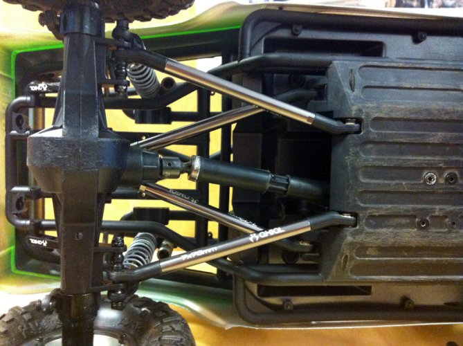

Ill add some pics in a minute.
Detailed pics of the assembled 4 links.

Looking good Brandon!
How does the front flex with those short links, any bind or did you limit the shocks?
I love it! Can't wait to see it in a few weeks. "thumbsup"
Thanks Chino, The front flex isn't too bad. I brought the front upper links in at the chassis so they wouldn't bind and this helped a lot. Currently its limited by the tires rubbing the chassis and body :ror:
