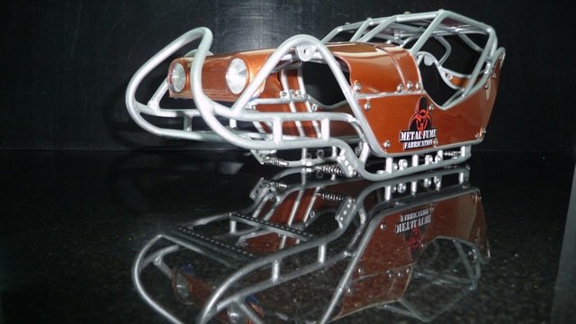

Shaved a bit on the panels and mocked-up the head lights.

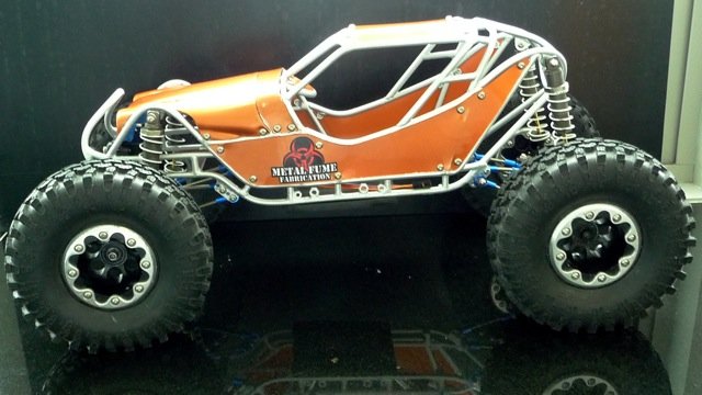

Been pondering past few days if Jenny would look nicer if built as a 2.2 instead of a 1.9. Here's a mock-up at 12.5" wheelbase.
I'd stay with the 1.9's, it looks awfully close to your reference picture.

Although it might be a little more fun with 2.2's lol. Sweet build "thumbsup"

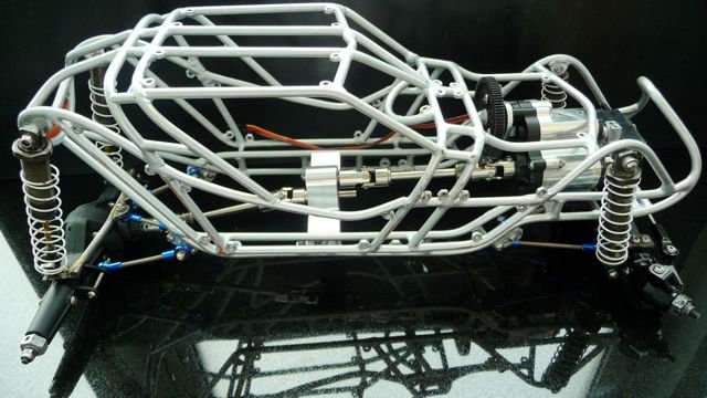

Still waiting on most of the Parts. Here's an idea for the drivetrain. Please note that it is just a mock-up to visualize placement and fit of components. Oh yeah, won't have a dig, for sure! "thumbsup"
UPDATE:

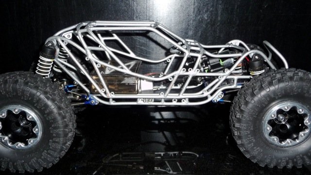

Swapped-out for a set of the shorter Traxxas shocks and extended the wheelbase for a lower ride height. Then, I mounted the transmission up front and transfer case dead center (with enough clearance for a 7T Cobalt Puller) and installed the driveshafts.
Positioning a JR Servo Crystal Case (just behind the transfer case) to enclose RX, FXR, BEC, and Flight Power 1350 3S (Same as with the Sniper Build). yup the crystal case cleared the driveshafts, nicely."thumbsup"
Dang Ed, that's a lot of stuff crammed into that frame :D! I honestly didn't think there'd be room for a t-case with the motor/tranny under the hood. The extended wheelbase and lower ride height look 100x better. Loving it so far!
Thanks Chris! Love the spaciousness under the hood and in the cabin. I made use part of the servo mount to mount the tranny. Driveshaft angle seem to be good with enough clearance, as well. I am working-out a way to get most of the electronics/lipo splash proof. I hope there is enough space for the electronics box (for ESC, BEC, RX, and Lipo) and some seats and driver. interior.

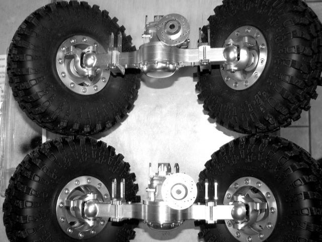

Got these, you think it is a good idea? I will have to mounting the tranny and servo, a different way. Well, I'll get what I have in here first to be a Runner and see how things Go. THANKS!"thumbsup"
Looking good Ed"thumbsup", your making quick work of this one.
Blackwells are an awesome looking axle but if your going for scale the NastyGirl never used "rockwells":mrgreen:. On the other hand the FatGirl did use them. I've been wanting to stick a pair of blackwells under the Fatgirl since I got it.
Yeah, I'm with Justin on this one, the rockwells were never used under Jenny Craig, which is why it was in part called Jenny Craig, it was way lighter than the Fat Girl build on rockwells. Having said that, scalers are meant to have your own personal touch to it, so if you want to give them a go, I'd say why not :D?
