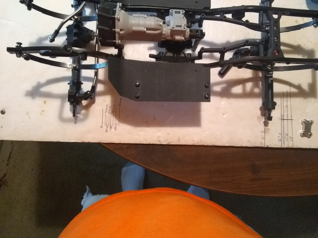

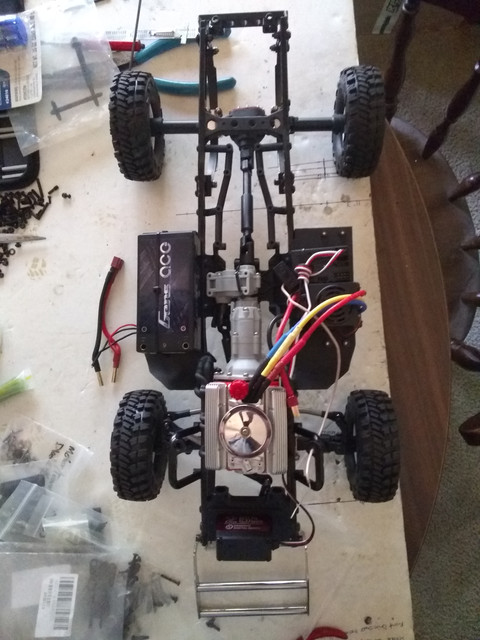

Few more pics of the tranny before it was set in the chassis for alignment and modding for fit.
Sitting in the chassis with the front mounts in place.
One last thing, which is a good thing I may just dump the center chassis plate completely. Don't need it as don't need link mounts, nor do I need it for rails strengthening. I will just make a cross member as it should have, and that will keep the center of the chassis rails strengthened, as well as be a great mount for the modded transfer case. With a little ingenuity and metal. And. 100% more scale. lol

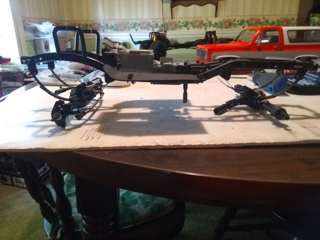

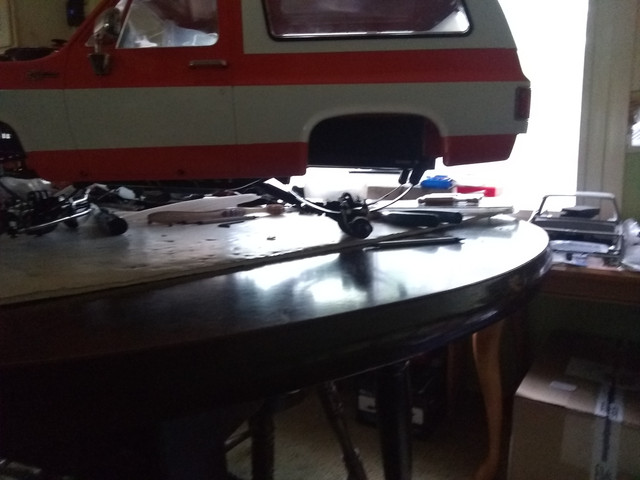

Here are a few pics of me moving the axles forward or back on the leafs to get the right wb for the RC4WD body. You can see the front springs seem a bit long as well as a bit up, ie they are u'd pretty well, where they should be a bit more flat.
I basically have the front axle on the front hole in the perch mount moving the axle all the way forward in the leaf. This put the front axle in the correct location for the wheel wells. On the rear, I have the perches in the rear hole I think it is.
Once I moved one axle location, I would have to readjust the leafs a bit and then the other axle/leafs a little bit to recenter that axle in it's wells. I took my time on this part as I wanted it to be as close as it could be for the body. Took me a full day between other things to get setup.
a couple of progression pics of axle/body location adjustments and the last pics of the final position.

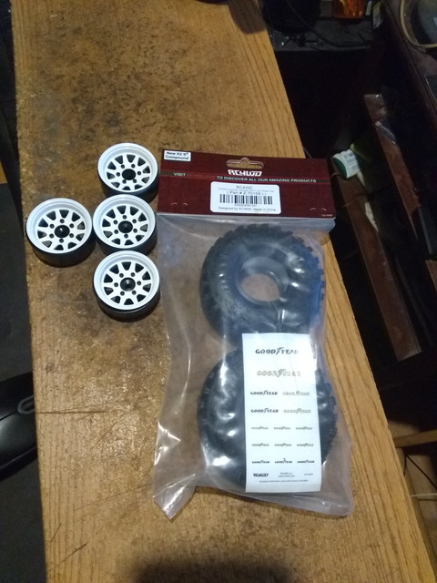

And the finale setup. Side note. Thes wheels look killer, but they also look like a set of 35s on her. They are 1.9s RC4WDs with the RC4WD Wranglers.
Thinking I will need to drop to 1.7 or 1.5s to get a more scale look. Dad had bigger tires on his blazer, but they weren't no 33's/35's. lol
So I will also probably be getting a set of 1/5s and another set of 1.5 Wranglers.
I may just amazon a set for cheap, but another 100 to RC4WD looks like it may be in the future.
Anyone have any links for a nice set of 1.5s like these I have on?

So I staired at it for a few, and moved mounts around, then swapped the leafs fronts for back. The fronts had a larger bow to them and it put the front end way high, while the rear sat low on just the leafs.
After the reposition and swap, it sits much more level through the chassis. May still move the rear leafs back a little bit. Just to better situate them to the very rear of the frame rails. I'll move the axles forward on the leaf/perch/mounts to get it back to the 11.4ish inch wheelbase needed for the RC4WD Blazer Body.
Did that a bit earlier today, and will probably move the rear yet tonight and get it set in its final place. Im still in mock up mode so a long ways to go yet.

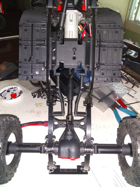

So once I swapped leafs, I put the axles back on and went through the tedious task of getting them on and aligned. Looks a lot better than the Super Scale Leafers as far as scale size, fitment, and function. No where near as stiff. I may remove the smallest spring to soften it up just a bit. If I do, I'll cut one up into leaf bands to bind the leafs together between the shackles and axles.
Shocks for the girl

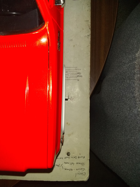

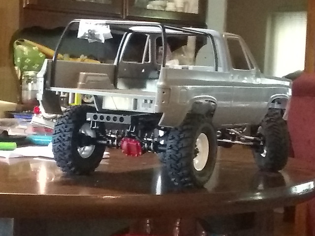

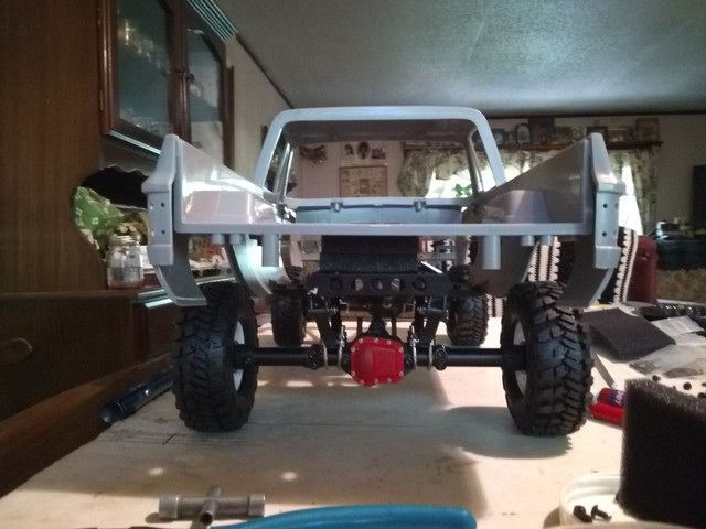

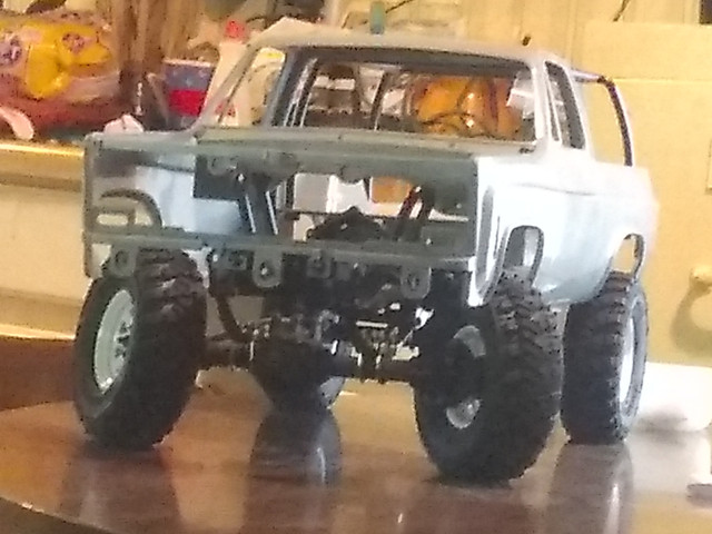

Front shot with the Class 2 body setting on it for lineup. The Body will be setting a bit lower when mounted of course.
Shot of the front well/axle line up.
One of the rear well/axle
Shot on the front with the wb marks I setup.
And the rears. This should work much better.

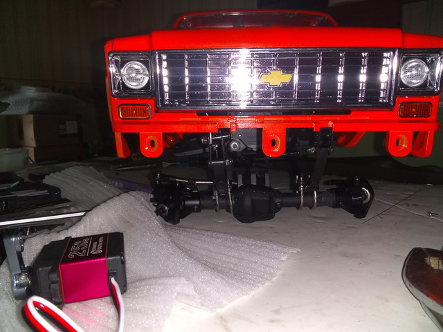

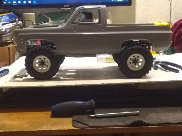

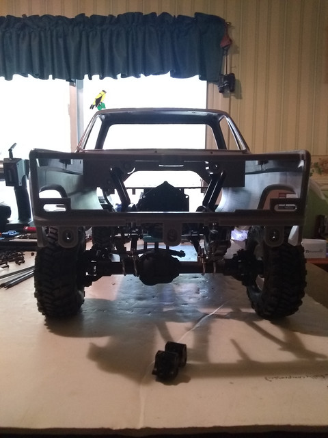

Here's where it 'sits' now. Body is loose fit yet. Just a few bolts through the side mount holes to hold it on the side covers. it is almost in the final position, though I want to bring the body down about 1/4 to maybe 1/2 in max when I do the finale mount location.
Few pics of how it looks atm.
Inner shot from the rear
2nd shot of the rear
Shot from the front
Profile
Rear Well alignment
Front Well alignment

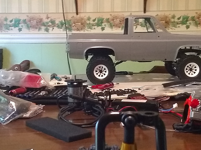

Smaller motor and esc (60a with a 3900kv) with programming card are supposed to be here sometime today according to Amazon.

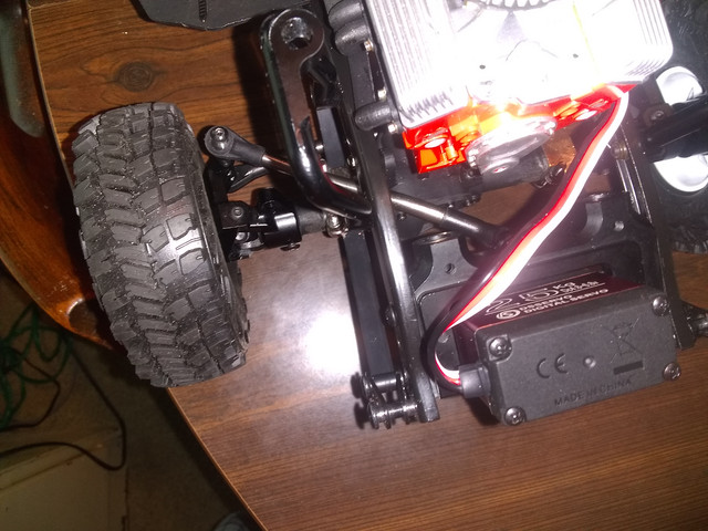

New Servo Relocation mounds came in for both rigs. Got them Temp installed and setup. Will take a little tweaking and I'll need to get a longer servo horn arm to give a better turning position. But this setup will work with the BTA Steering setup on this rig as it will be a Daily Driver/light trailing rig so it wont see much rough action. It just needs to reliably turn the front wheels, and that will be better with the longer horn arm.
Some pics as it sets now.

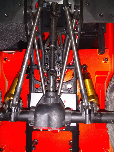

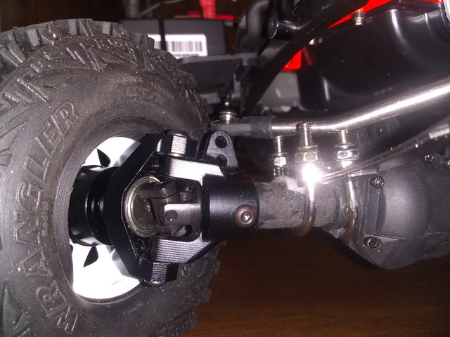

Worked on Drive Shafts today. Rear was cut down to 100mm, Front down to 91mm.
Prior I just had the Front Driveshaft on the Rear as the rear was too long with the 11.5 wb.
Thought about buying the short driveshaft for the TRX/SCX10.2 But it would have needed to be shortened a bit as well. So I decided to start with the rear and swap it out, then trim the front down.
No pics, we all know what Driveshafts look like. But I will get pics in the next few days considering the tranny case is flipped so peeps can take a look.
Few pics of the shortened driveshafts in place and a few pics to compare this rig to the Class 2 rig with the manual built SSD Chassis setup and RC4WD Blazer body setup.
