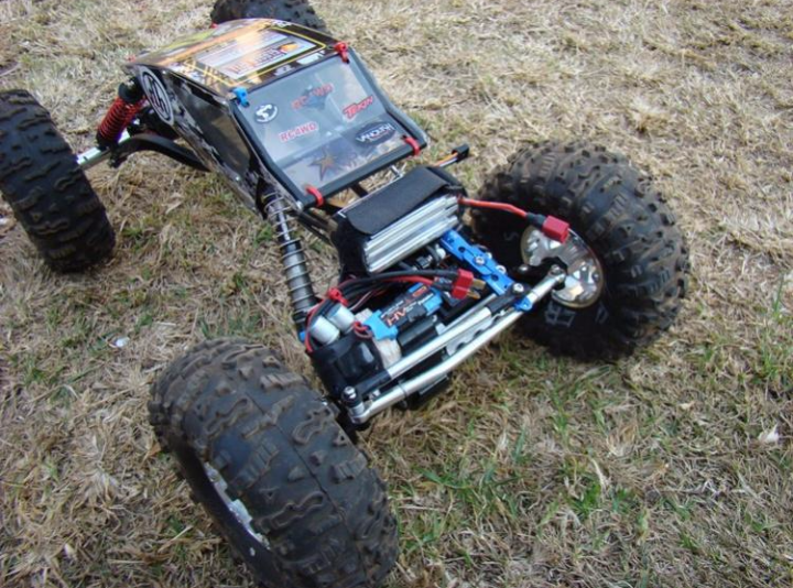

I'm not a fan of axle mounted battery. Here's where I run my 600mah 3s electrify battery. Red battery mounted between links on a rowdy racing battery mount
It's not a bully I wonder if there's a battery mount for the bully to mount battery between links?
I fear the lipo will get punctured on the front axle...
I think 800mah looks to big. Hell the 600mah just barely fits. I used to run the gen ace 450 until i replaced my ESC'S with HH br- minis.... my gen ace batteries would cause brown outs.

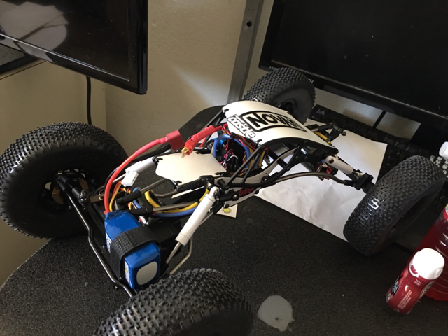

Here are some pictures of the team brood 850 3s and turnigy graphene 800 3s. TB weights 2.55oz and TG weights 2.85oz. I did add 1/4" spacers to each side up front to help keep the tires out of the links. But I tested lock to lock with stock width using the team brood battery and it cleared no problem just fyi.
Team Brood:
Turnigy Graphene. They are claiming 1k+ charge cycles with low IR so had to test this battery out:

The team brood batteries look good..

Can you post a picture from in front of the rig?
