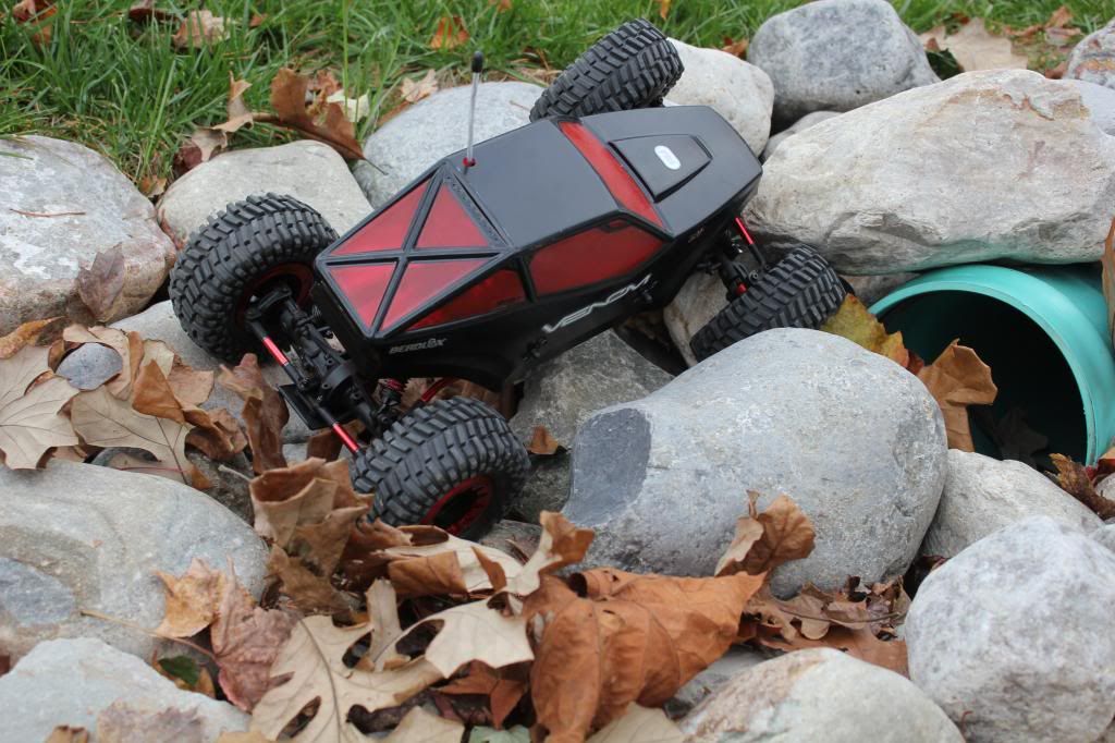

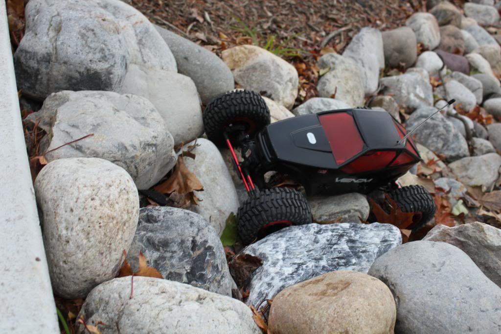

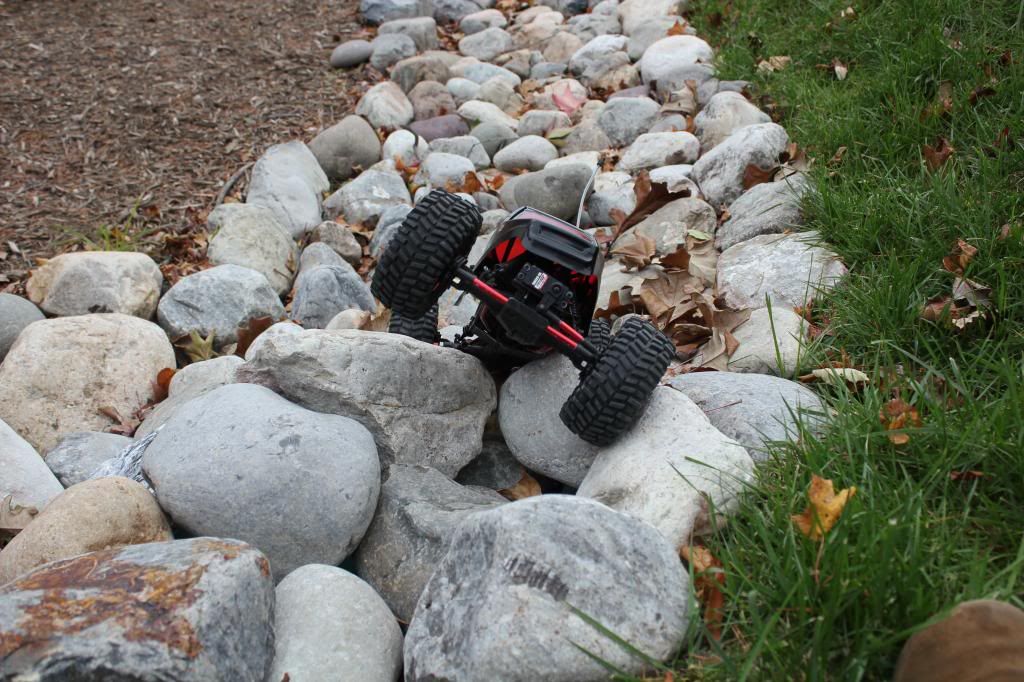

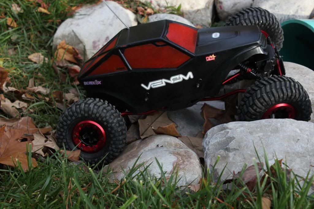

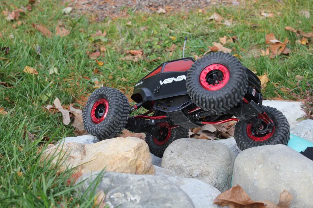

nice pics chad , hope you don't mind if i post one up on your page for you .

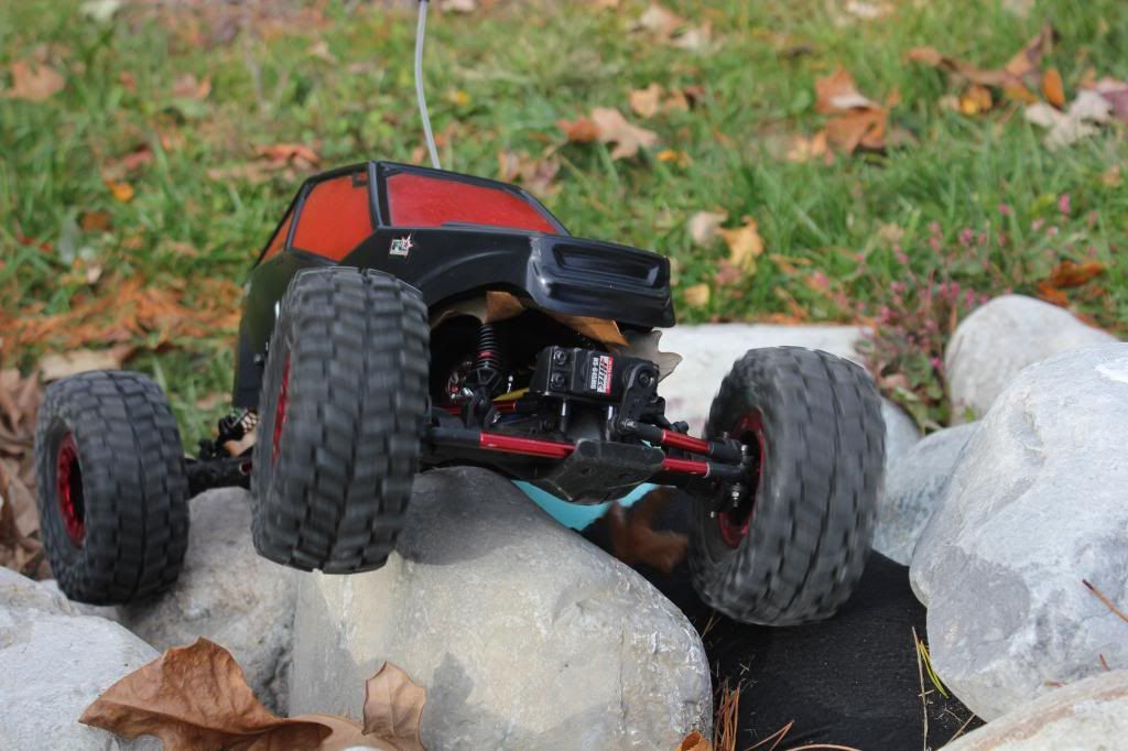

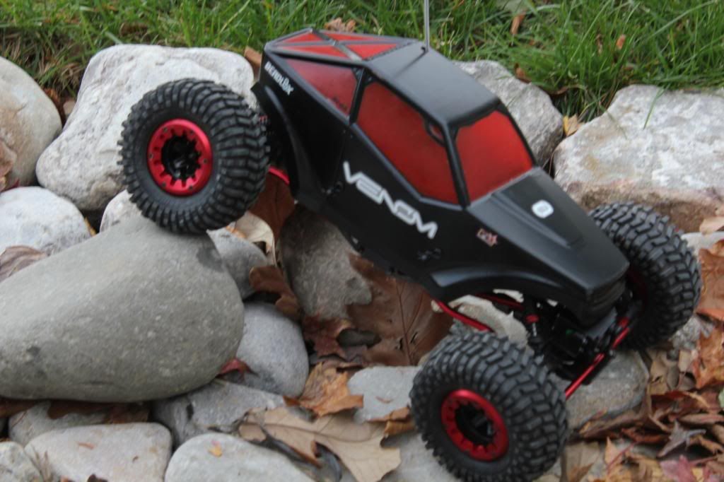

thanks guys i appreciate it... ive had a lot of fun building it and its really helped with my TBI and PTSD rehab! i want to start slowly upgrading it but dont know where to start! any ideas?
I always like starting mechanically.. what's the worst thing to not do..
I'm firm on the btl kit... Get the steering links an servo out of the way, then you can really feel the rig, when you don't have anything to get hung up on..
Tires, rovers, dona's... White dot Rovers are my go too... I ran Rmdw dual disc foams in my rovers on the creeper and a custom set of 1.9 dual disc foams Thomas made for me.I run CI double duece foams in my scaler an moa. It's what works for me in each rig.
Rmdw Lincoln lockers, SAI tubes are great for mechanics an drive train..
Then for me mips for drive shafts.. everyone including me runs/ran Traxxas drive shafts.. they cost just as much as mips an MIPS will last you forever!
Shocks.. 4" Lcc or big bores
Then a chassis is a huge part of it all.. no adjustment means ur stuck with nothing..
Now this is all assuming you want a competitive comp crawler and or bombproof.. ur weakest link is an will always be the tranny gears an the cvd's..
Hope some helps..

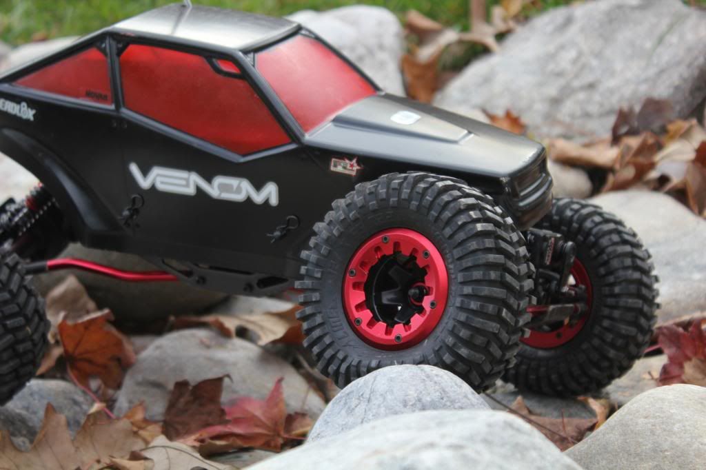

Nice area to play there man. Comp, i would start with a Chassis unless you like the twin plate style. I am more of tuber fan myself. i feel once you have the chassis you want, the upgrades will follow. tires and foams would be a good next step then move into shocks. personally i really like the look of the stock rims, i think they are really sharp with out the rings. i wasn't to hip on the rod ends nor on the body personally, but that is more personal preference then a needed upgrade. anyone i have talked to about the dig or rear steer who has either do not seem to use them much. oH and 2.4Ghz radio system, looks liek you are running either FM or AM there, less interference and glitching and better distance.
