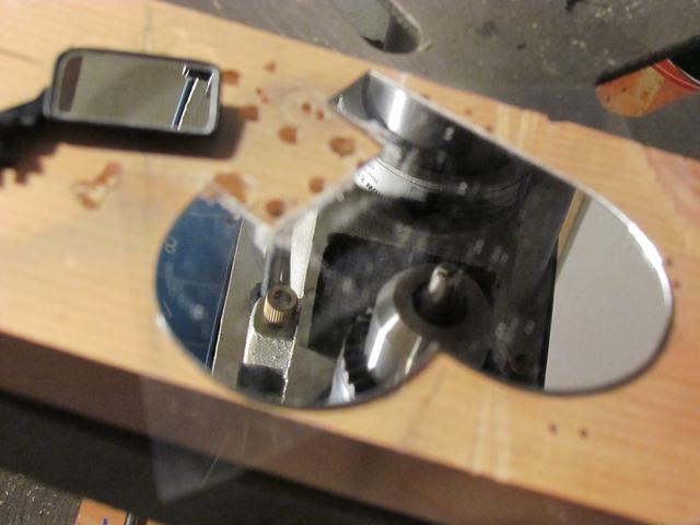

Really simple: Carefully peel the original mirror decal off of the housing. Go slow so as to not stretch or tear it. Then just stick the decal to the top of the real mirror ( using the decal as a template) and fire up the Dremel. Use a thin cutting disk attachment ( and a drum sander attachment to finish). Once it's completely cut-out and smooth along the edges, you can simply peel off the decal and you have a beautiful realistic mirror to insert into the housing. These mirrors have a protective backing on the adhesive underside that needs to be removed, so just peel it off and then press the mirror into place... Voila!... actual mirrors!

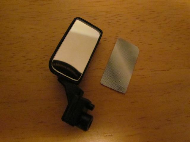

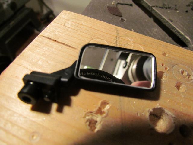

Last image shows the new mirror next to the original decal... night and day difference!
