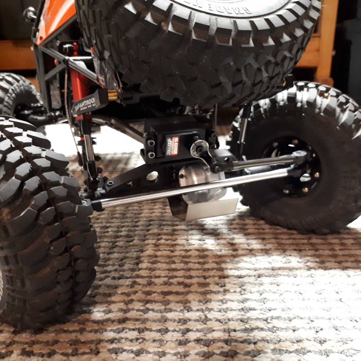

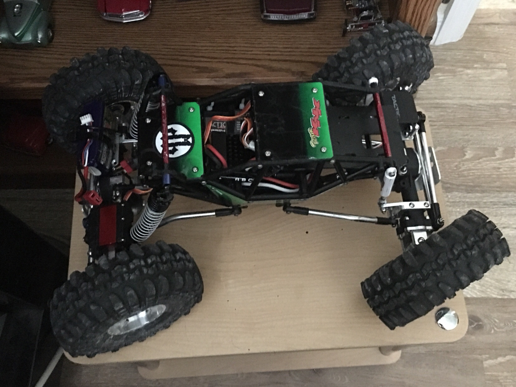

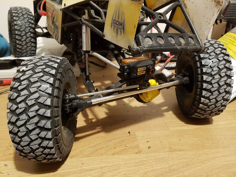

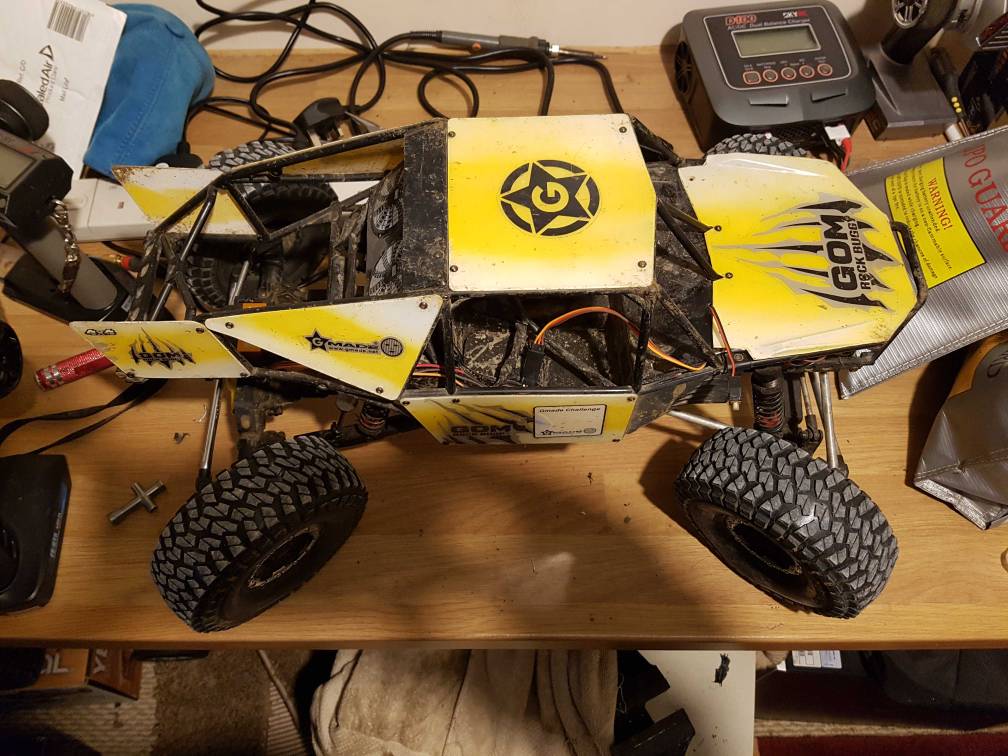

Nice bit of rear steer now. Was very easy to do...the only pain was the steering arm was too long so I bought some m4 threaded rod and made my own! Next job is to take out the castle 3800 and put in the Tekin 412 3100...just waiting on some new bearings for it. Hoping this will fix the drag break. Not sure what pinion to go for..might stick with the 18 for the moment....
Nice job "thumbsup" I figured someone would try that out sooner or later.
As for the gearing, I meant to bring that up in regards to the drag brake, I'm guessing you know this already but higher gearing will provide a less powerful drag brake.
The drag brake has been no different when running either 12T or 18T.....

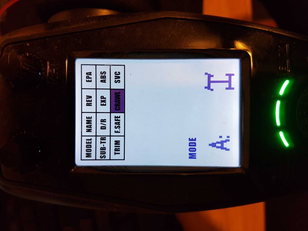

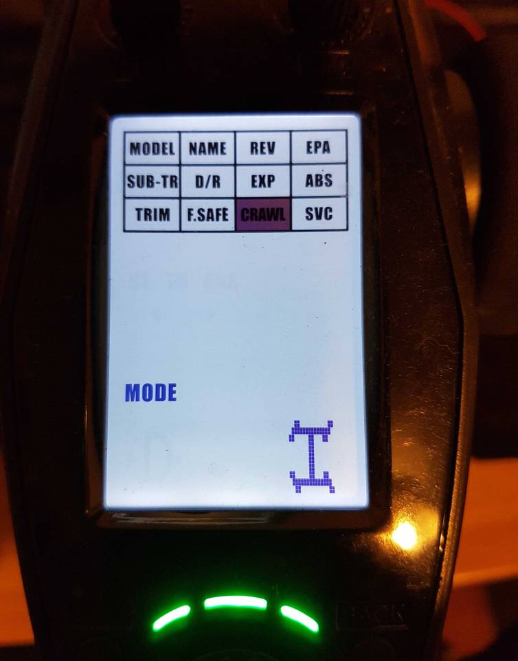

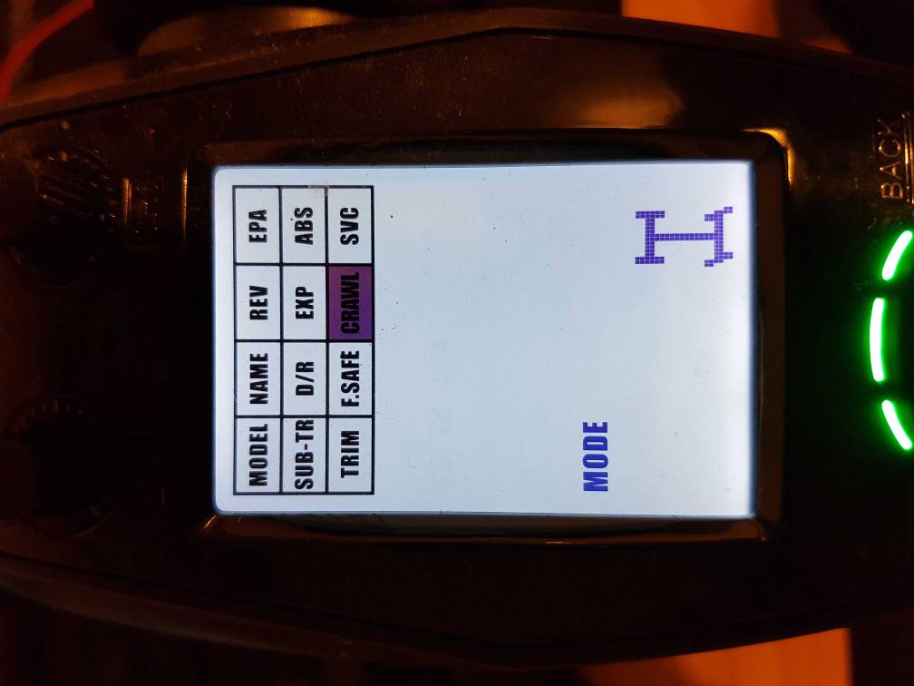

The flysky gt5 has a nice feature called crawl. Plug the 2nd servo into channel 3 and off you go. Here are the available options...

I measured mine at roughly 105mm.... Im running CVAs and the new set screw bits from Junfac...along with heatshrink.

Just buy a 1000mm M4 threaded rod...cost me £1.56 from hardware store. Eye to ey for me looks like 120mm....

What did you use for your link ? Looks a lot better than mine...
I originally used 8/32 thread to mock up the measurements and for testing while waiting for steering links. I only used the long steering rod and used the axial 56mm rod for the servo steering link because I had an extra one when I changed my front servo to axle mounted.
The 8/32 threaded rod is ok, just more flex than I am comfortable with.

Well Im yet to use them in anger...Theyve had a blast round the garden with a bit of load...wet grass and a 4S battery on the 3800kv gave it plenty of wheelspeed. Will try and take it out properly at the weekend.
Im just fitting a JX 5932 to my sons GOM now. I was originally going to run it on the rear of mine to match the front, but as I had just got hold of a Savox 2270 I decided to use that instead....
My son will get my 3800 and a mamba X that I managed to win on ebay last week...so he will be a happy boy.
That will free up a HW1080, so I need to think of something that I could build and put that in now.....

Ah, good point, that'd get me both rods at once. Then would just need the angular rod ends for the longer rod. Those would be about $12 shipped. There's a pair of angular ones left over from the build but probably not angular enough for the link to clear the diff cover at full turn. But I guess I could test that at the front at some point.
You could always use some normal angled rod ends and just bend the longer rod slightly...saves waiting on a delivery....at £1.50 for a metre of it you can afford to have a few attempts..."thumbsup"
