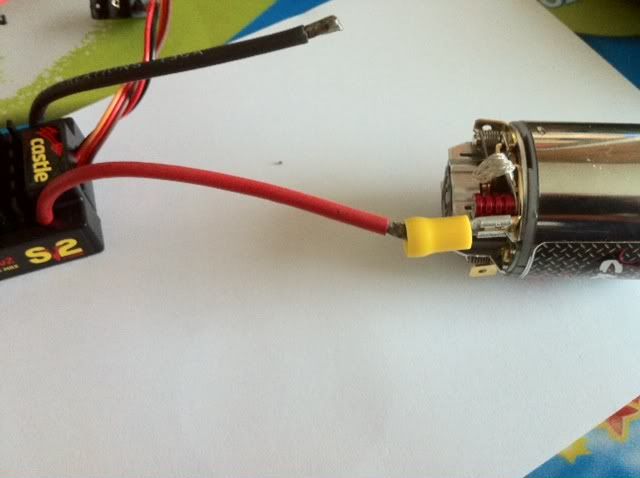

I recently bought my very first RC car and Im having trouble with the wiring. I know how to connect the wires and where they all should go, but the problem is the actual connecting of the wires. Ive tried soldering the red and black wires leading from the esc to the battery to a pair of Deans connectors but with no luck. I tin both the wire and the Deans connector but when I try to fuse the 2 together, nothing happens. The solder on both ends dont melt. The wire leading to the esc only gets red hot and I have to stop because I fear the heat being transferred down the cable might damage the esc. :cry:

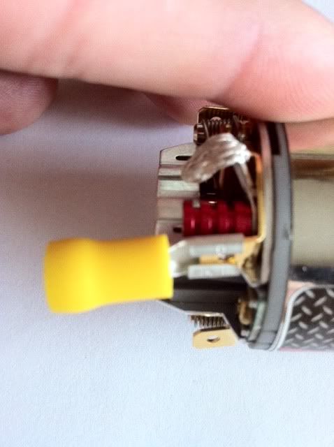

So a friend suggested that I swap the connectors on the battery out for a pair of these (I think their called spade connectors?).
The connectors on the battery end will be insulated from one another to make sure they dont touch and short out.
And if this is possible, I want to use the same type of connectors on the wires leading from the esc to the motor.
Like shown here. The connector fits tight over the connection on the motor. So no fear of it falling off while driving.
Can anyone tell me if this is possible or not. What are the downsides to doing all of this?
stick with the deans the spade connectors are the lazy mans way, dont listen to your friend:evil:
from your pictures, it looks like your soldering the battery cables to the spade connectors, NOT the motor cables.
Also looks like your ESC is designed for a Brushless motor (3 wires instead of two) and your motor connection cables are already finished with female bullets.

AG is correct, you have the leads that connect to the battery connected to the motor.
Oops thats my mistake. Had to take the pics in a rush this morning before college. Didnt pay attention to the orientation of the wires. Just wanted to show the connectors more than anything.

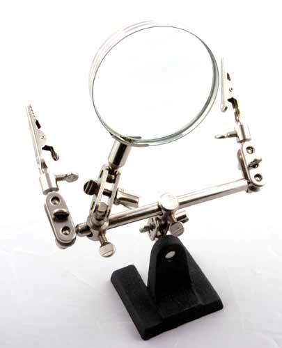

You're not trying to hold the parts together with your hands when you are soldering, are you???
Get something like this:
Or...
http://thejigsup.net/
Also, you want your work as stable as possible when soldering. If it moves before the solder goes to a solid it will cause a cold solder joint, which increase resistance (bad), and are prone to failure (also bad).
