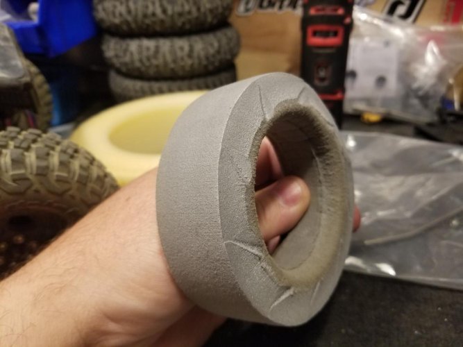

Is there a pic for reference? For some reason I've having trouble visualizing it.
Hyrax G8’s Running 4.75 Comp Cut Inners with Soft outers up front, Medium outers in back. Rig is about 8-1/2 pounds with pack. I’ve been pleased with the set up. Great traction and conformity, and the 4.75” foams keep the sidewall a bit stiffer for side hilling.

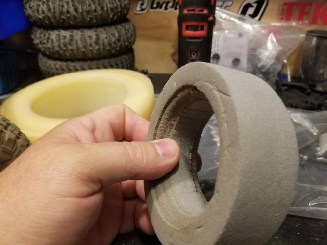

This is what we do. The reason is to keep the inner foam from being forced sideways on the wheen on shaft turns, especially down hill turns. It will fold over and then spring back and you'll lose your line. With the cut the force pushes the foam onto the wheel as the tire rolls over a bit and keeps the line held. It works, no doubt about it.

White-Trash - what’s your method and tool for cutting. I tried this a while back on some foams for my old AX10 and butchered them horribly.
I did that with some mid grade scissors but I used to use some dull old scissors my wife gave me and they worked fine.
I used to make the cuts and then buff the foam back smooth with a 1" flat faced stone in my dremel but figured it didn't make that big of a difference in function and it made a mess so I stopped. :lol:
I will have to try that out. I just ordered a hot wire cutter for something else but it should make short work of the foams too.
My dad turned a 1.9 plastic wheel into a jig for his drill press. This with very low speed plus the hot wire would make it easy.
I don't exactly understand how the angle cut works. Are you saying it leans the foam into the wheel which puts pressure on the opposite side and holds it in place kinda by squeezing the wheel?
