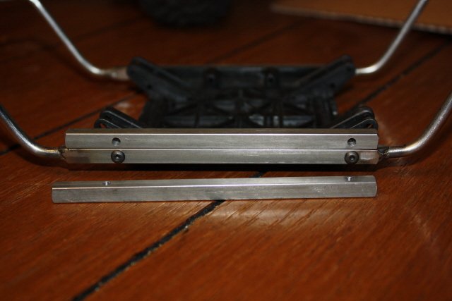

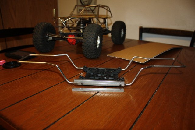

Now you can start your own wraith-skid based custom chassis"thumbsup" These are exactly the same thing I use when building any custom chassis, utilizing the wraith skid plate. They are shown in the pictures below. I have the start of a wraith chassis also, to show them in action.
They are made from 1/4" square stock steel or 1/8" flatstock, and drilled for the outer-most holes on the skid plate. That is all you need when running a metal chassis.
