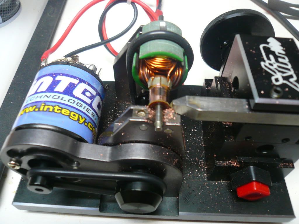

Yes, I run them at about 10V or so....

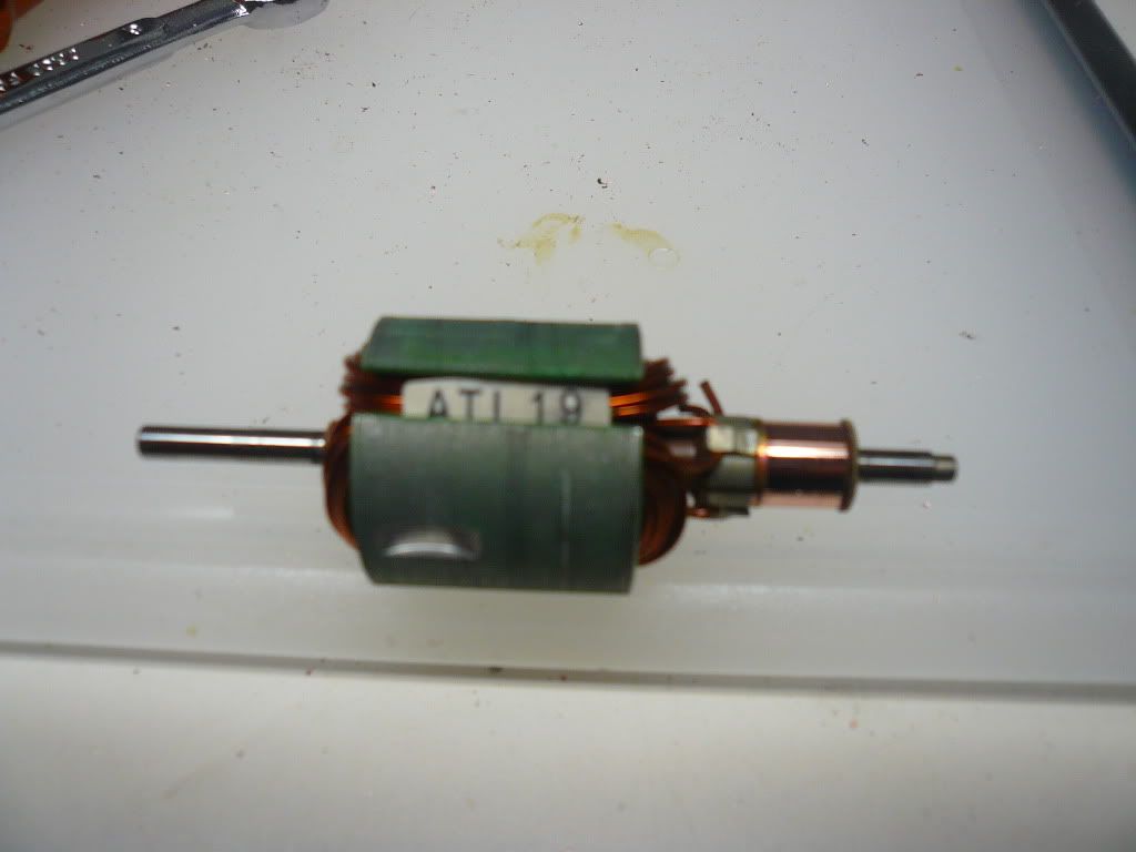

Well, I think I am getting a bit better at this. Here is an Axiom 19T that I pulled out of my TC3:
(after the first pass)

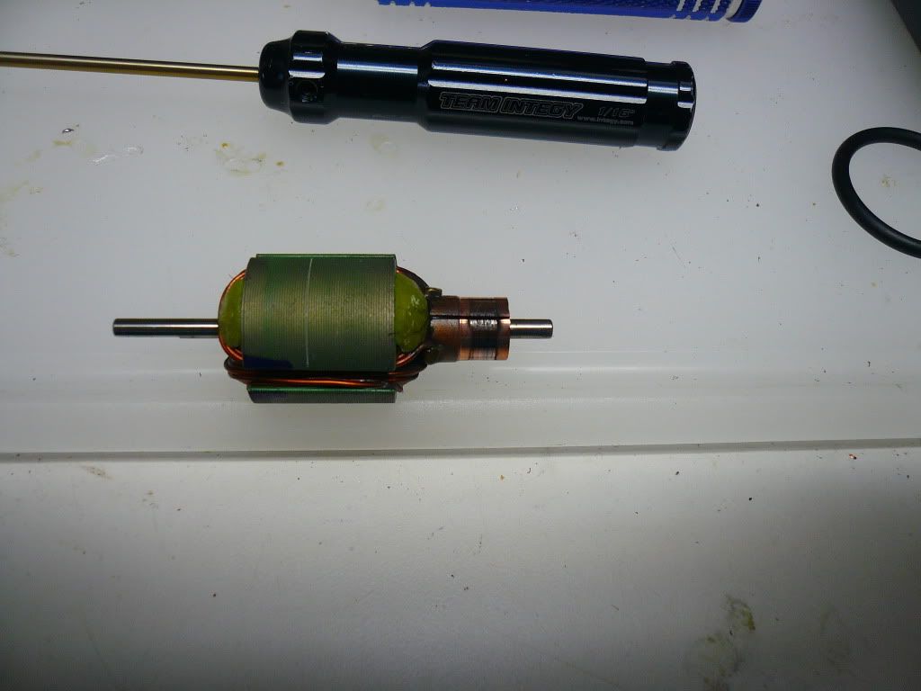

(after the second)
(finished)

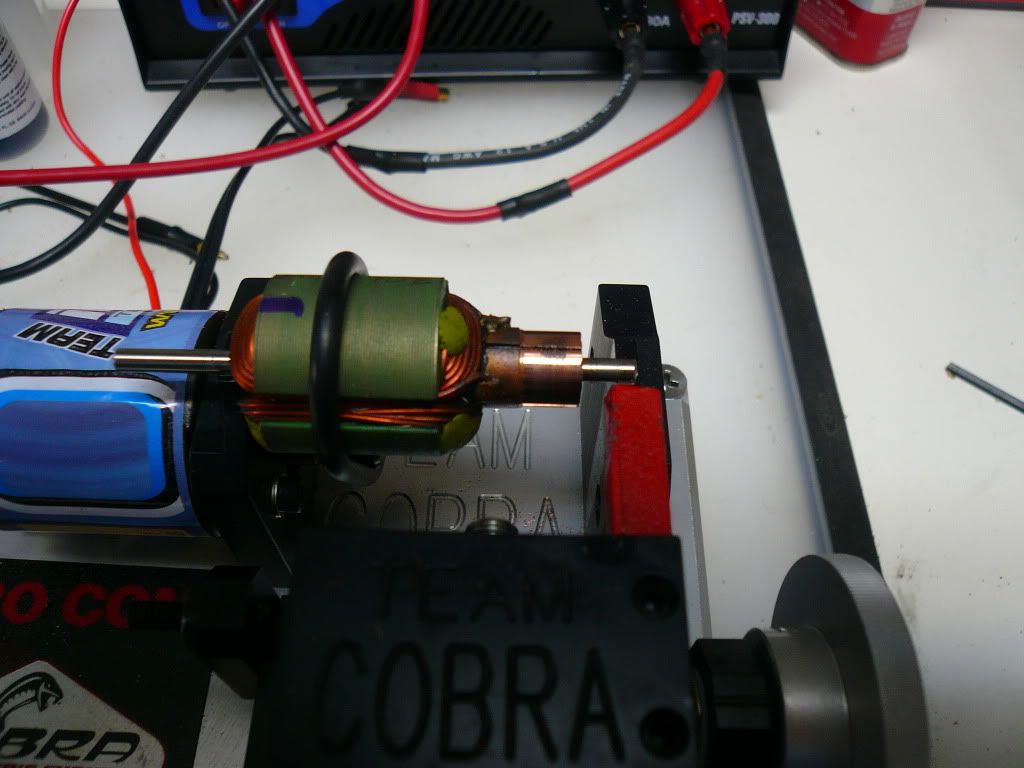

His lathe has so much geardown, I would be afraid of the bit grabbing and trying to make cuts that are too deep to offset the slow face speed. If you can tach the armature speed, you can figure out if you are in the good zone of cutting speed. 10v should be right for the lathe.
So John, what voltage do you recommend? IIRC, the instructions said 7.4V-12V....which is why I figured that 10V would be just fine. I guess I can use a fully charge 2S lipo and just charge it about every 5 passes or so....

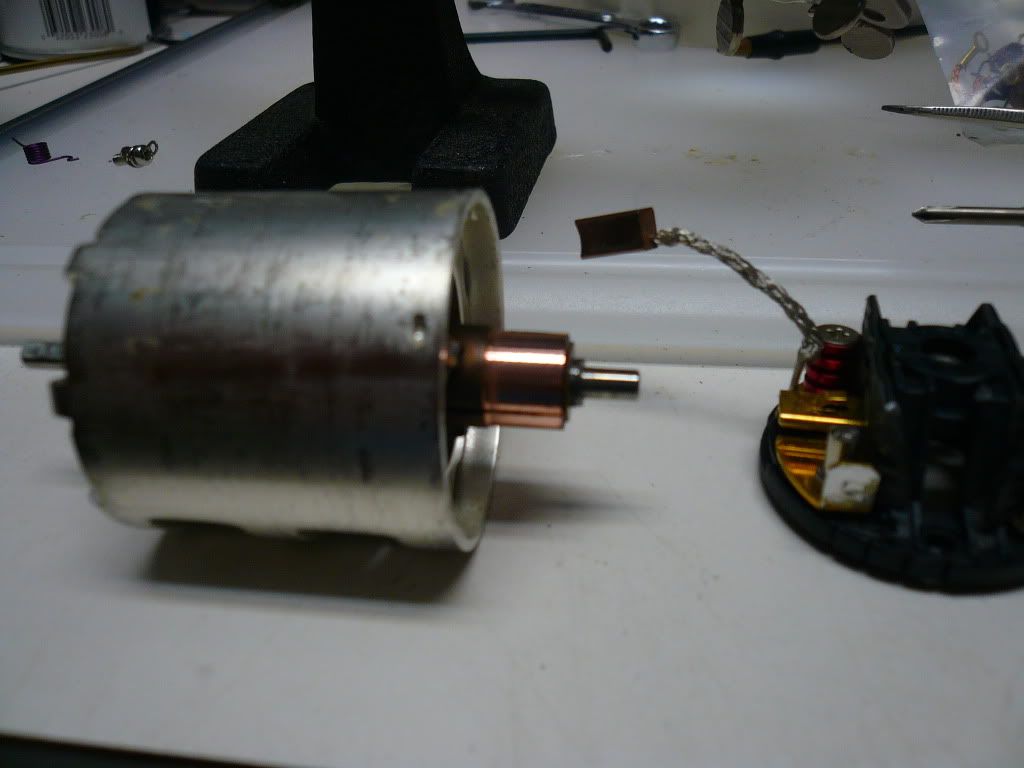

Here are a few more that I cut this evening. These are Brood 35T Big Wires from my berg:
(Rear before)
(after a few passes)
(finished)
(front finished...it was in better shape)
Instead of jacking with batteries, I picked up a Muchmore Motor Master and I have been cutting these at 4.0V....much smoother.
