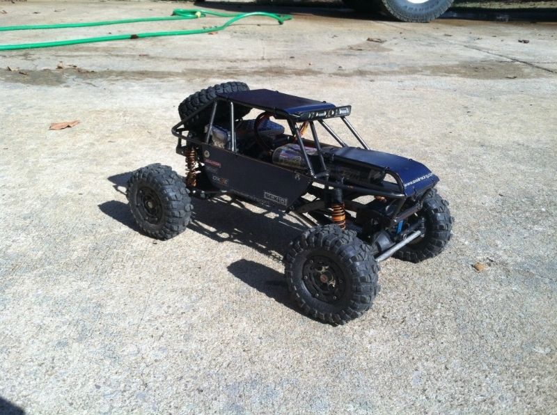

So with a broken rig and a little bit of money, I was out to build a better Axial. The knuckles got replaced with aluminum knuckles and C's (which where next to go). I replaced the rod ends with Traxxas ones and broke out the trusty MIG to work on body protection. Here is what I ended up with:
For a first go around, I was happy with it. It wasn't meant to be perfect, just a weekend project to try my hand at tube bending. I know the body looks crooked... It wasn't pinned down in this picture.

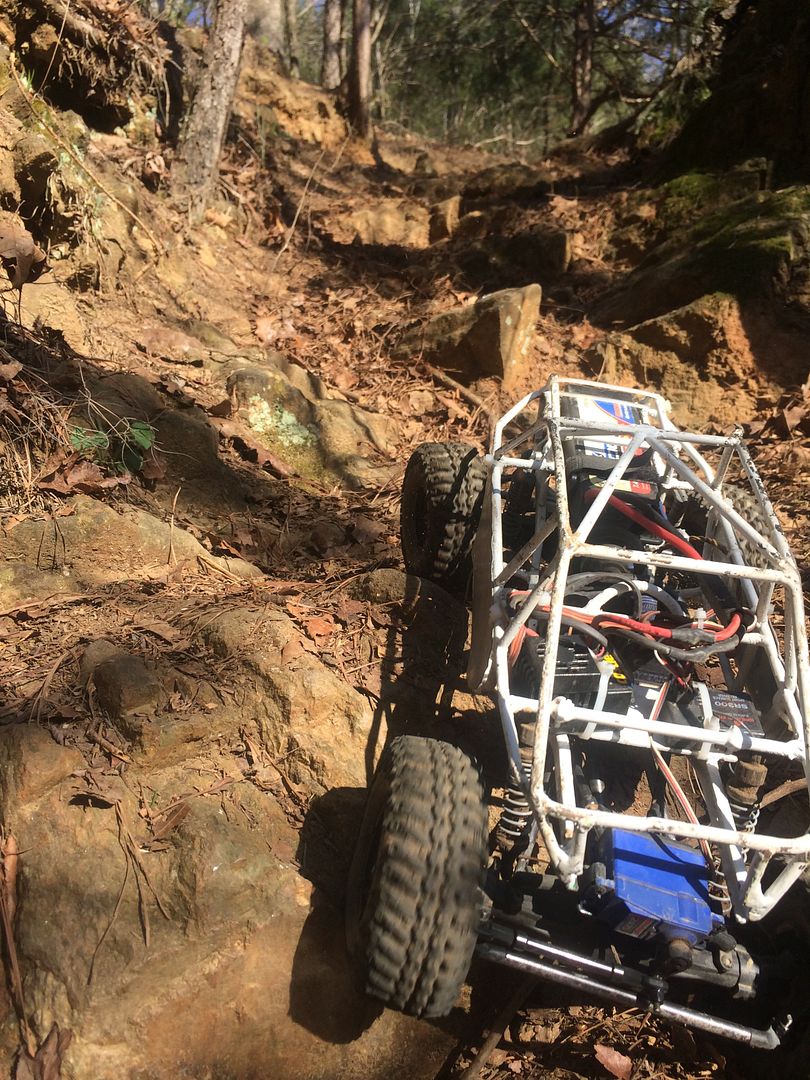

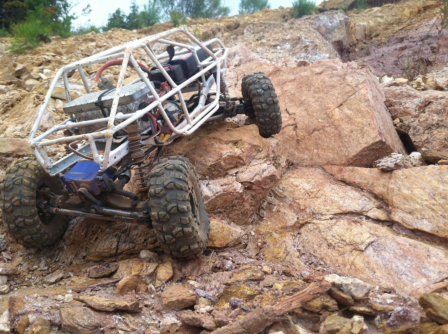

And here it is now.
I picked up a toolbox from Tractor Supply to use as an electronics box which also gave me room to run an auxiliary battery for lighting in the future. The rear links are 6-32 all-thread with Revo ends. I still have hood bars, body panels and mounts to do, as well as finalize battery placement and tie the shocks into the cage. I know the welds aren't the prettiest...still running flux core. The current color scheme is going to be white with black panels. Once school lets out for Thanksgiving break, I plan to have this thing finished up pretty quick.

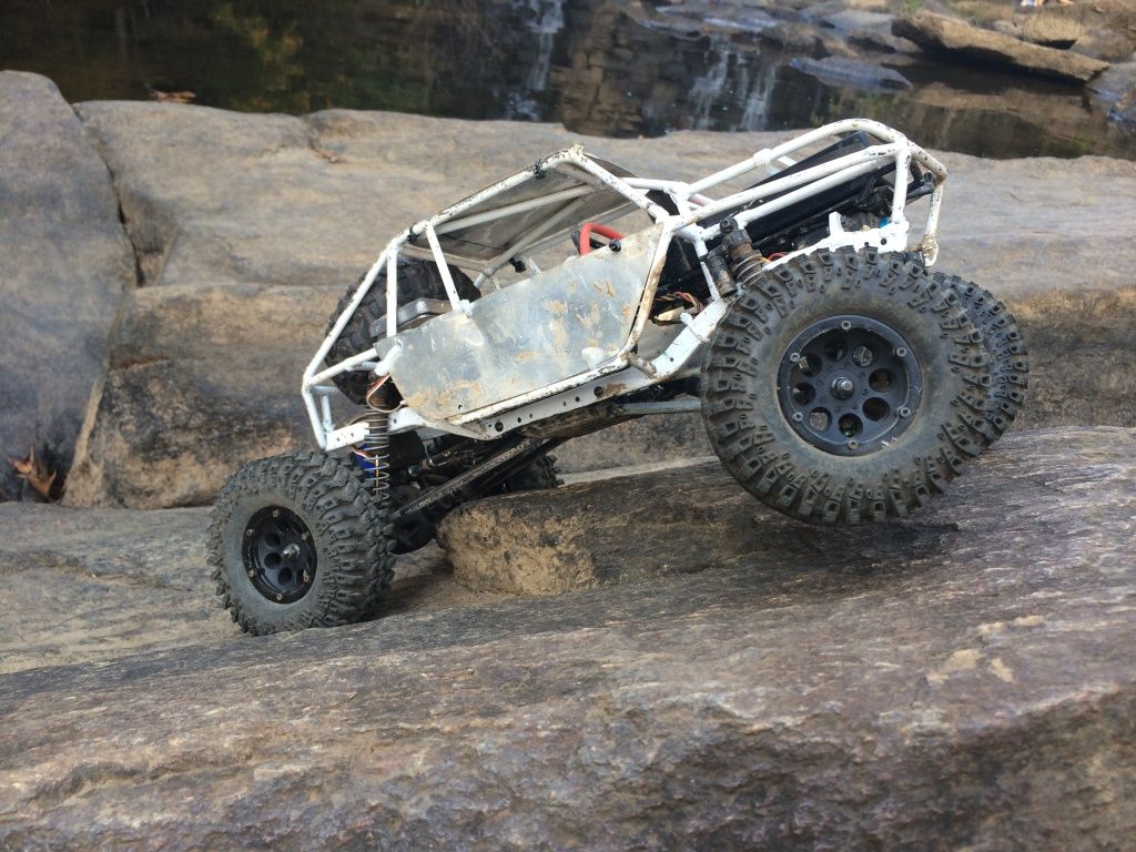

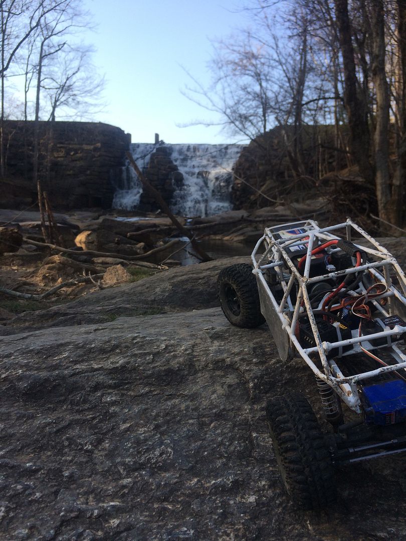

And the finished product. I still have a few loose ends to tie up, but its mostly complete. Can't wait to get it out in the woods!
