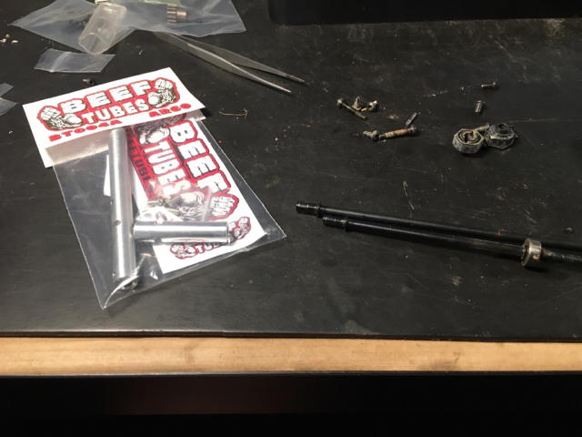

Beef tubes aluminum U4 in both axles:
SSD Pro knuckles and c hubs:
Vanquish clamping lockouts:
Now the axles are U4 proof!

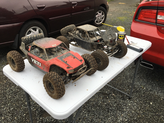

Was cleaning the Bomber and the Yeti after another U4 race (2nd and 1st! :D ) and took a few pictures of how MMX looks inside:
dirty, very dirty: :ror:

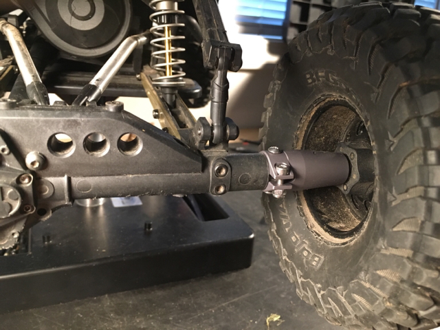

And after break the servo mount (the original plastic with some mods) and the SSD c-hubs got loose, the front axle got a second round of upgrades:
uSJh-jR4UnoBsO5Qe4dkMIgg3nkSrjEU59sphuCnf5BQ1blsV7VZclgZYWoPYcQjaXmRoDocIFIA0fBKL7As2V70aIwWS0rLY_uCNGvUHz1-3CDewbv20Dam-sE3_y8qdwSMXch3txUxF2kveEvLY7Jl8i3SQkKjrO320uzKjOL-nrRaYvUqH6lTNgxURQCegeN_7qCgJPQpU7bP2lVUimetTEwTTBpssb1BvV-ImPpFneUJp4zt4uAaLkg3dMi_0a3LKENNXMkD1xFAgducIaM6QTaPA3Xu3sf3NgtiLEGyw6y1zBpUl-npRkE4MrvU1xhEBhBa30U9M9AyemJ3pGiOepF5eiIOqv28lpkX0FKFP89kamjqLBBDe2qFwsnTYjfHtgEXWUej5EWh4pdJU5voptvArLamiLQLjnJY4XFx9uEMCYdsRSWrZzhZJpUP7xViGVvbxG0PDwnRRjAS3-LNXt-KGYTHuThcdhEOGvhi2IyzfqQlOO38cD9yityDfFSn8YQCMqLp2avKKNDBhL5ZKizDuyJ5sa7AkexqkfmAIsLL14GSVDBVQK81mlvBCKFe7pKQ_xG--OOMCXch_cgKuVqK_r0K=w822-h616-no
All Vanquish now with the servo mount reversed and servo horn modded.
Clamping c-hubs and scale knuckles. Also new truss front and back.

is the reverse servo mount to keep the ears from breaking off? What did you have to mod on the servo horn?
Yes, but more for keep the servo away from direct impact from the rocks in the track.
The mod in the servo horn is cut out the outer hole, so it fits in the reversed servo mount without hit the diff cover and the tie rod.
The second picture kinda shows it.
Cool, thanks for clarifying.
