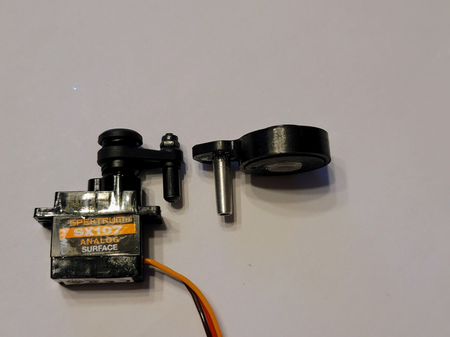

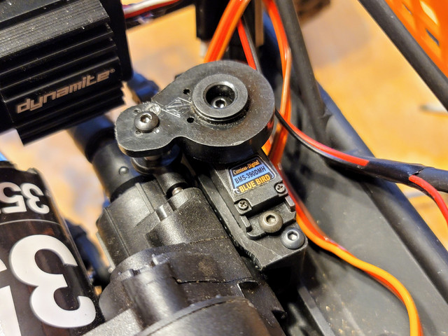

I've been using the replacement Spekrum servo for a while and wanted something stronger so the dig will engage and disengage easier. I knew I had a slightly larger Blue Bird BMS-390DMH servo with 75oz of torque versus the stock 42.8oz so I decided to try it out. With the servo being larger/taller I 3D printed a new mount and ended up using a Kimbrough servo saver to fit the larger spline. With the taller servo the stock shifting arm post was too short and wouldn't stay in the loop on the dig shaft. A 5mm aluminum standoff was slightly too large so I put it in a drill and used sandpaper to turn it down to 4.4mm in diameter to match the stock post. Everything fits nicely and the new servo is a big improvement over the SX107.

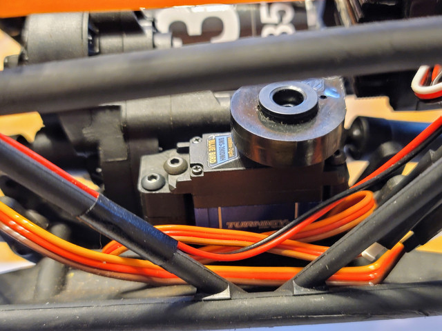

I used a Torq CL0508 which looks suspiciously close to the Reefs but a lot less money.
Bolted right up (I used the SSD RC mounts) with on of the servo included horns. I had to open up the hole for the screw but fit fine otherwise. Works really well no issues.
