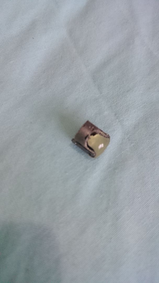

So after upgrading the power of my 1/24 crawler I have battled with a constantly breaking drivetrain. At first I drilled out the balls in the driveshaft and pinned them, which worked for a while, but upon upgrading tyre size and weight, they were no longer strong enough and snapped again. I also tried to use metal universal joints, but couldn't find small enough ones.

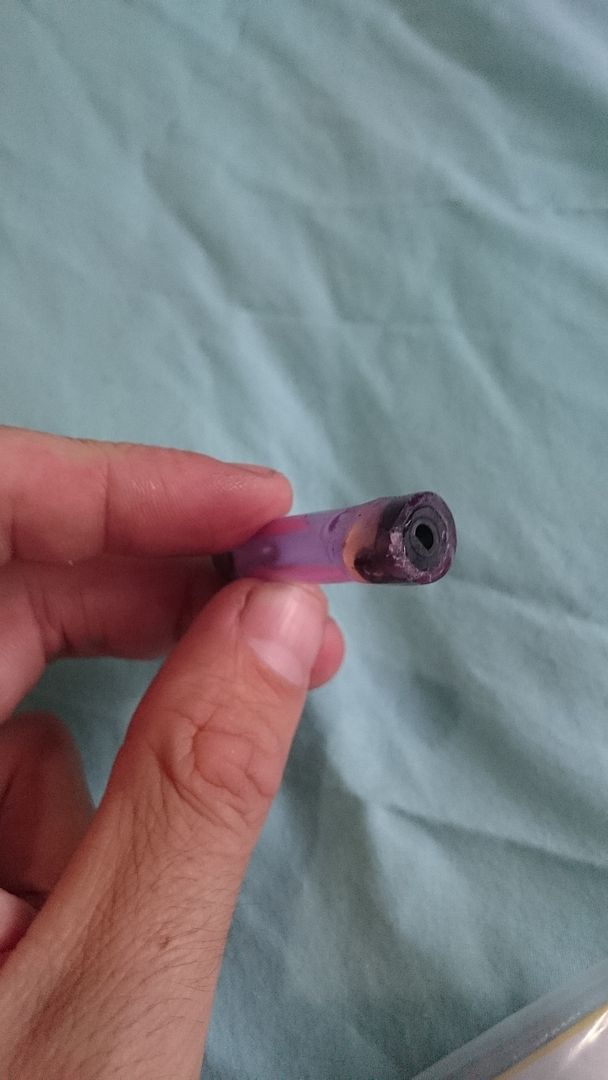

Here is a brief DIY
Remove the driveshafts from the crawler.
Remove the yoke from the driveshaft
Put a dab of hot glue between the fork of the yoke.
Cut a piece of fuel line to size (you will need to work out the size that works best depending on the linkages you have used on your truck)
apply some glue to the inside of the fuel line towards the ends. Then insert the yoke into the fuel line like so
Do the same to the other end.

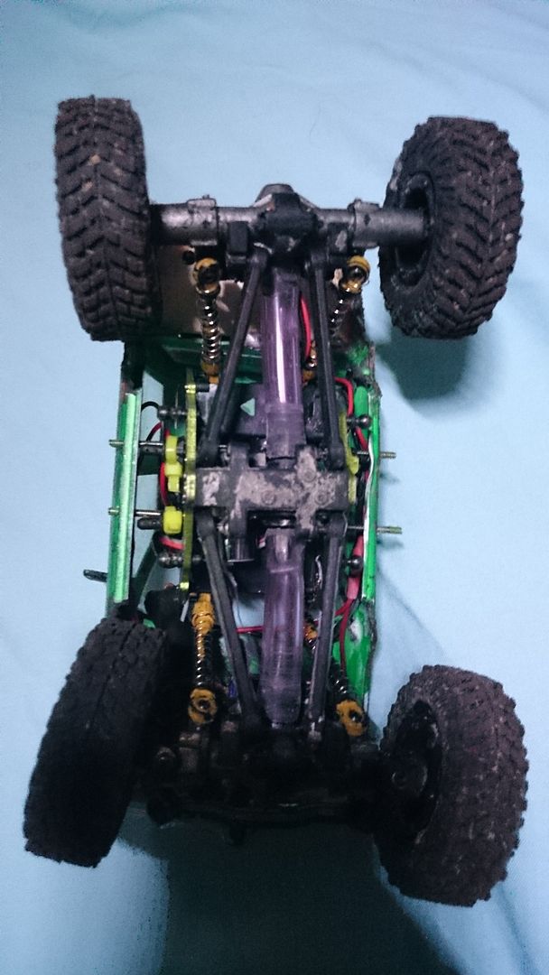

You will need to sand the ends of the new driveshafts a bit thinner to stop them fouling in the gearbox and servo mounts.
Then install back into the truck

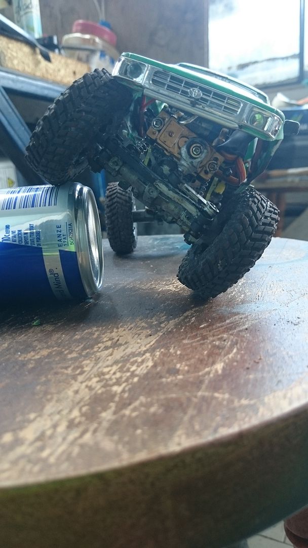

About now is when you will notice the lack of articulation.
The mod I worked out to fix it is easy and free.
Simply remove the upper links. As the driveshaft is now solid, it can act as a link itself, and it does so rather well.

Overall the improvements far outweigh the disadvantages in my opinion.
My truck is now taking on lines that it never had a chance on before.
