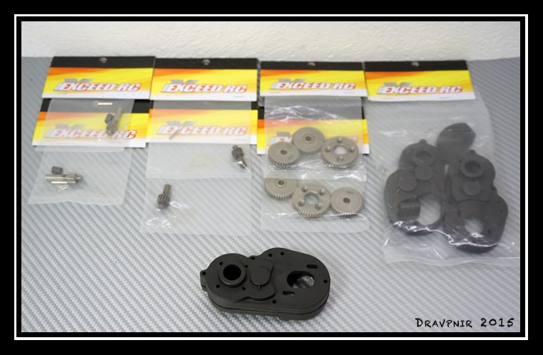

I also got a bunch of Exceed parts to make up the rest of the axles. I got some plastic gears somewhere too. I was thinking of running metal large gears in the front and plastic ones in the rear.
For shafts I will use some OFNA shafts that I need to figure something out how to connect them to the Exceed locker or a standard Berg locker. Reason I went with OFNA shafts is because I got 2 extra pairs of Dlux delrin knuckles after upgrading to aluminum ones on my super.
