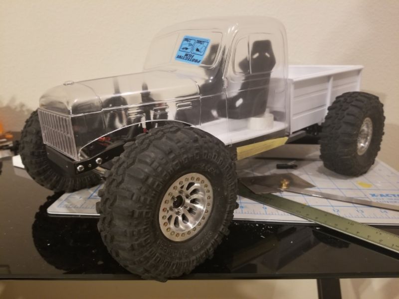

Hey everyone. Our summer events are coming up soon and I don't have a 1.9 rig, so I needed to build something. My C3 rig is going to take a while so I wanted to do something quick. Trying to keep this fairly simple. The only real custom parts will be interior and the bed. I wanted this to be totally fenderless, looking at the stock bed I thought it would look funny with the fenders cut off so I decided to build one. I'll probably regret the full length bed.
SCX10 chassis
Incision links
SSD Diamond Pro 10.2 axles
Dinky DDK.2
Holmes Puller 400
Holmes BR Mini
Hitec 7950
Custom sliders I stole off a previous build
Dinky Cantilever
Big bores with mini t's

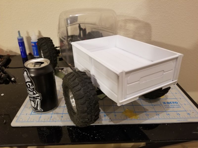

Bed is coming along but still needs quite a bit of work.
Yeah when you do it like that you could do with a inch or so less bed out back, and its not like there are any chassis rails to contend with back there.

Thanks. If the bed gets as hung up as I think it will I'll just make a new one.
Just my .02, if you're going fenderless, I think you should Bob the bed, less to get hung up on.
Agreed, but I was already committed to the full bed. If I build a new one it'll be bobbed and doved.
Got the tailgate "done" and the bulkhead at the cab. Still lots of sanding, some minor reinforcement and details to come.
A fine looking bed like that you can probably sell off if you get tired of it.

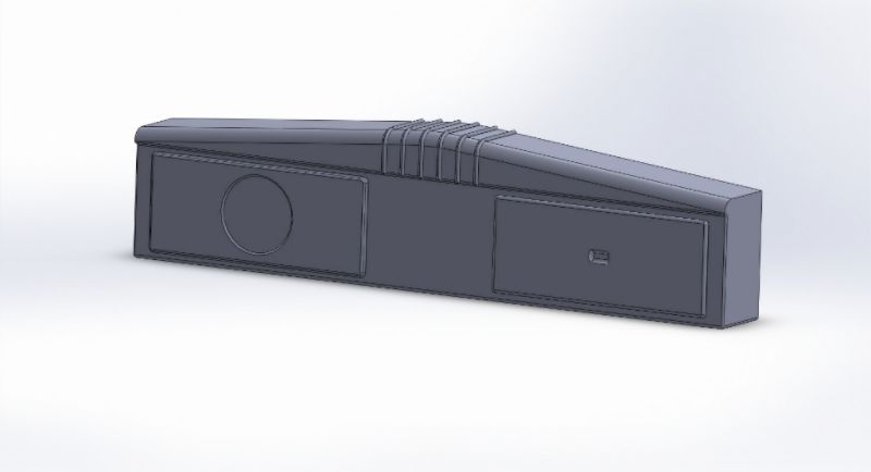

It's definitely a thought at this point. I may just hold off until I confirm that it grabs everything. 3d printed dash in progress.

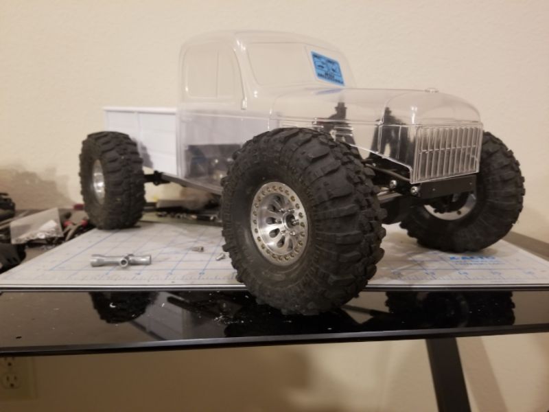

For now, lower (in Star Wars Emperor voice)
Great idea with the bed, something I've been kicking around in my head for a while.
Thanks!

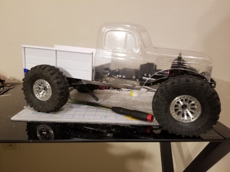

You could try a tad longer rear link combo? I think the truck would still sit right. Just a thought. "thumbsup"
Definitely a thought. I stretched the front to improve the approach angle and moved the cab forward when I lowered it. I'm currently at 12.5" wheelbase, which is starting to get to my limit on a 1.9/C2 rig. The 30% overdrive with this transmission/transfer case combo makes it turn AMAZING, but the wheelbase is still a concern.

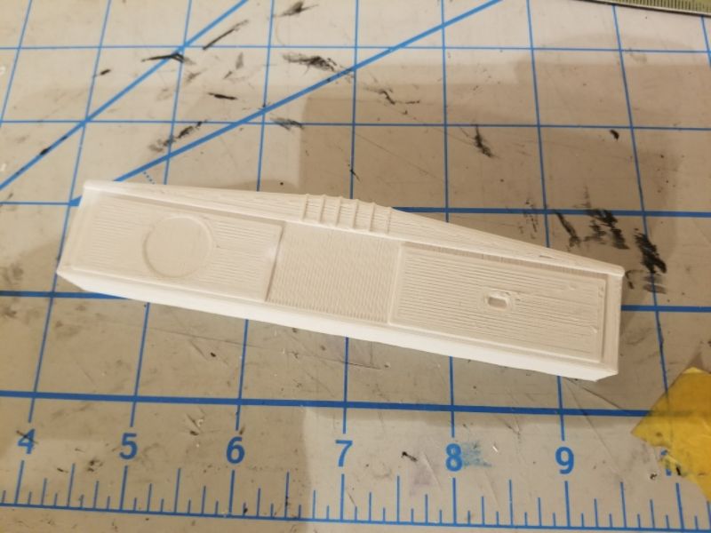

1st iteration of the dash is done. It'll be on the printer this weekend to see what needs to be adjusted. Also planning on attempting to pull a resin copy of the cab this weekend, assuming the weather cooperates and isn't too cold.

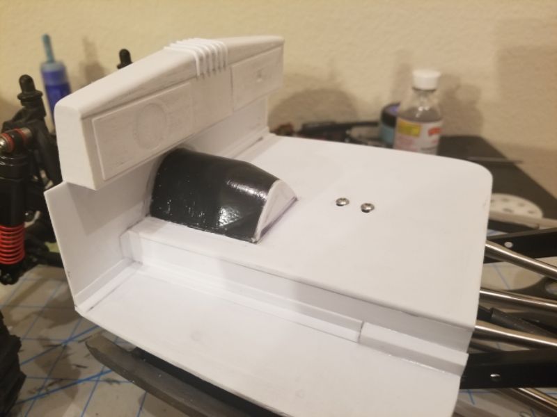

Interior started. Got the floor "done" and a prototype dash done. It needs a little work to meet the cowl contours, but is the right size, and the overall shape is on point.

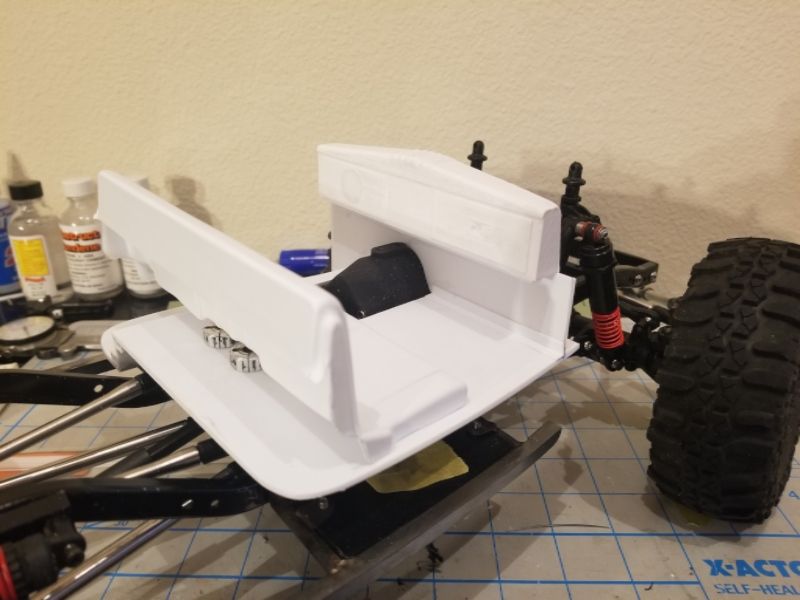

More interior, cut up a Dinky Honcho interior. I'm digging on the bench seat.
